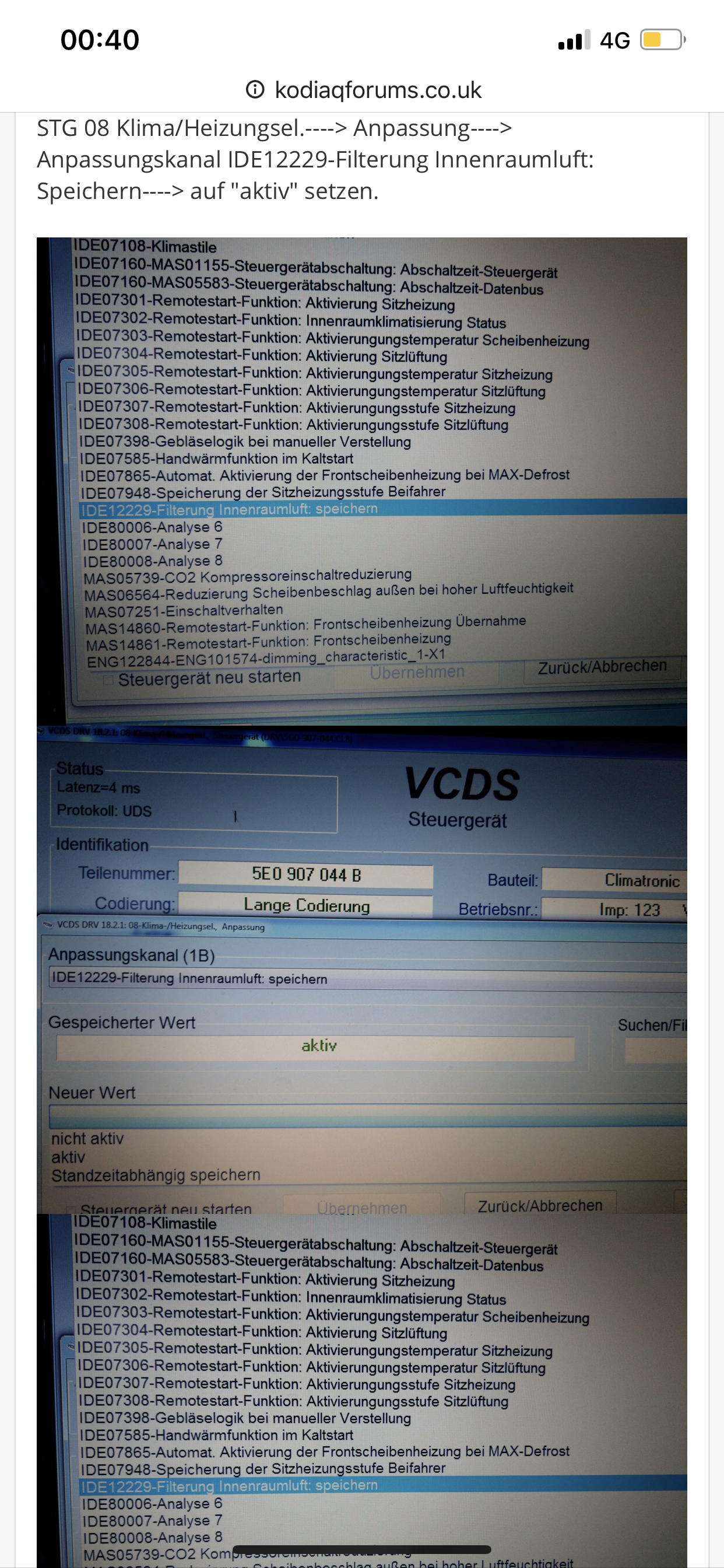

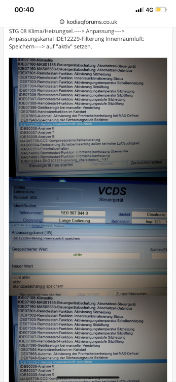

If anyone is still looking to know how to permanently enable AirCare the coding is below
  • 4 years later...
Thanks now always works.
