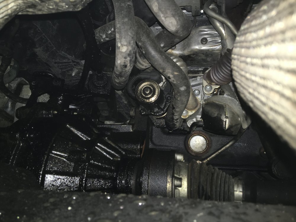

Cleared all ok, last night i serviced car and when looked under try saw the following, not 100% what is what or where the oil is from but not been losing oil.

what part is that in the center that looks to be dirty or leaking???
It's free to give the EGR a clean, if you're able I'd take it off and give it a good going over - it's usually not too difficult for DIY, have a google and you can probably find a guide.
I'm not familiar with the 1.6TDI so I'm not sure where the oil is coming from - looks like the top of a gearbox in that picture? Perhaps give it a good clean and check it regularly, might make it easier to locate where it's coming from.

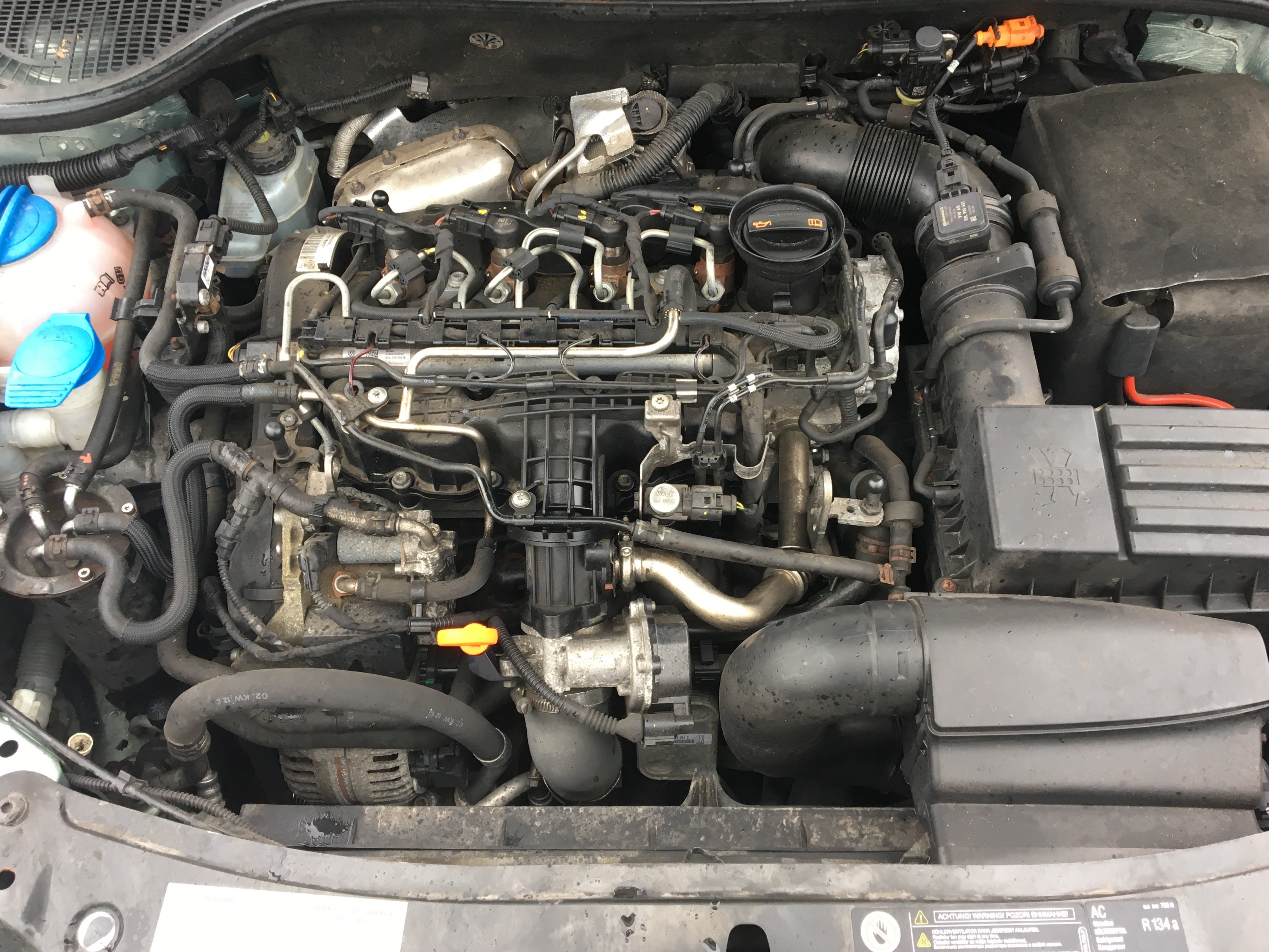

this is my engine bay.
can anyone point out the EGR please, lots of different results on google.
The EGR Valve on the 1.6 TDi's from VW are a known weak point. They are a pig to get at as they are buried deep at the back of the engine and need the drive shaft and sometimes exhaust to be dropped.
Book price from a dealer is around £700 as it is a 5-6 hour job!! Got any good independents near by?
Good luck!
any links for guides to do it yourself would be amazing
i have a friend with a garage and ramps.
