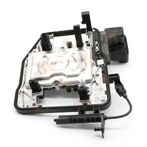

New Mechatronic
TCU card
TCU2 card

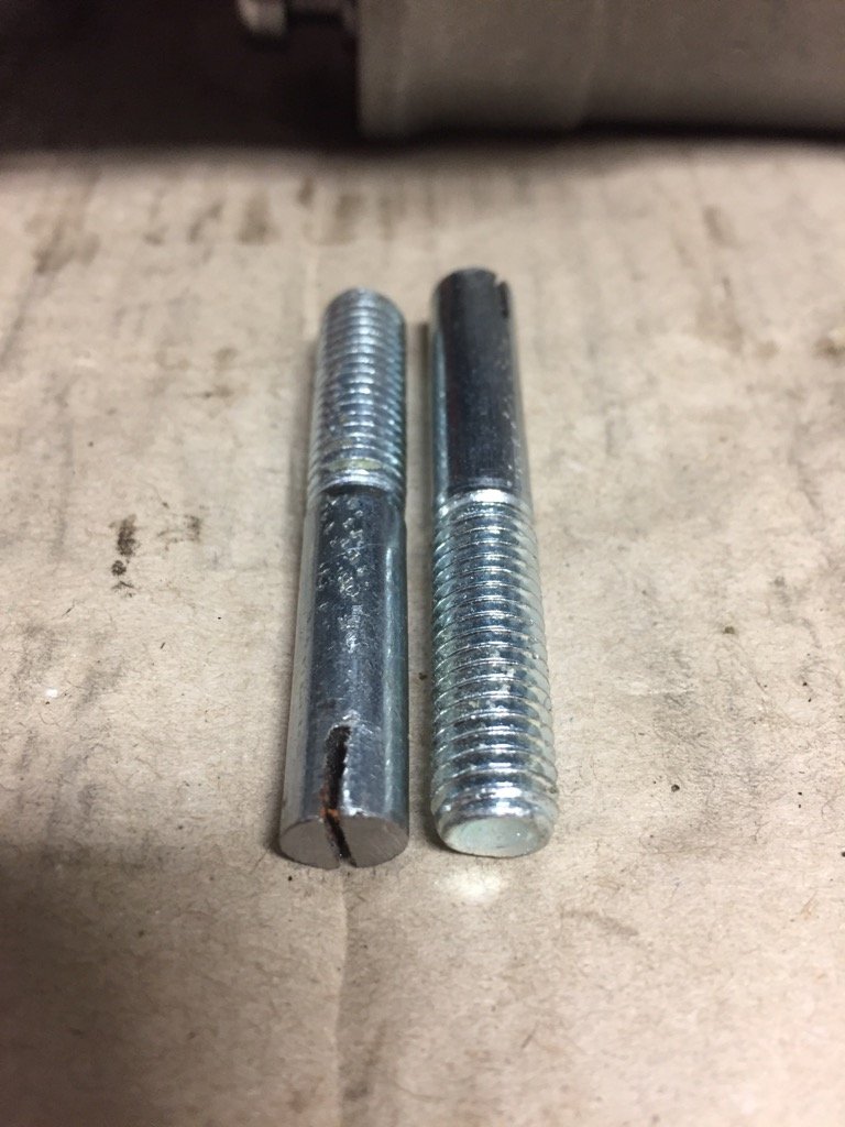

Homemade Guide pin -T10406-

Rosstech probably assume the new part has the correct hardware and software already installed.
If you're using a used part, this might not be the case so you may need to have the correct software/parameters loaded.
Thanks, you are right, i talked to the Skoda dealer and they says they can program the card for me, they need the VIN so i  think its OK.
I also wonder if I just can transfer the TCU card from the old mecatronic to the new since the problem is mechanical probably in the actuator. It reads only 30bar and it should be 50-60bar pressure.
If the hardware part number and revision is an exact match, I imagine it would be OK. Not sure if the normal adaptions/basic settings will be enough to learn any differences between the old and new mecatronic units.
I'm not a DSG expert so it might be worth calling one to check before risking the new parts.
