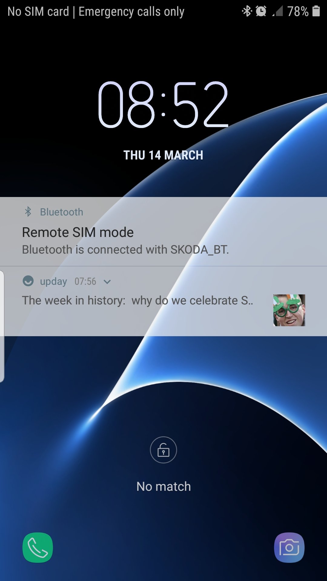

Having just taken delivery of a stunning 12 plate Superb I am left a little downbeat. Every time my phone connects to the car via bluetooth i lose all connections to my phone. My phone tells me i have removed the SIM card and a text message is received telling me i have to update my settings. Does anybody know how to get my Samsung S7 to work as vodafone don't!
Looks like you have something in you Bluetooth settings to do something with the sim. Try checking in there and also checking in connection settings that you don't have Bluetooth hotspot turned on.
Looks like you have the rSAP only Bluetooth module?
Plenty of threads on this, top of  superb 2 forum as a start
See if you have the option on maxidot to connect with Hands Free Protocol
Edited by olduns
Wrong forum
Thanks for reply.
Just spent three hours trying to figure it out, it's simple!!!
Deny access to SIM in Bluetooth settings. Rsap or HFP it's easy when you know how ☺☺
