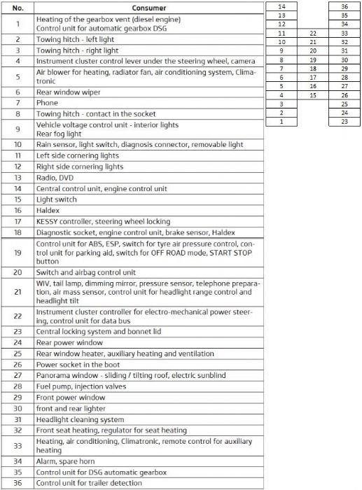

Could somebody tell me which is fuse 6 rear wash wipe and what colour fuse it for hardwire dash cam if any pics would be great
Location of fuses, the manual shows them upside down.
What colour fuse ais it
What colour is the fuse in yours in position 6?
Looks like it should be blue 15a

Thank you so much it is a blue 15amp fuse just done it and working great thank you

 Did you try fuse 6, it's ignition controlled.

Urrell is right you do need to wire it to an ignition controlled fuse otherwise there will be a continuous drain on the battery and camera will keep on recording 24/7!
You need to wire it to the rear wiper fuse - 6. A quick search on Briskoda and the "other" Yeti forum will provide exact instructions and fuse box drawings to make it easy.
Fuse 6 rear wiper blue 15 amp left hand side from the bottom
