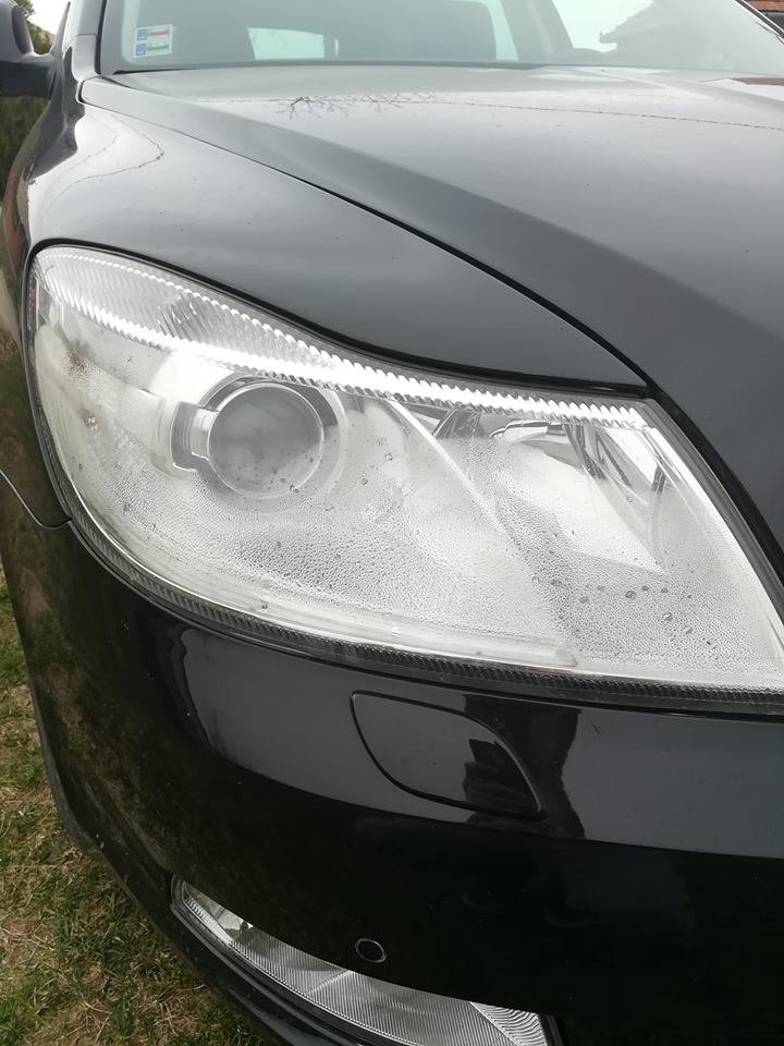

In cold weather, my right headlight fogs up. Always only the right one. I already took it out, went thru the seal with silicone, put some silica pads inside, but does not help.
And ofc it wont dry out till i take it out, and dry with hair drier. What else can i do to fix the fogging?

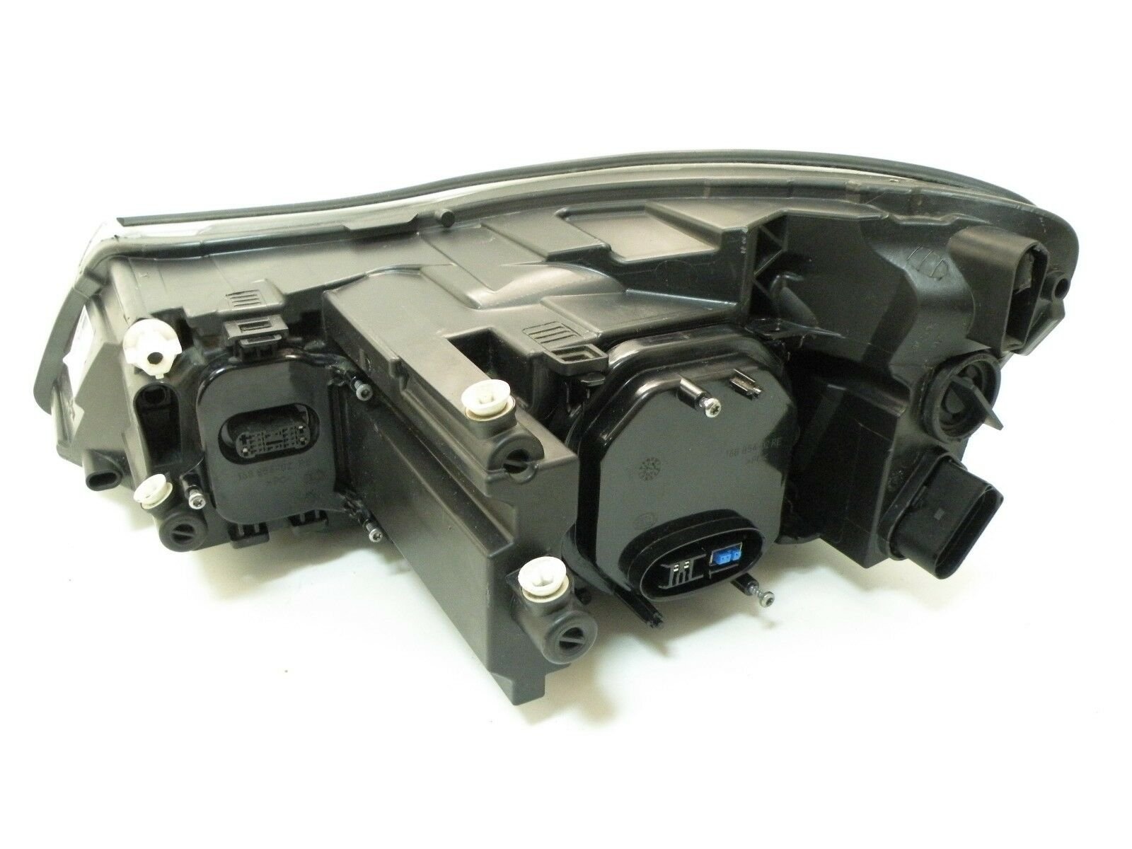

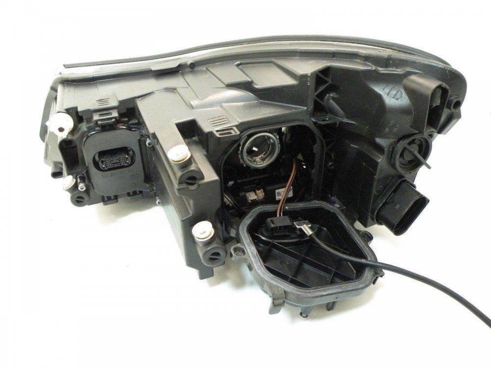

Are the clamps and rubber gaskets forming a decent seal around the ballast and base of the bulb?
I'm assuming there is no obvious accident damage, no cracks on the lens, broken mounting brackets etc.?
Is the breather / vent tube clear?
What about the rubber cap behind the indicator bulb access, is this in place and tight? The plug for the W5W side light bulb, is that secure?

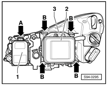

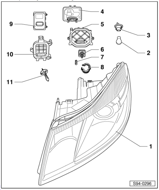

1 - Headlight housing
2 - Light bulb for the turn signal light (Light bulb PY21W, 12V, 21W)
3 - Lamp socket for the turn signal light
4 - Control unit for gas discharge lamp (J344 right or J343 left)
5 - Cover
6 - Discharge lamp with integrated high voltage ignition unit (type D1S, 35W)
7 - Light bulb for the parking light (light bulb W5W / W5W BLUE, 12V, 5W)
* Vehicles vRS as of CW 22.09 - light bulb not operational, parking light in individual multi functional lamp with LED diodes via fog light
8 - Holder for discharge lamp
9 - Performance module for the headlight (J668 right or J667 left)
10 - Cover
11 - Light bulb for main beam (light bulb H1, 12V, 55W)

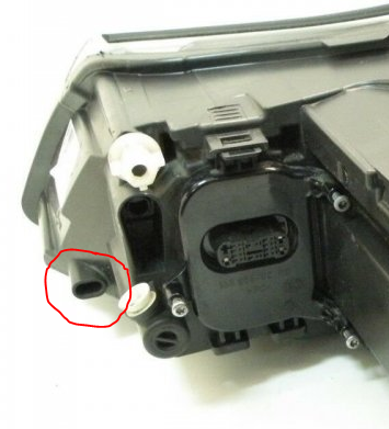

It's hard to tell for sure, but this could be the vent...

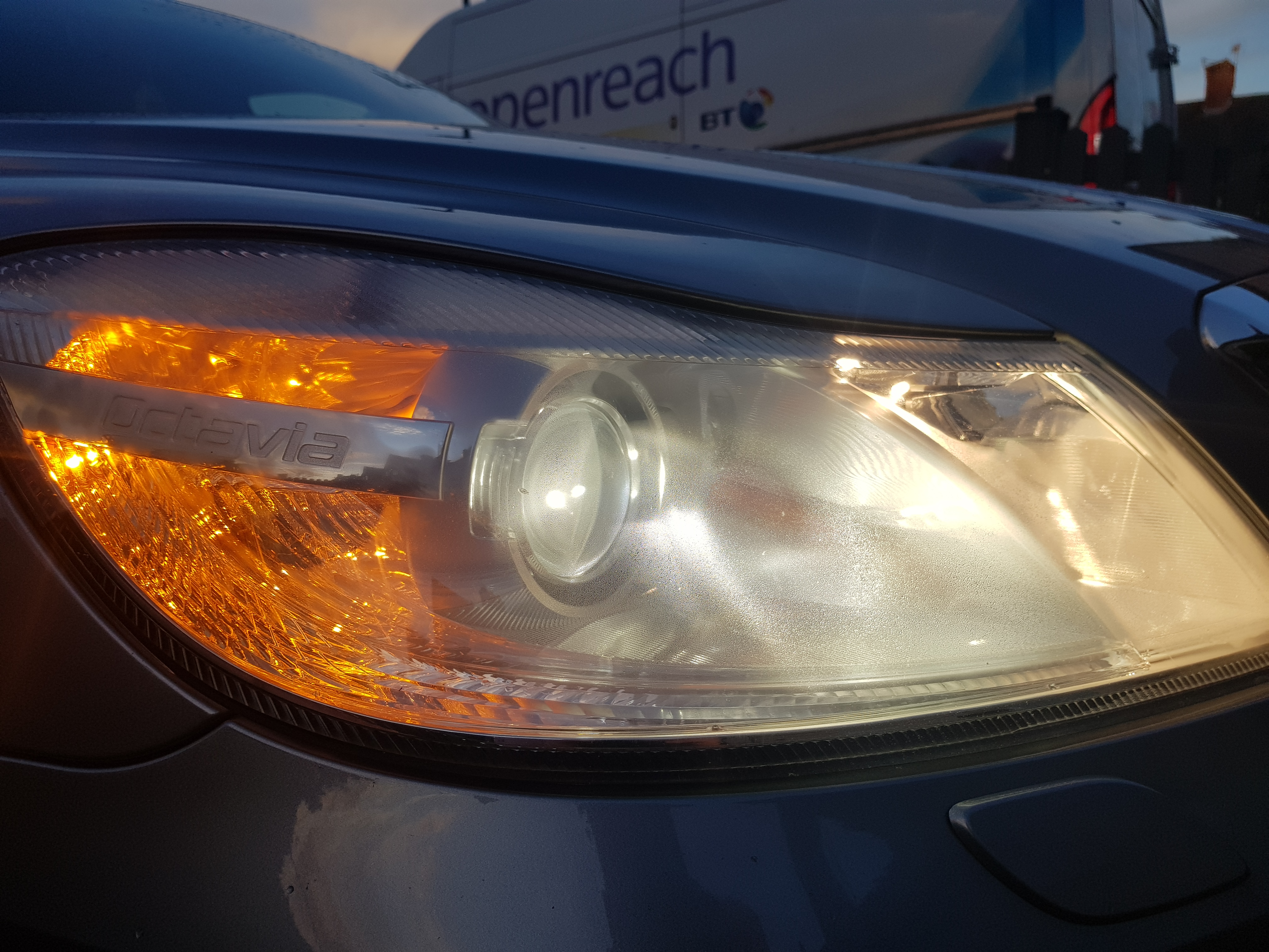

I've had nothing but trouble with teh same headlight on my car lots of water in it. I tried silicon gel and resealing it nothing works. It's the drivers 1 same as you. I've ended up getting a pair cheap as chips ( I dropped on really) it's stayed clear just after her washing staying away from the light still it listed up FFS.

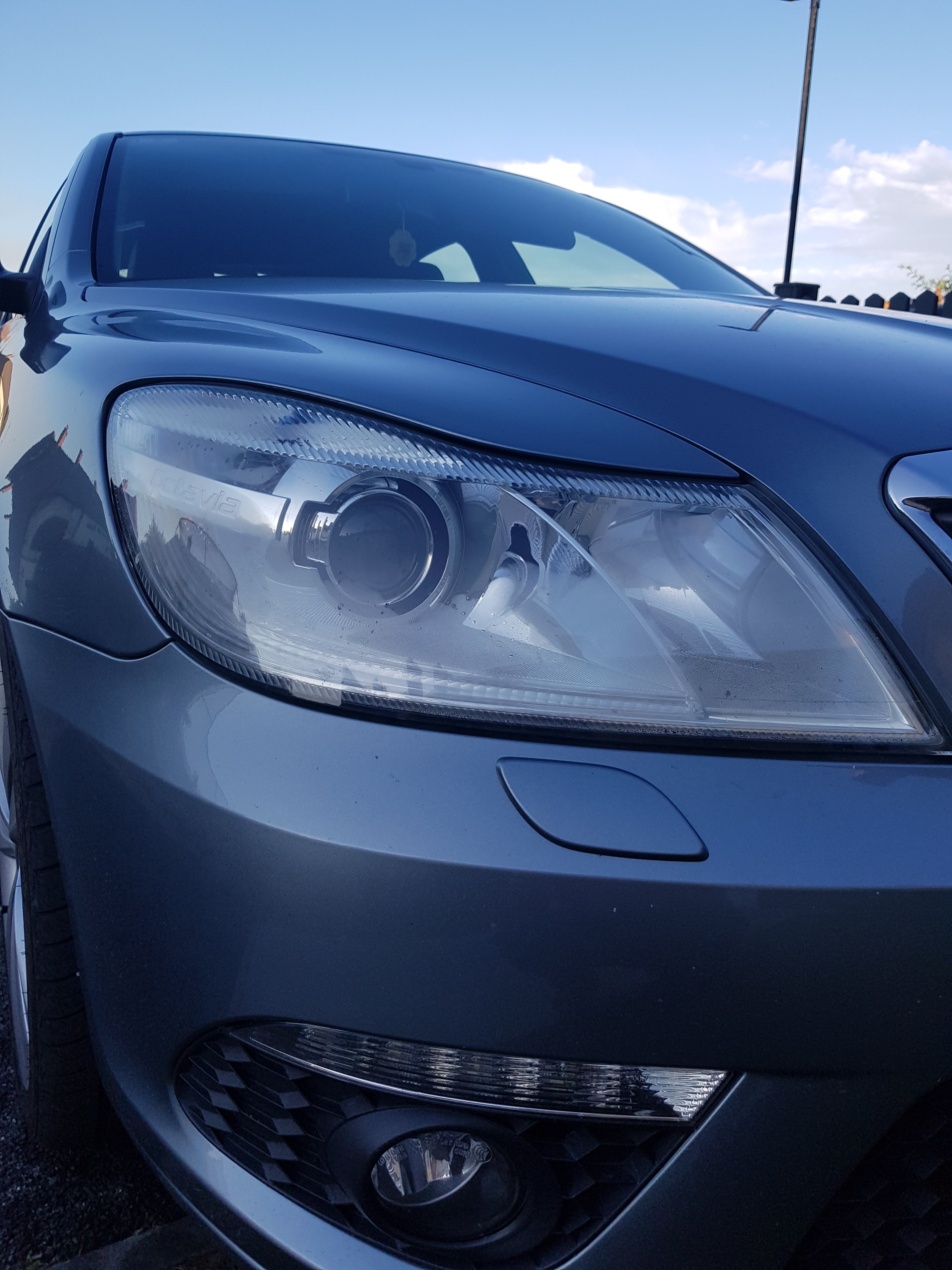

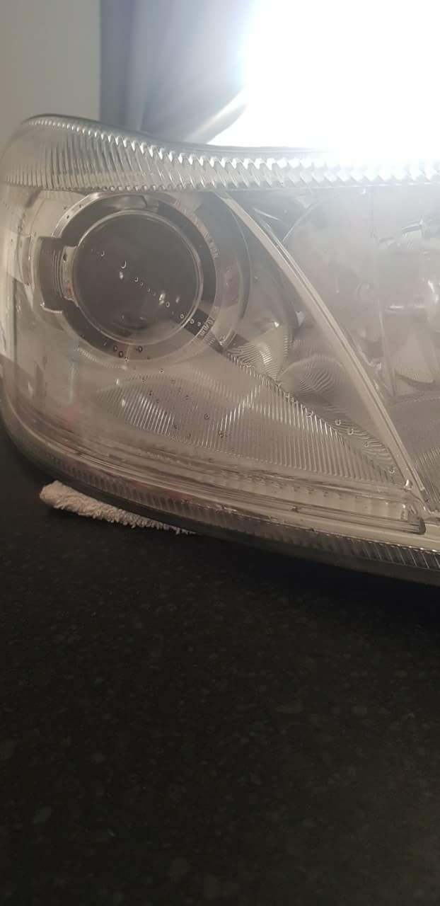

It looks lovely and clear in your photo about the base adjustment. Or are they the new (cheap as chips) ones, before you washed it?
New 1 before I washed it this is old picture20180425_200250.thumb.jpg.bbde47dac36f87a094e8631ca9c4c225.jpgFB_IMG_1525970014272.thumb.jpg.5e5b9cd90feae3a280113f195b08c23d.jpg20180426_183225.thumb.jpg.88d351bf6601999d65a4e830cbb2401a.jpg
