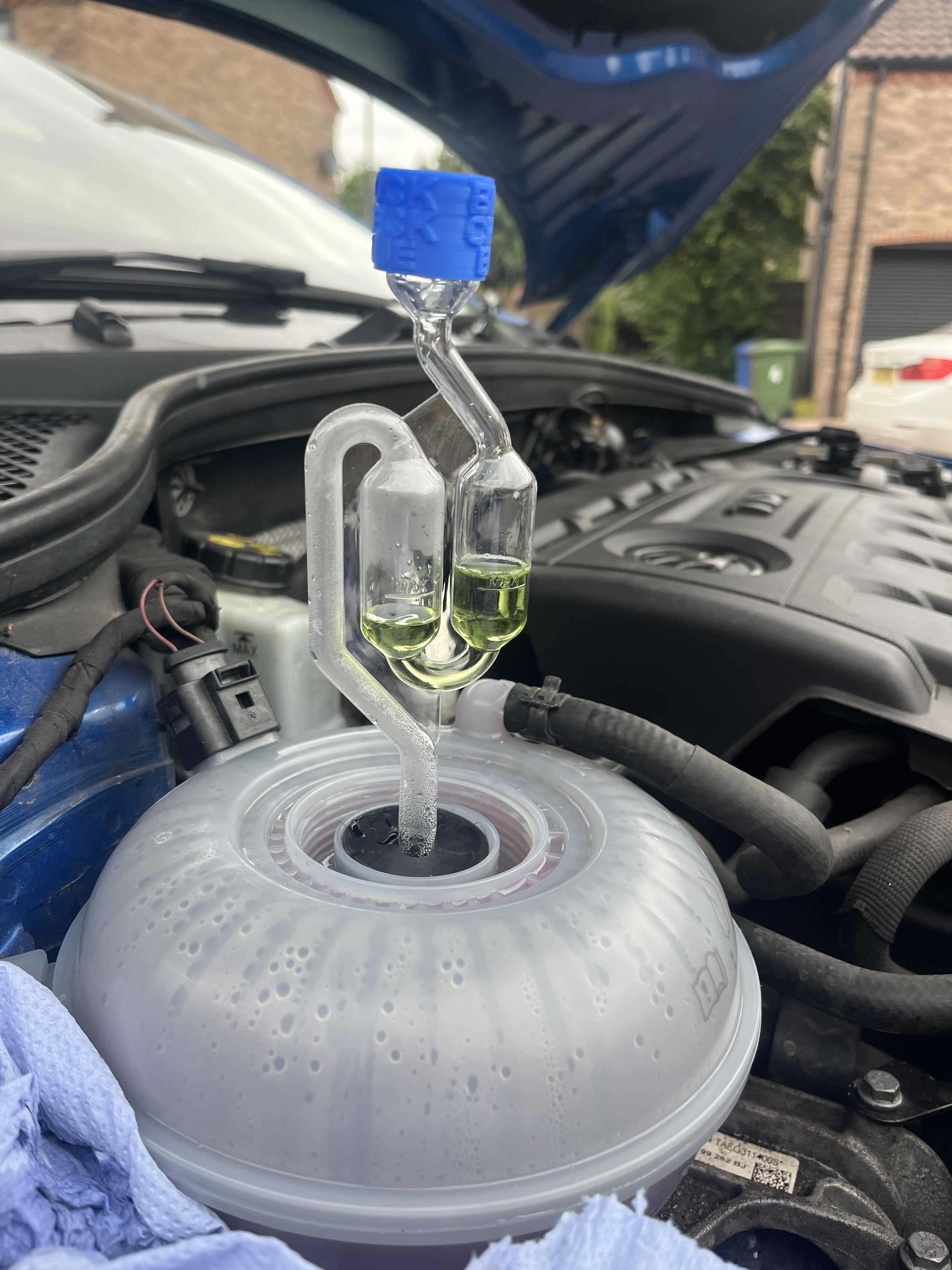

- 2014 Skoda Octavia Mk3 2.0 TDI – Coolant Loss / Possible EGR Cooler and/or Head Gasket
I had a very similar issue on my mk3 VRs tdi, I have a whole thread on the diag and fix. I’d guess both EGR cooler and HG have failed you can test the former by buying a bypass kit of the cooler this does what it suggests and bypasses the coolant from entering the cooler. If the coolant still sropa you know it’s likely a HG issue. You can also do a sniff test on the coolant and see if you have combustion gasses in the coolant, although that could be from the cooler or the HG so all it confirms at that point is a failure. In terms of fix, id started with a cooler (I have a pretty much new Mahle one I can sell, was on my car for about 2 months). You can also pressure test the cooler once it’s off the car. My issue was a combination of cooler and HG, the latter becoming much more obvious after replacing the cooler as I think pressure was escaping from the cooler and when it couldn’t do that it escaped from my expansion tank. HG job is pretty involved, you’ll need to get the head pressure tested as well just to be sure it’s not cracked and then about £900 worth of seals and gaskets etc. it’s a good 10 to 14 hrs of work so if you’re not going it yourself it’ll be over £2k for a HG job alone, but there’s other items worth doing while you’re in there.
