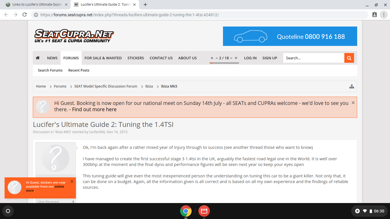

Maybe look up at the pinned thread on the links to Lucifers Ultimate guide, then look at the link to Part 2.

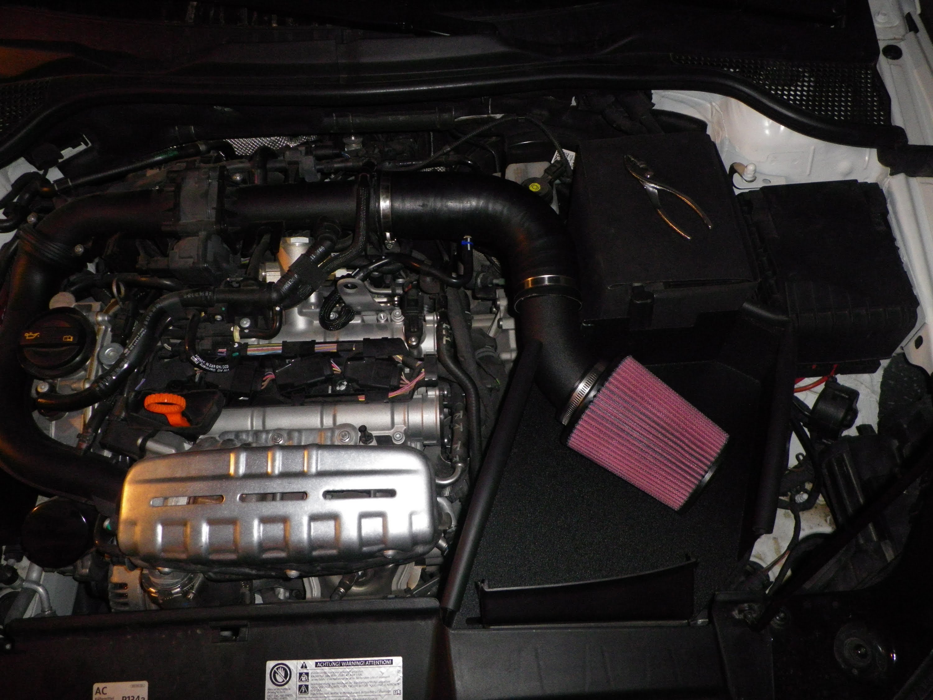

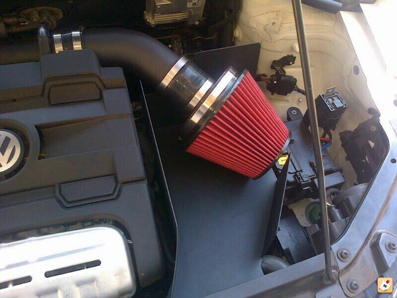

Another question, he told me (after i explained what i wanted i.e better flow & pops + bangs) to remove the cat completely. Now im abit scared of doing this, A its not lawful and B its a permanent job so once its done it cant be undone. To do this or not to do this?
also, k&n airfilter has been reputable and he said to get one. He explained that the paper filter is restricted but the k&n filter is cotton allowing better airflow. Carwow guy, Matt dyno’d his 2001 porsche i think, and it made around 270 bhp but when he stuck a k&n air filter and dyno’d it the car LOST power!? So again to this or not?

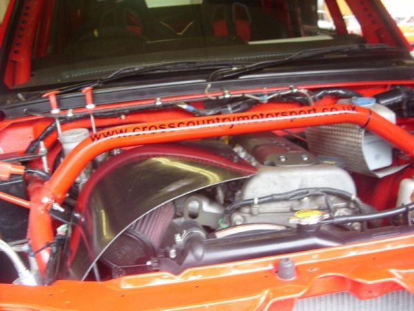

Nothing special with a K&N filter, the paper one is not restrictive.
I use K&N for offroaders, great where H20 will be a problem, or dust etc, Open engine bay type things.
Dirty K&N's stangle engines and poorly treated ones are rubbish.
Plenty choices in intakes. Pipercross or Green Cotton Performance filters have been popular.
The Polo GTI battery is in the boot, maybe move yours and get  good filter on and cold air intake.
Ask which actual age of 1.4 TSI Polo GTI's he has done, again a few different ECU's were used, but all can be unlocked.
If you keep doing research you will see it has all been done on VW, Audi, SEAT & Skoda twinchargers and plenty have experience,
if your guy is good then great.
http://briskoda.net/forums/topic/437031-vrs-intake-and-bits-in-the-uk-for-australians
You will see the K&N cone filters in the link.
Used like this they are good when kept clean and with air flowing.
