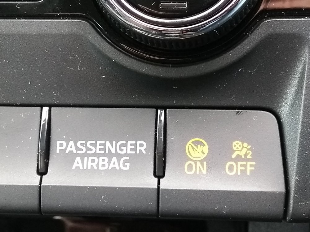

Shortly after collection, I realised that the front passenger airbag was deactivated by the key switch. No problem there, followed instructions in manual and duly activated the airbag.
Went to start the car this morning and noticed the following warnings lit...
The one marked 'ON' , I can understand (passenger airbag activated), however the one marked 'OFF', which is only illuminated for a few seconds has got me baffled. Cannot find anything online or in the manual and cannot confirm if this has always been lit when switching on the ignition?

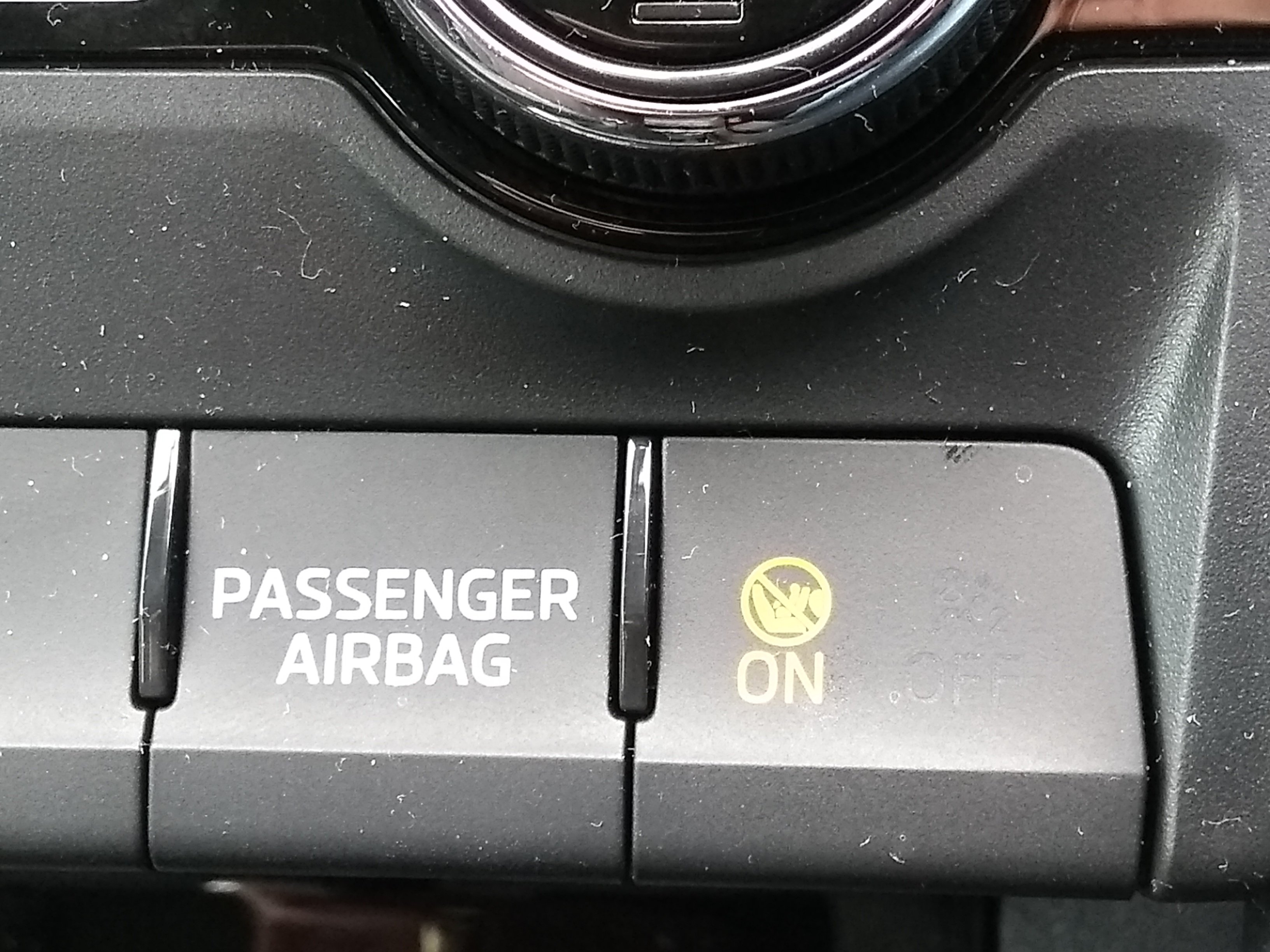

In the attached images, one shows both lights illuminated when switching on the ignition, the second a few seconds later when the OFF light extinguishes
Any help or advice gladly appreciated
Curious that, ours too was 'disabled' on delivery and the light confused me also.
However, the situation you have now looks to be correct (or at least what I think to be correct on our vehicle) the switch thingy flashes for a while and then settles to 'ON'.

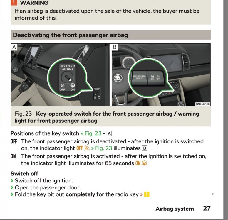

Edit: Page 27 in the book.

same here mine was switched off on delivery.both light up when ignition is switched on. then only on is lit up after a few seconds

Thanks for your replies, Berisford and Davey. I've had the car for almost a fortnight now and although I've been aware of the 'ON' light, I've never noticed the 'OFF' light before. It looks as if it is normal based on your replies. I just find it strange, that is no mention of the 'OFF' light in the manual...
From the manual...
13 minutes ago, Kenny R said:
From the manual...Yes, have seen this page Kenny, but no real understanding why the 'OFF' light illuminates, when the 'ON' light is showing...unless it's just a bulb test??
It is a bulb test - MOT check and all that.....
Thanks Berisford
