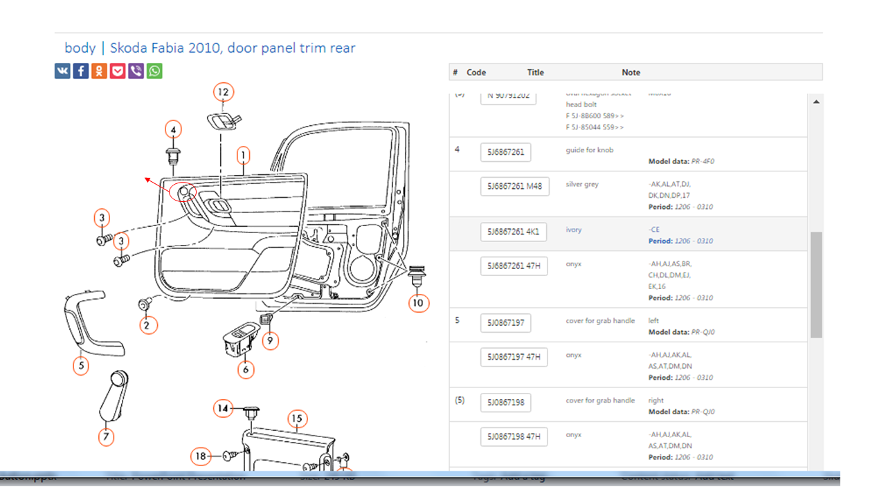

Diagram attached for reference i think i need this part no.4 (5j6867261) can not find anywhere....213999275_HeatedMirrorButton.thumb.png.282f9d44894b6f364765bb3c21cf49d0.png
this goes sooooo well with the youtube link @spartacus68 posted....will cherish both

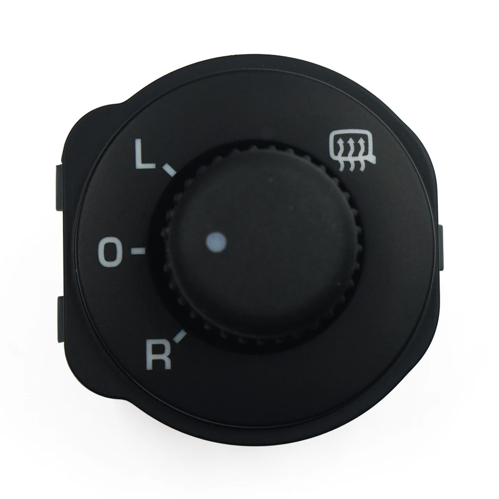

loads of left hand drive switches on ebay....and the only ones i can see under the 5J fabia designation are £90-100 made in germany
thought there might be some to suit my fabia facelift 5J 2008 model...cheaper...is it the electrical heating side of things which push the price up!!
this is the part no i have been googling with  SJ2959565
i think maybe the 6J part looks the same but seem to be all listed for lhd...and in $$
https://ae01.alicdn.com/kf/HTB1zEAxLFXXXXaRXXXXq6xXFXXXd.jpg
mine looks like this but is the other way round
