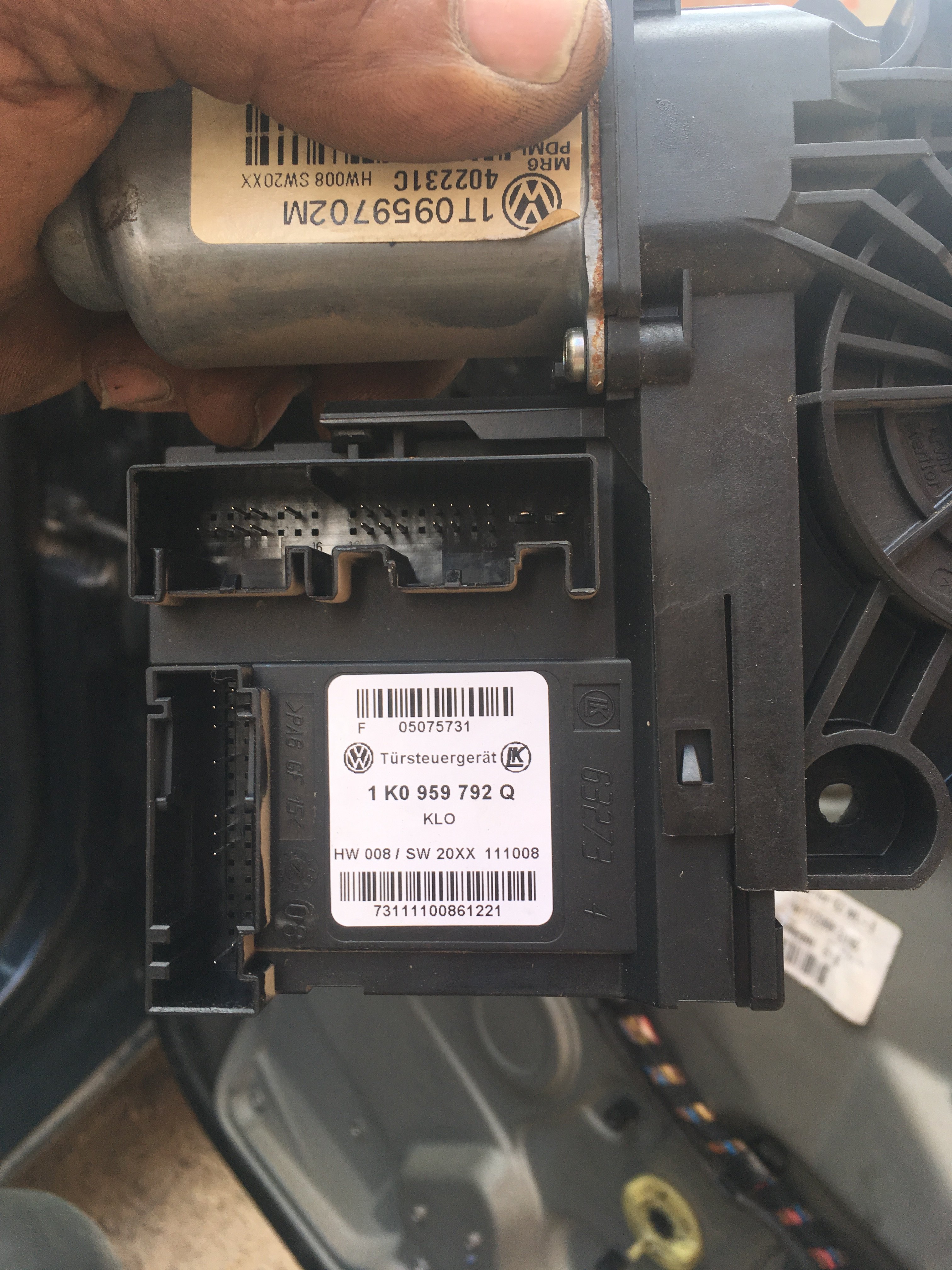

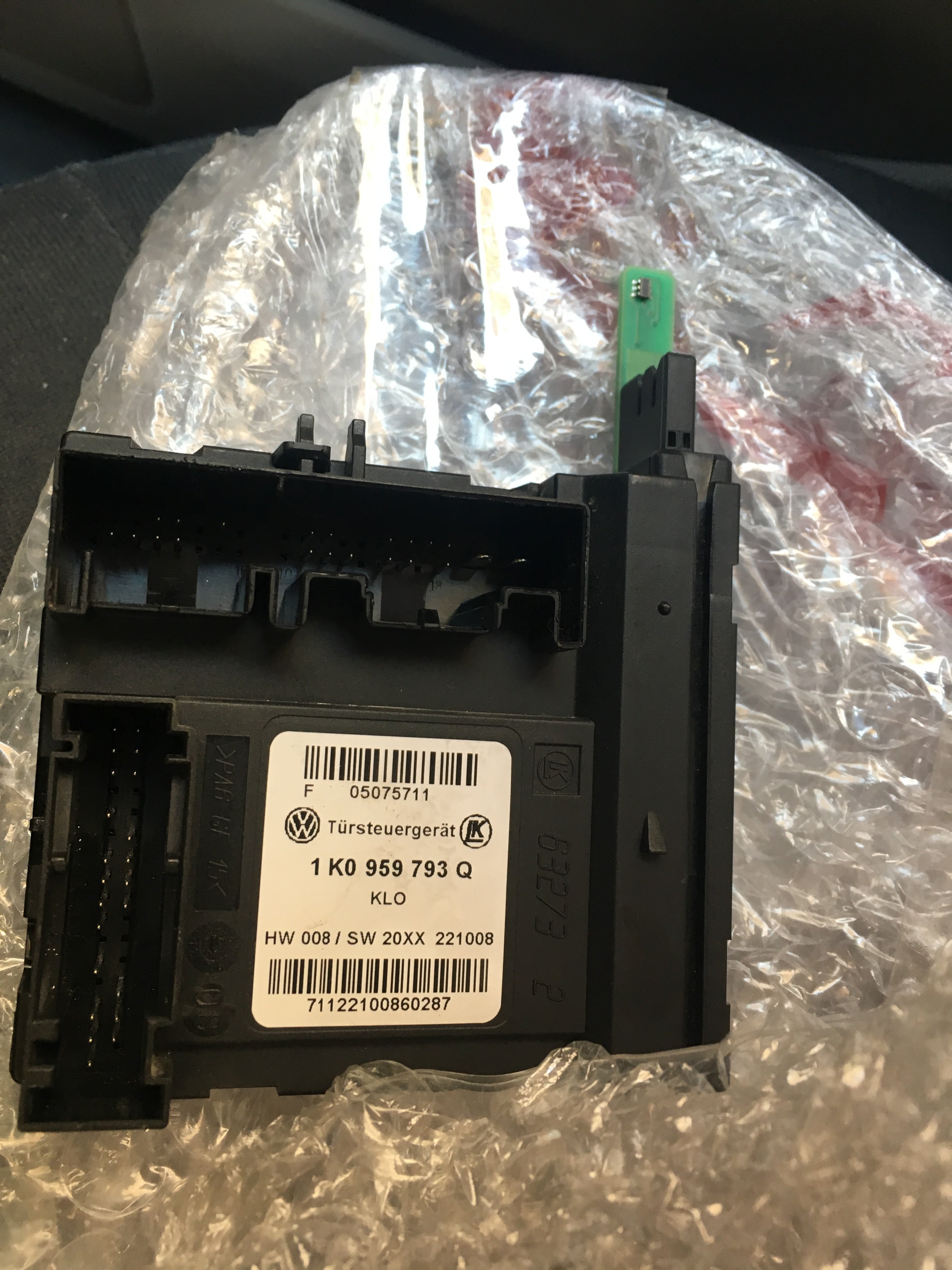

My car is LHD and doesn’t have folding mirrors, so I decided to install pair of folding mirrors.
I brought folding mirrors and folding control button from LHD car, then I brought the control + motor unit for both doors from RHD UK car. I installed the electric control+ motor as is then I got the functions of both doors reversed. So I programmed it through VCDS as LDH car and I got everything reverted back to its original position except the mirror motion itself ( still moving opposite directions). After one month, I lost folding option again and nothing is working now.
I placed the RHD control module into the LHD lift motor, but still nothing fixed.

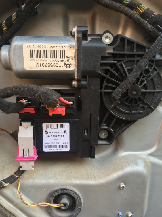

Attached is the RHD control module with LHD lift motor installed in my driver’s door.
Sorry for the long message. Thanks for being patient with me.
