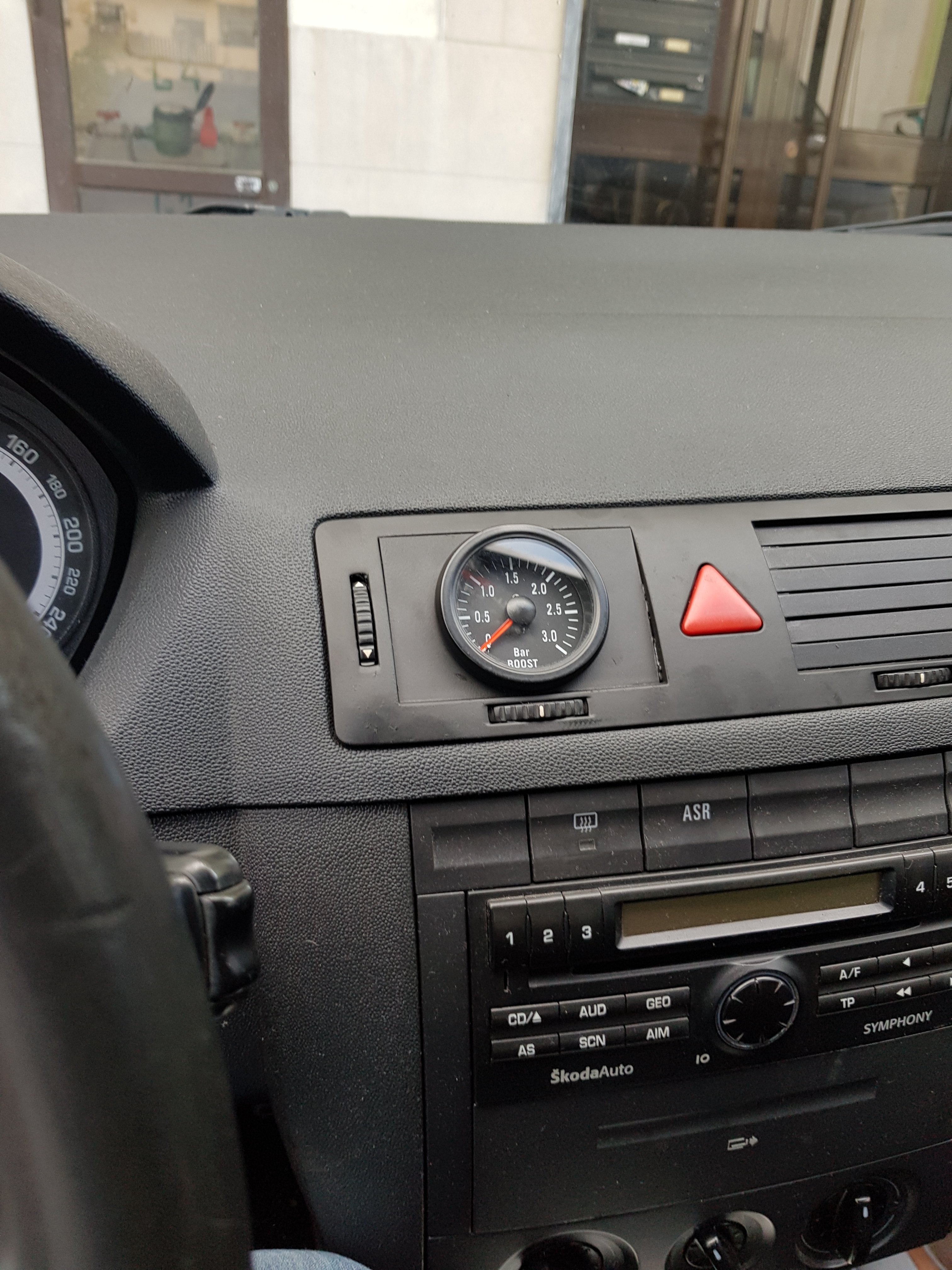

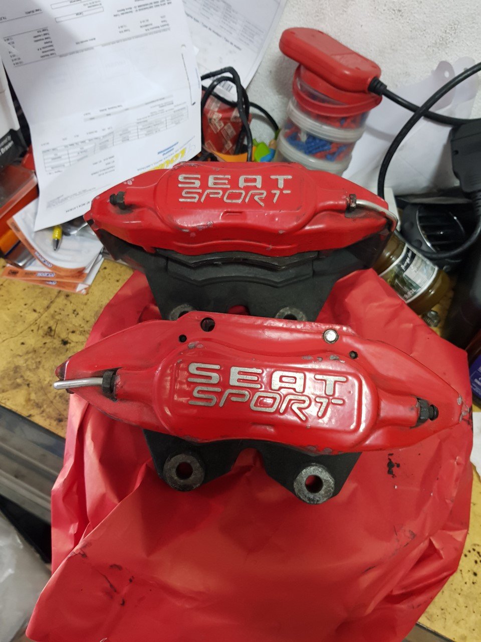

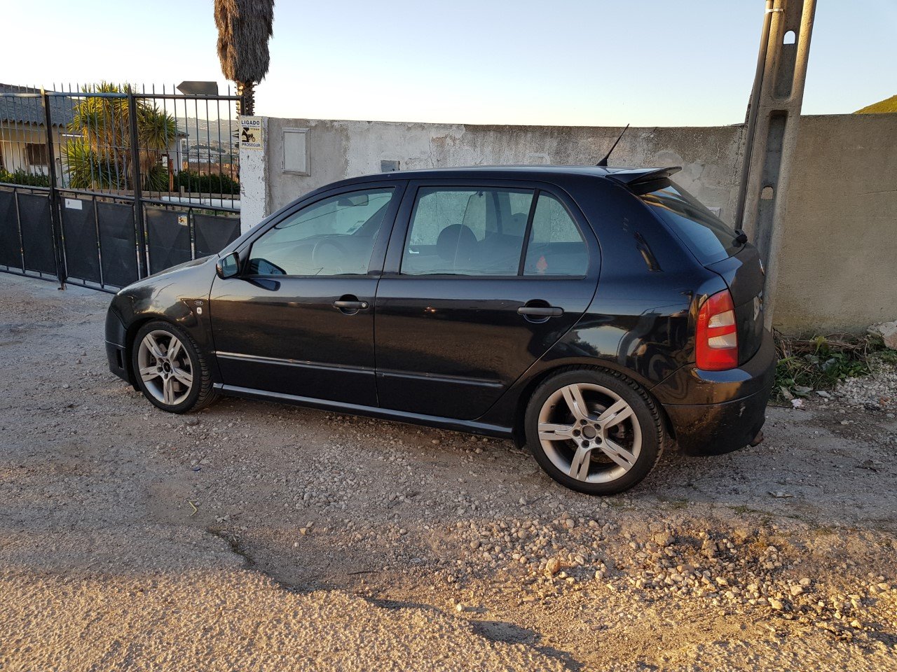

hello people, my name is francisco im from portugal i have a skoda fabia mk1(pd100) is my new project.
specs:
371cv (not full remaped)
swap pd130(asz)
gearbox (hds) 270km/h at 5000rpm
gt2260vk bmw (gt2265vk with gt23 exhaust)
cam dbilas
firad +120%
sachs race monomassa
vrs exterior
ibiza rims(16")
312mm brakes
coilovers
fmic xxl
exhaust complete 63.5mm direct
next:
ibiza cupra brakes (ap racing)
oz ultrallegera 16"
anti-roll bars kit
suspension to trackdays
paint all the car
radiators(oil and diesel)
setup the car for daily and track car
sorry for my english!
if you want more photos tell me

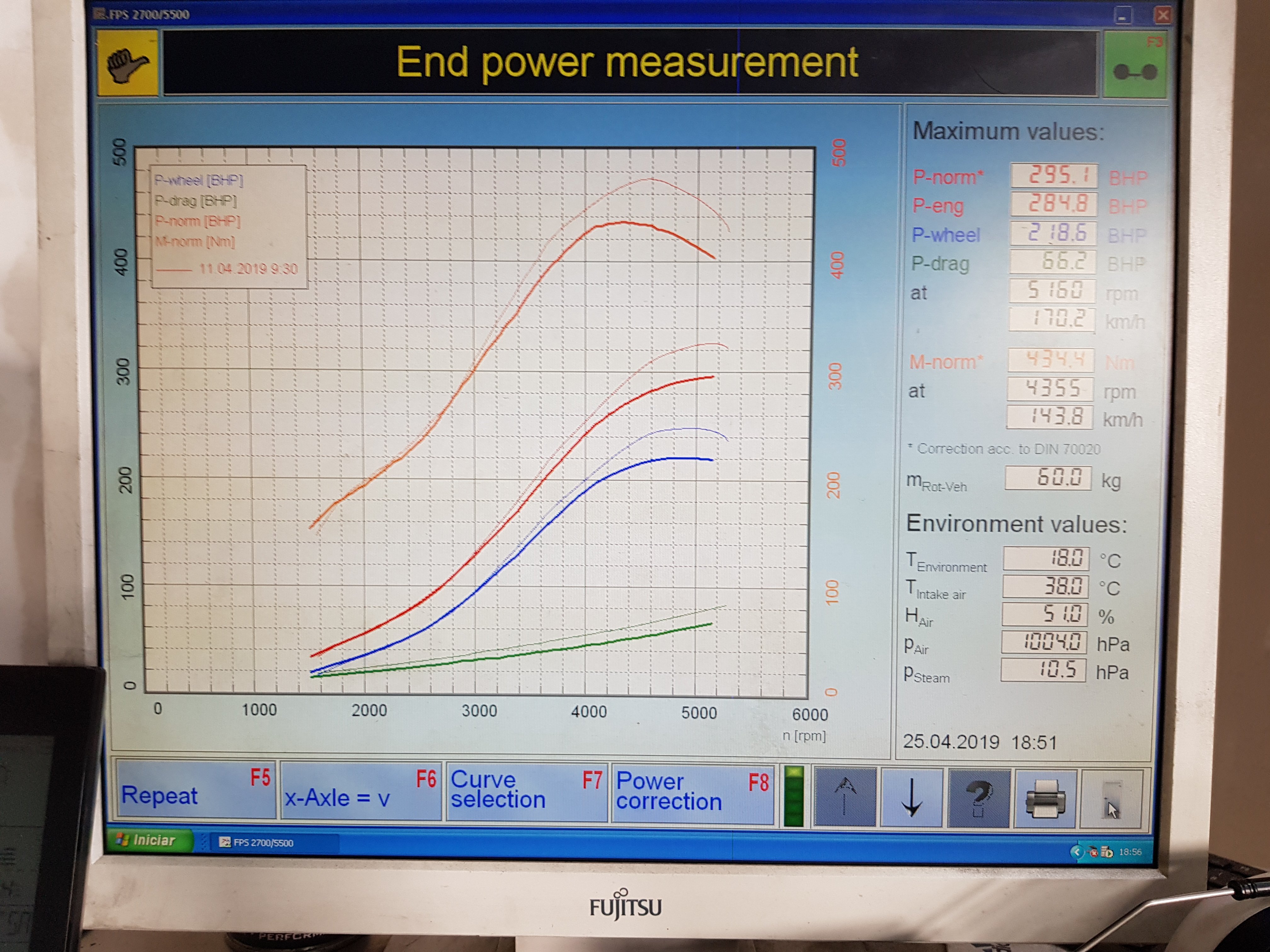

news!!!!
the turbo is a gt2052v with mfs 60 11blades and gt23 exhaust this setup make 300cv with new turbo gt2260vk( mfs 71mm) expect +380cv.
