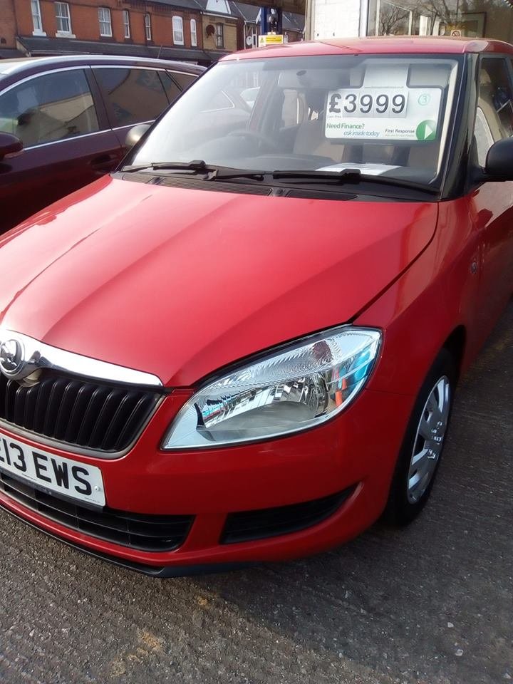

Not sure what mine are as bought car yesterday and collect it Friday and like a div forgot to check on wheel size
Only a basic model I think but better then my ford that is playing up
this is the one ive bought
