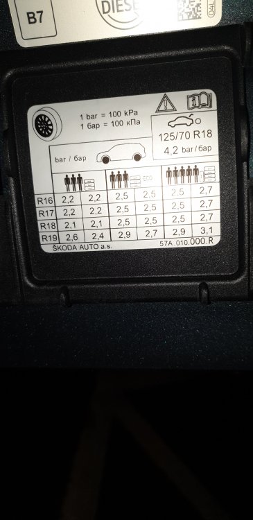

May i have some advice on how much tyre pressure (in psi) is optimal for best driving and economic experience? My tyres are r17 and i have attached the pic for what skoda says. However, since my car is not dsg , m not sure if i shd fill in as directed eco mode?
Also, should there be difference in tyre pressure between front and rear tyres?
How many passengers/luggage will be in the car? We have a manual SEL petrol and usually have 2.2bar front/back which gives good economy and a decent ride on standard 18" alloys.:thumbup:
Thanks   we are a small family of 3 with usually light boot, i do maintain 33psi, is that an okay tyre pressure on r17?

Should be fine with that we are only 2 but sometimes take 4 large 23kg suitcases (not dead bodies xman) in the boot on holiday with 31psi.:nod:
