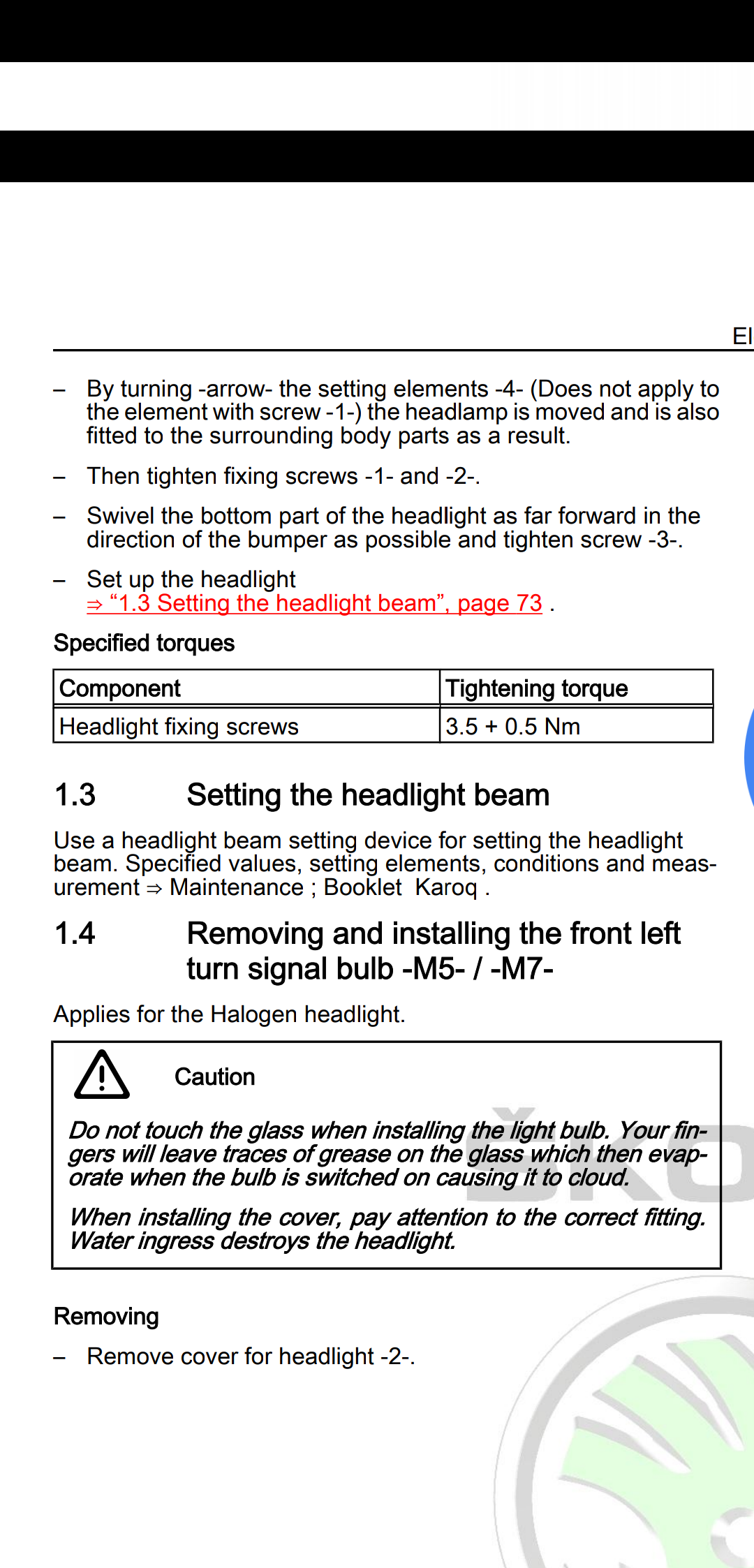

Adjust Headlight Beam for halogens
Does anyone knows what's the adjustment screw for the headlight beam??
There are two plastic screws that I believed that are the ones, I play with them but nothing changed no info on workshop manual either.
I changed the halogens with leds and I need adjustment
I guess below you can find the solution
See Section 6.12 -pages 116-120 - Inspecting headlight beam setting and adjusting if necessary - here:
