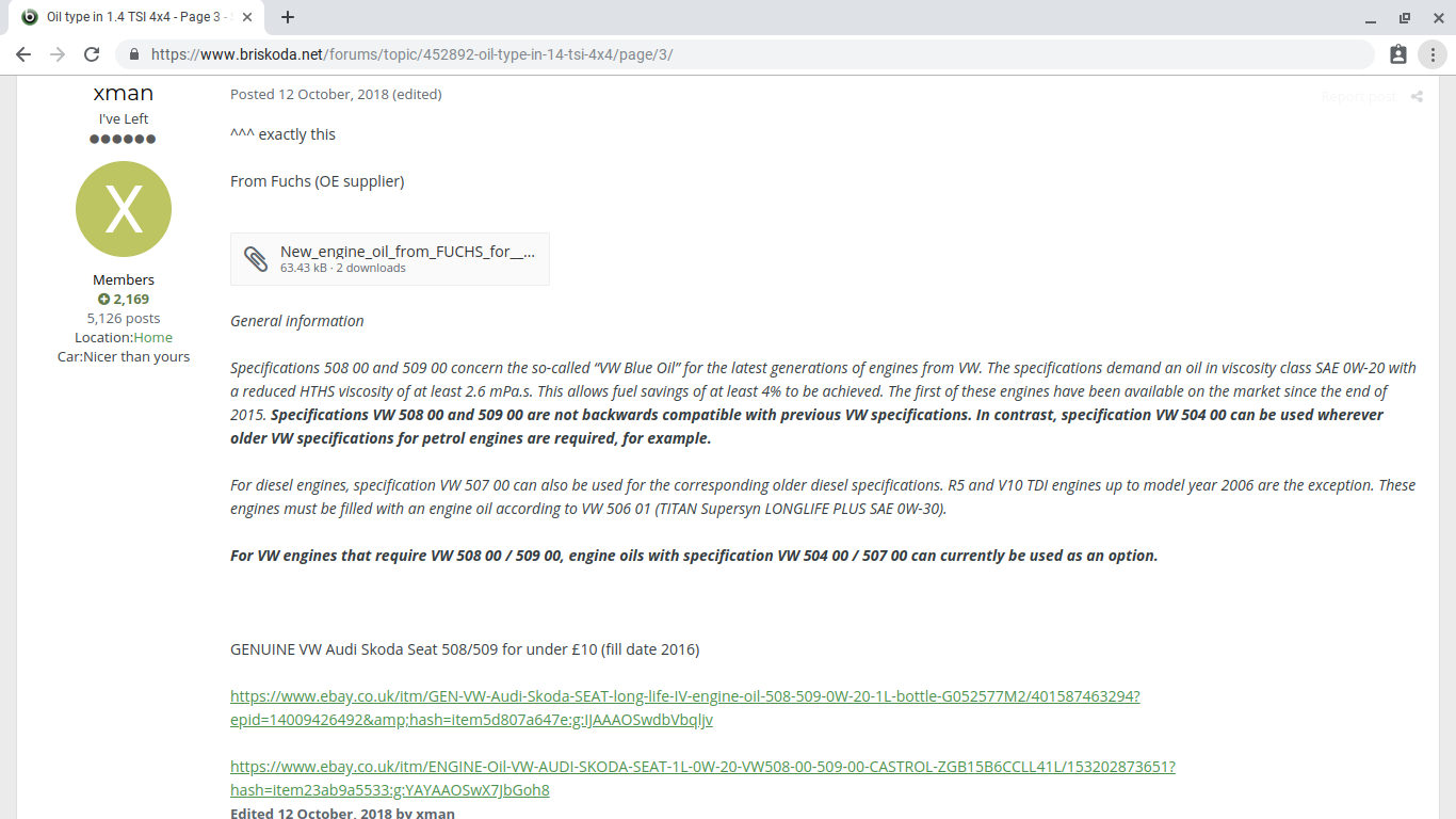

Edited by Skoffski
So, what oil are the factory putting in? I've got a bottle of 5w30 too, I bet at first service they use 5w30 as well?
For about 18 months the factory has been putting in 0w 20 FS IV just incase any random vehicles being imported to EU countries are retested on import and have to be able to replicate the WLTP Certification.
'The use of VW504 oil instead of VW508 can result in slight deterioration in the emissions values.

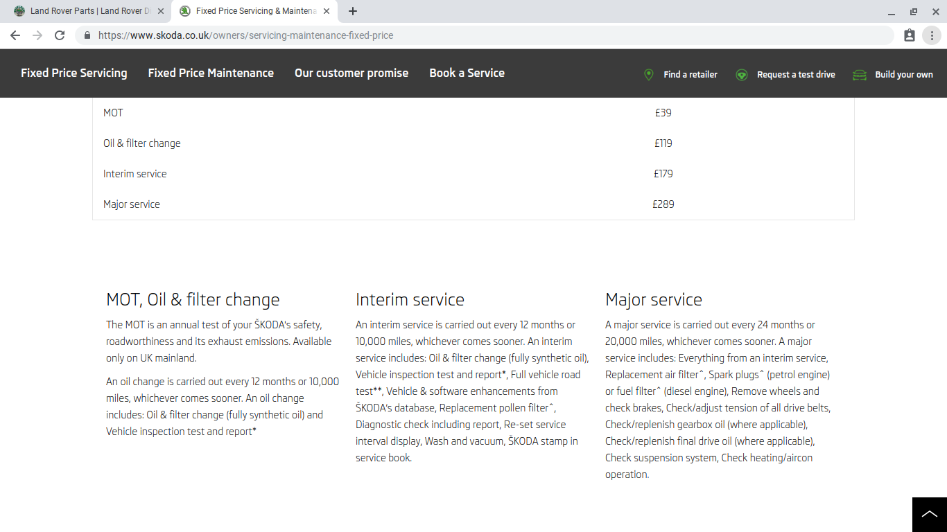

The Fixed Price Service prices on cars from 3-10 years will increase, already the Oil / Filter change has gone from £100 to £119.

It's not gone up because of the VW508 oil! I've contacted three separate dealers, all said they use VW504. So, despite Skoda saying use 508, your dealer won't listen! I'm happy with the 504 5w30, I don't care if using that increases emmisions and it won't cause engine damage. Just a shame the dealers don't appear to have been told.
You maybe missed me saying they will increase.   Who knows when, but it will happen.
The Fixed Price Servicing Offers were on 3-10 year old cars, and there are no TSI or TDI that VW Group started using 0w 30 FS IV oil in 3 years old yet.
