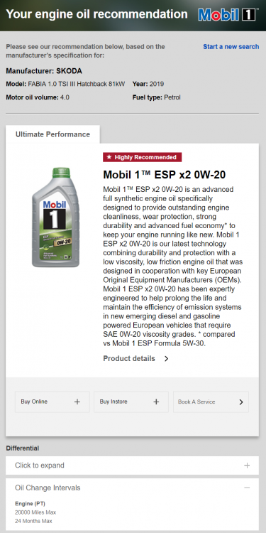

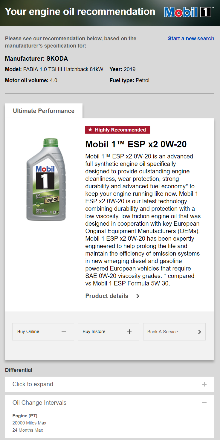

Mobil 1, is what I ordered, as a just in case top up.
I'll be using Mobil1's recommended (which oddly is 0W40 rated WV 502) after my extended warranty and service plan runs out. I can do two oil and filter changes for less than £100, so i may end up going for shorter oil changes too, i'll be keeping my car for quite some time so i want it to last! Looking about for options with transmission fluid too, after 10k miles or so with my new box i may flush it
