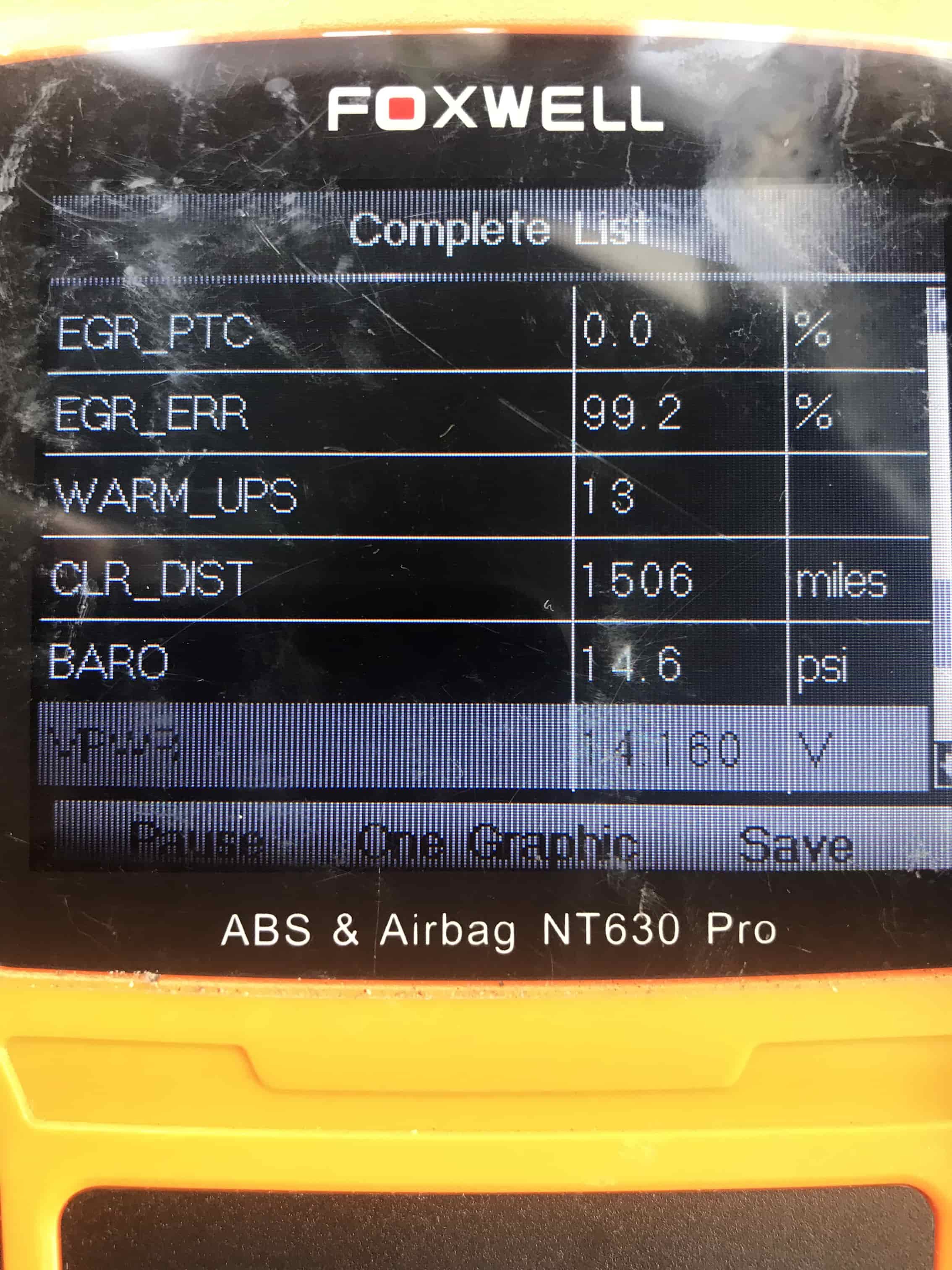

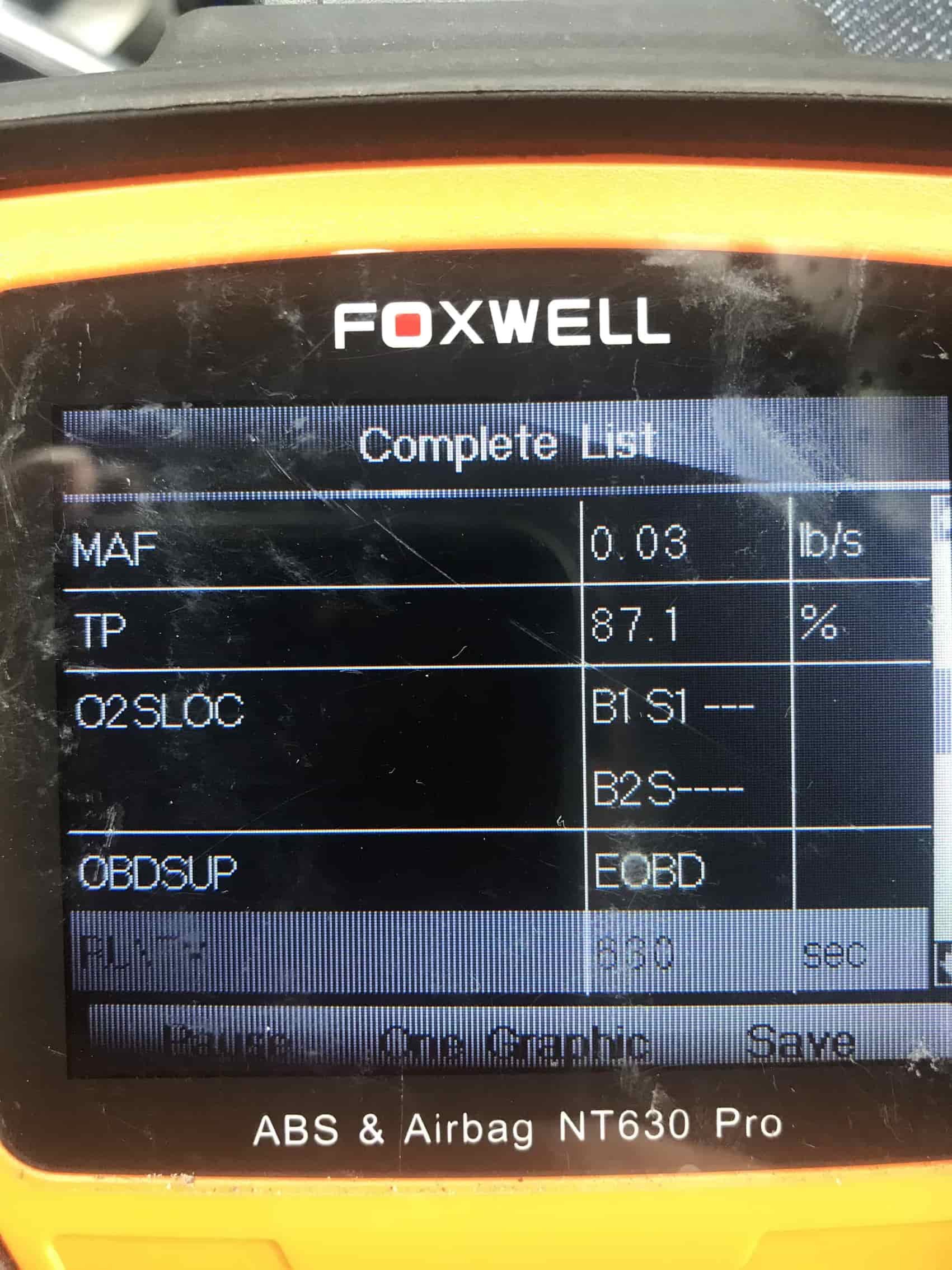

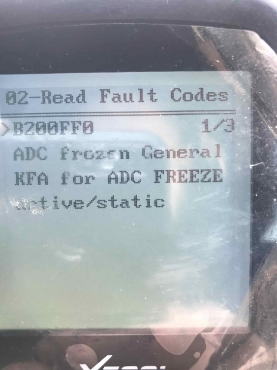

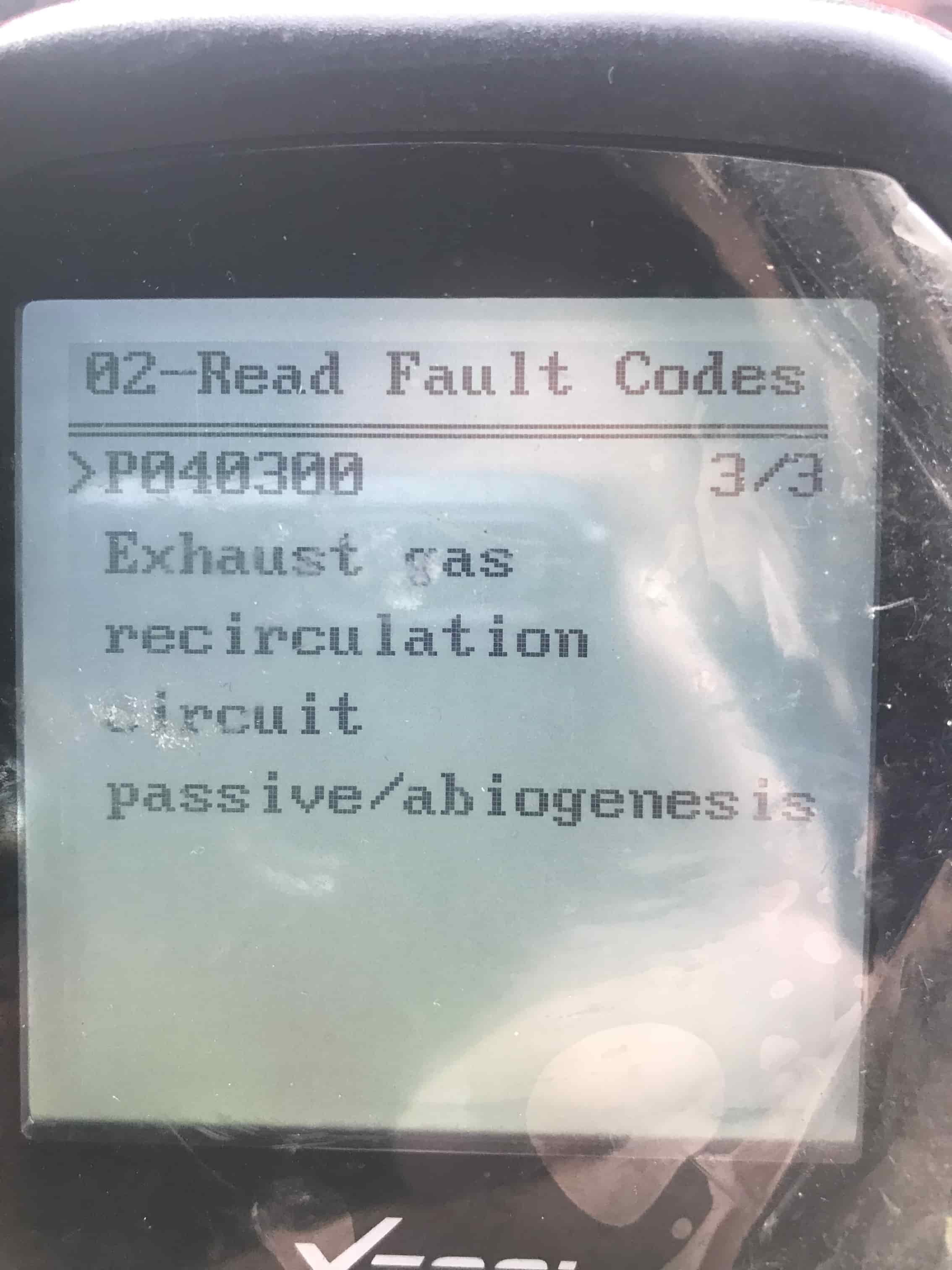

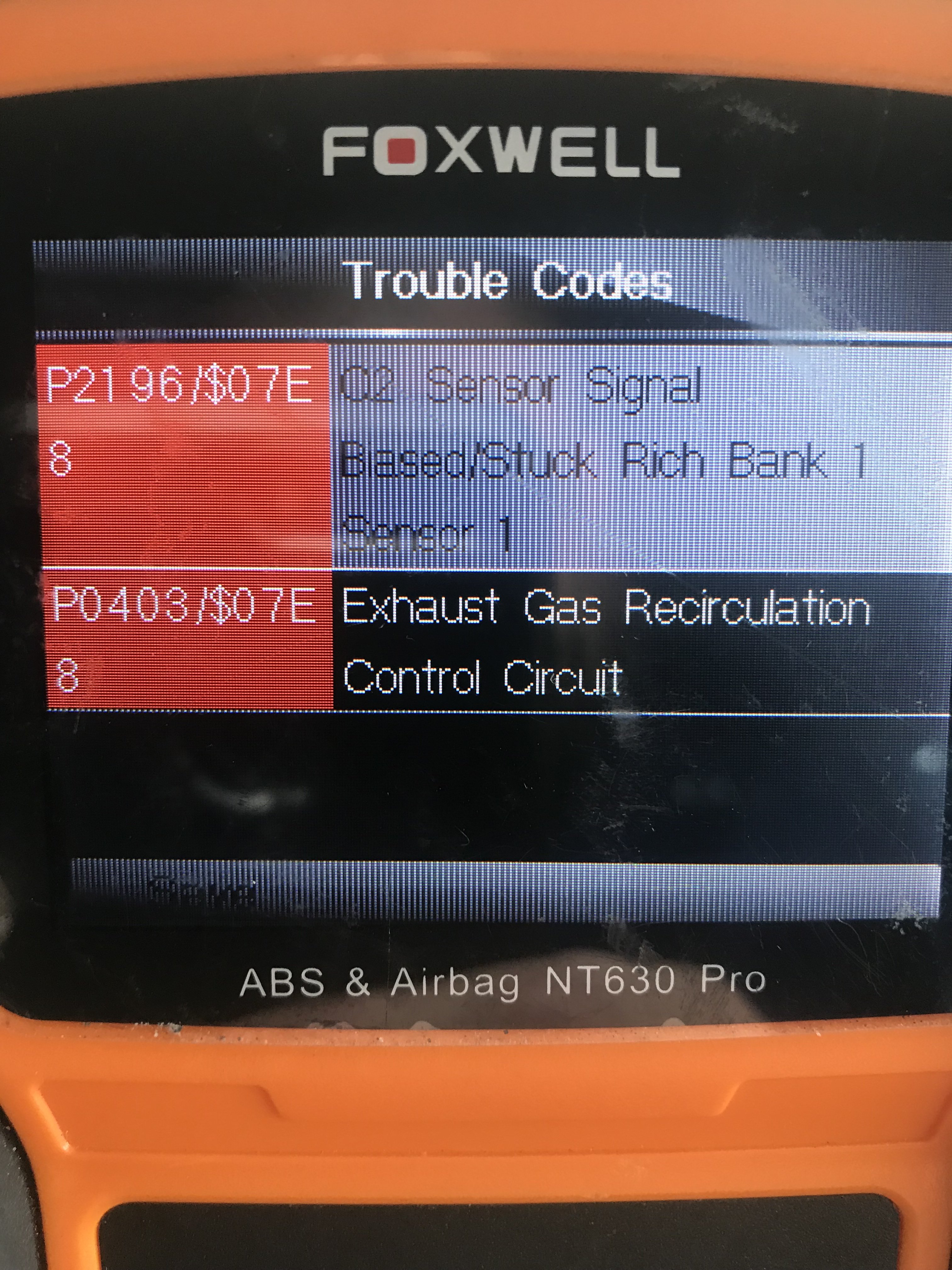

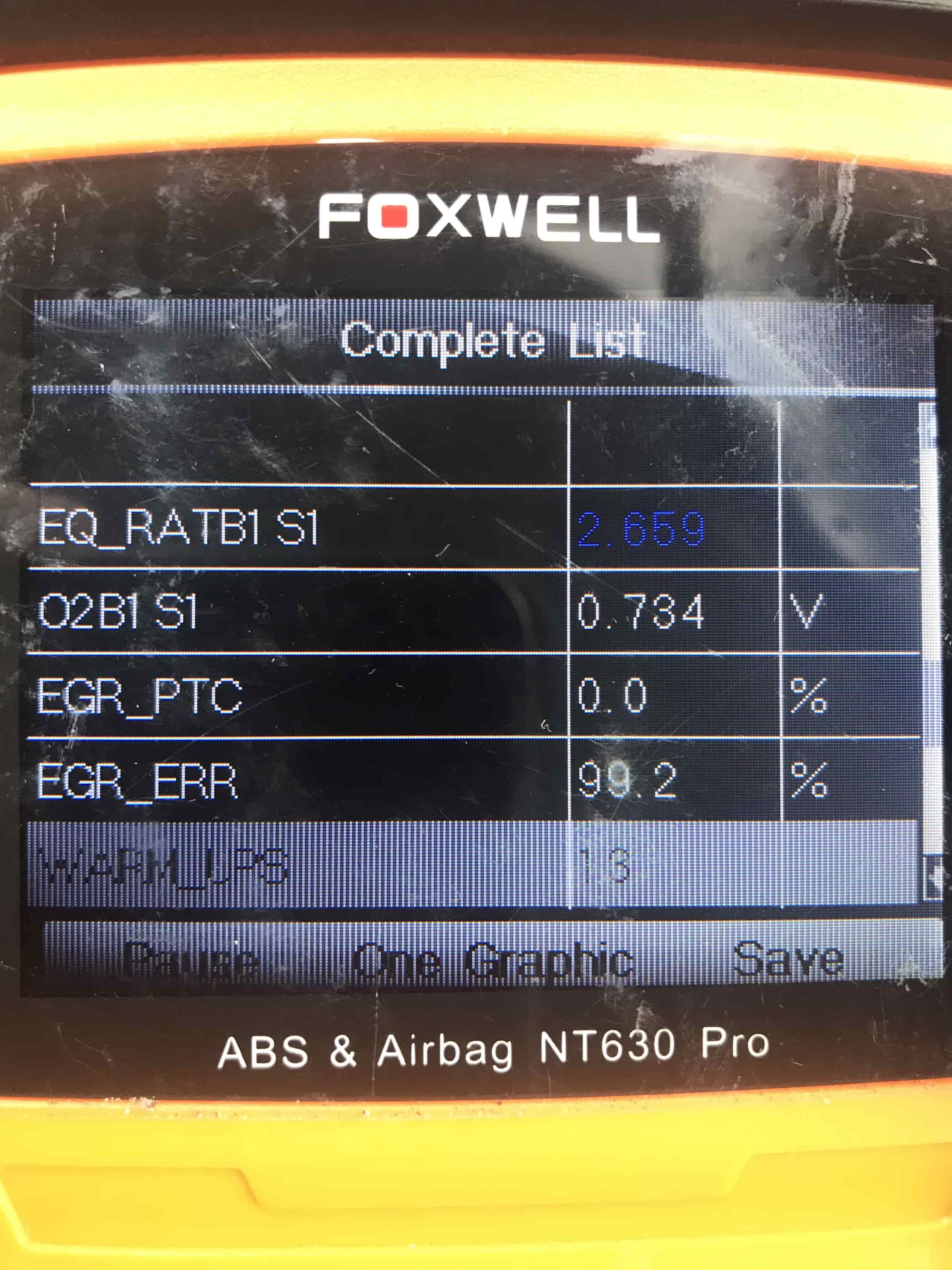

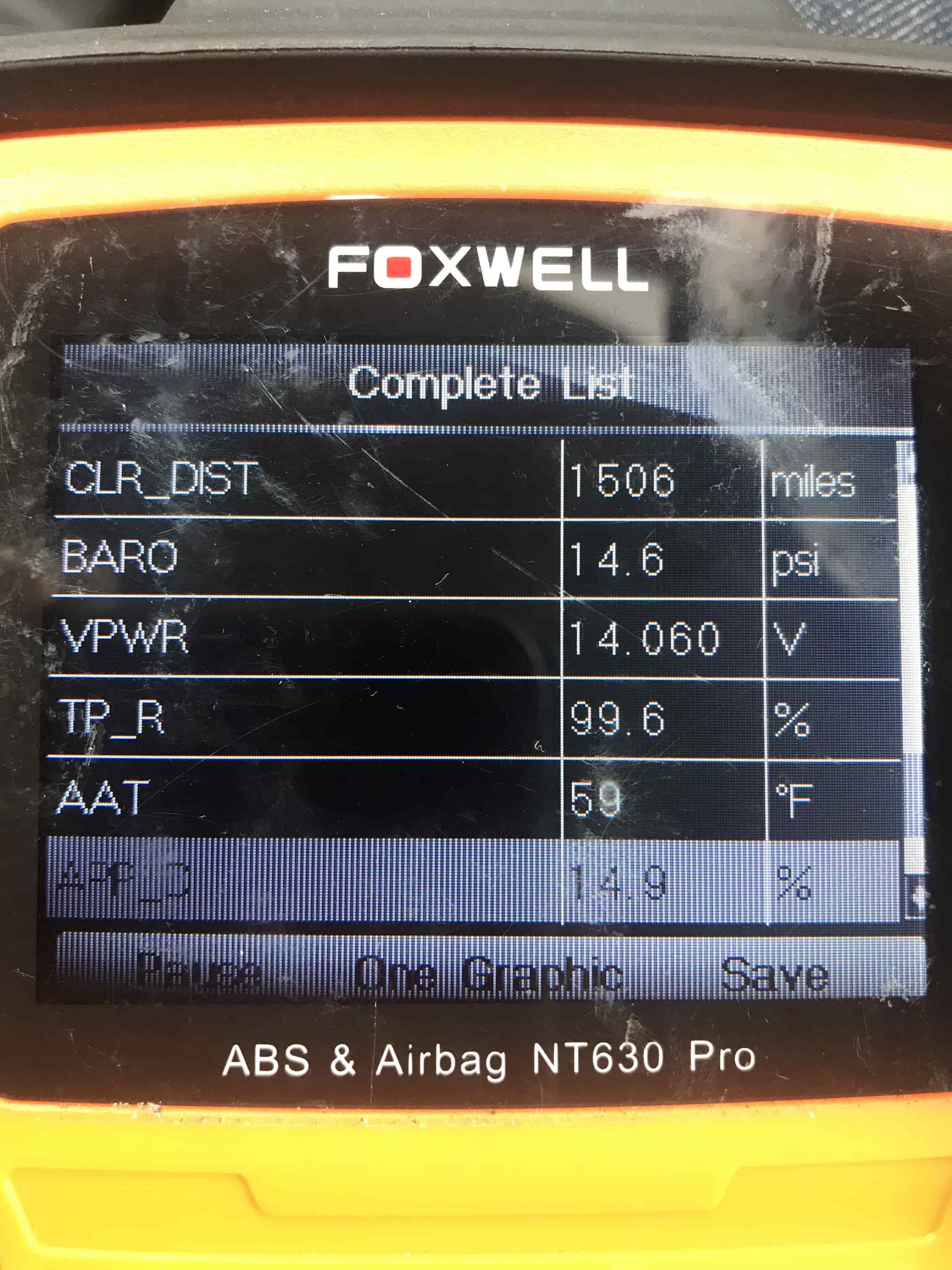

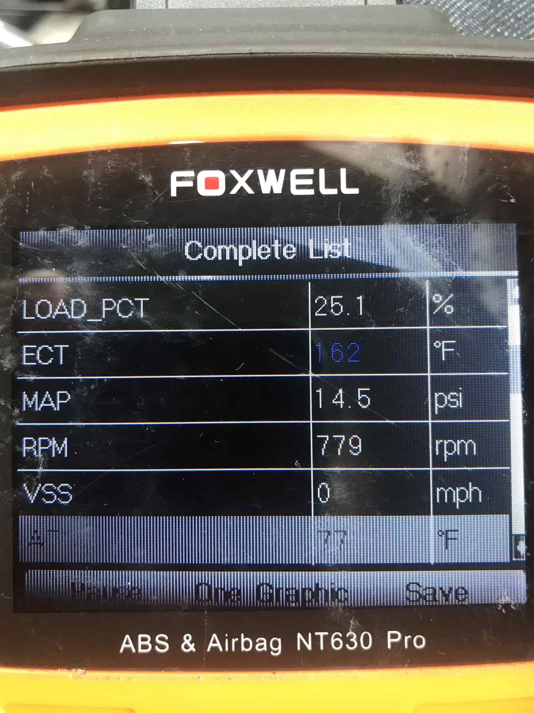

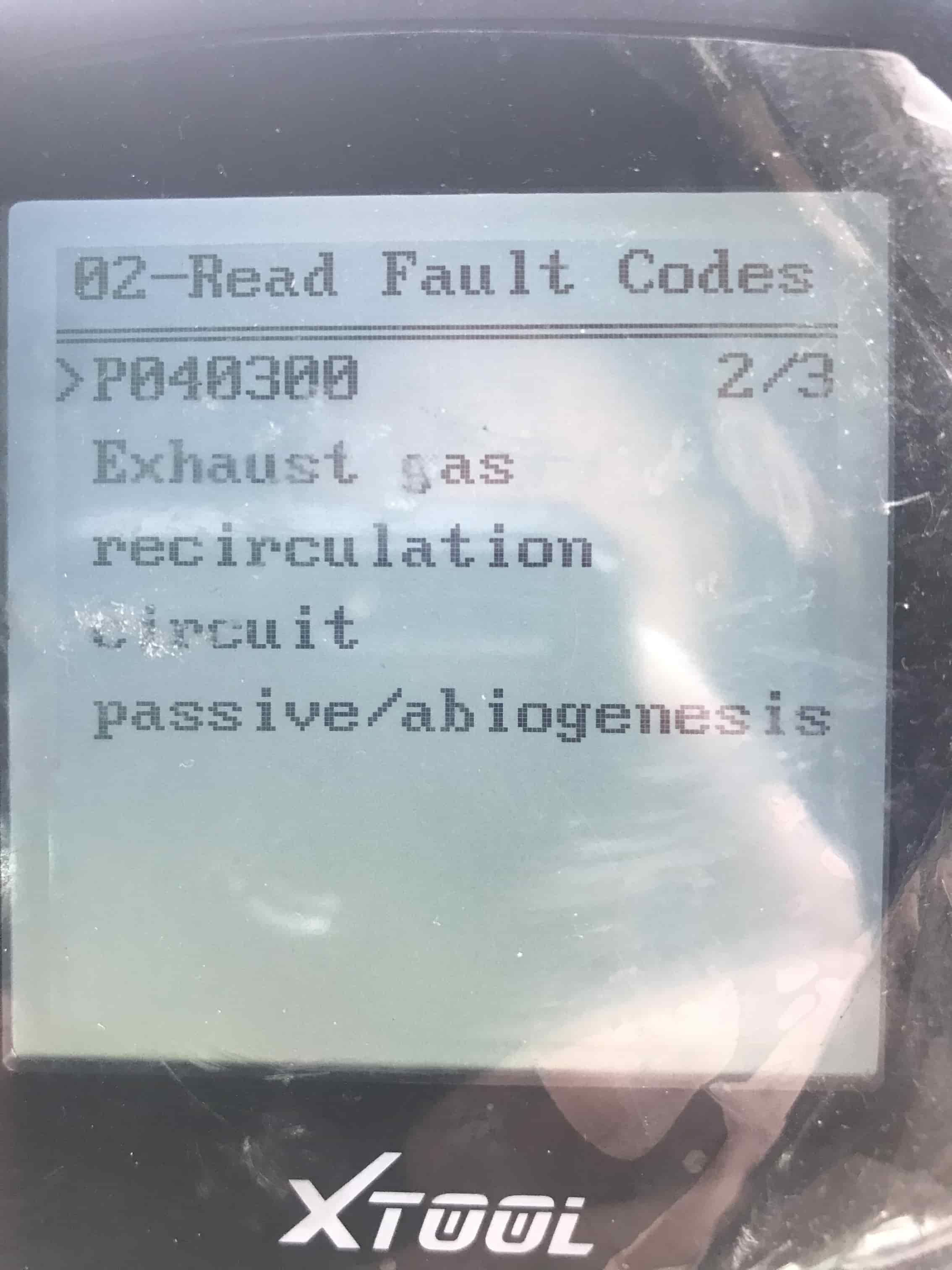

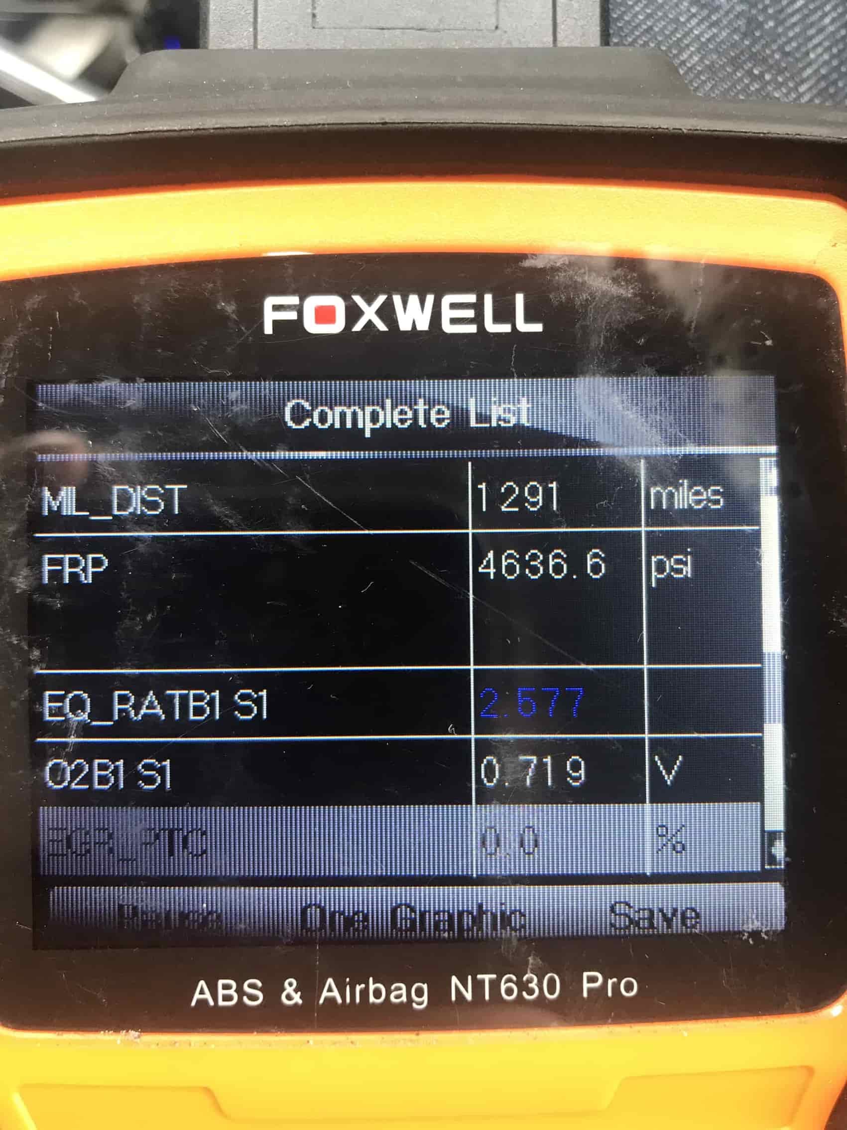

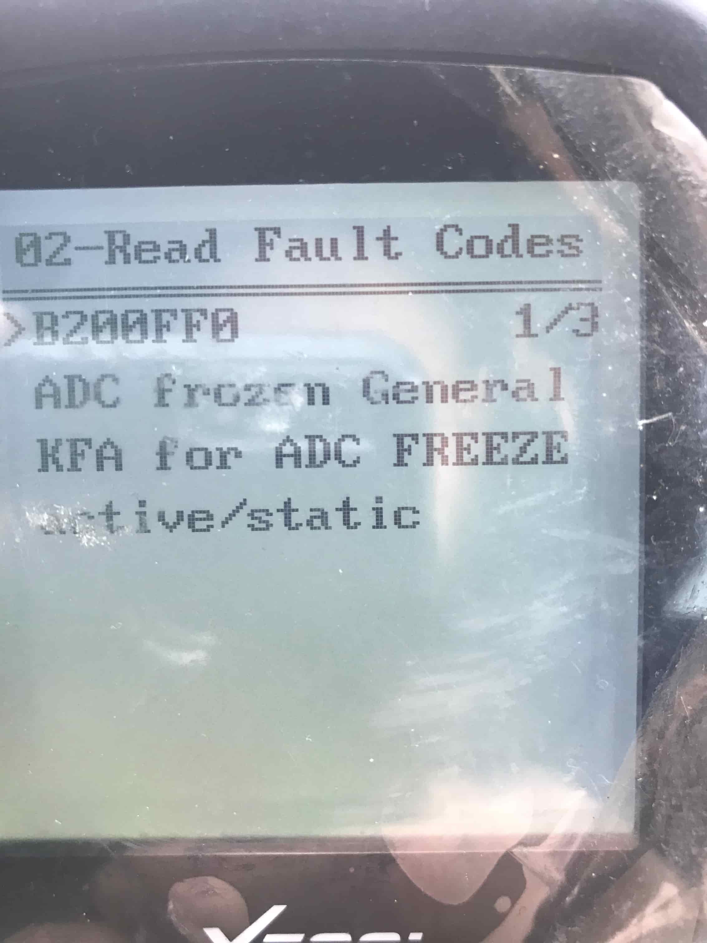

So the glow light come on, and it started to limp. Off!! On!!! Fine for 20 mins. Then back to limp. Scanned with my aftermarket VAG tool, and also my Foxwell ODB scanner.
Ill post pics and some live data from the Foxwell. Glow plugs are probably overdue can,   But I know this can be the dreaded EGR problem. My old man reckons I should get it terra cleaned first to see if that fixes it.
Any advice?
@langers2k
Well I used a can of Wynns Extreme EGR Diesel Cleaner, and the coil light went away. Car seems smoother. Cleared code. Lets see how this pans out...
