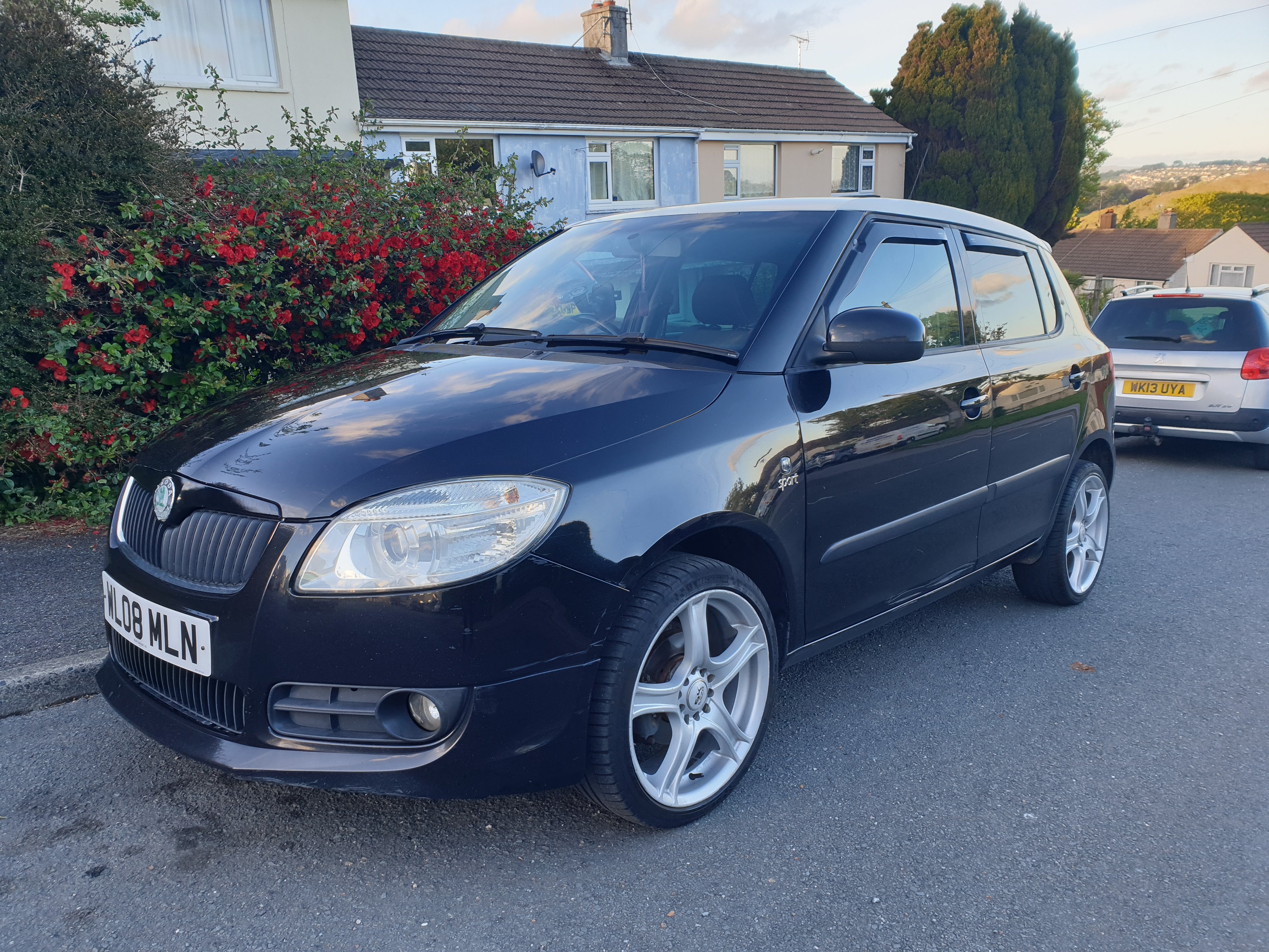

Swapped my Mk6 fiesta for this 08 Fabia Sport 1.4 TDI yesterday,  my first Skoda.....
Are these common issues;
1. Both front E/W go down ok, but seem to slide forward on the way up so i have to pull them back.
2. Drivers door doesn't lock with remote locking, only Key in lock. (No warning lights on)
