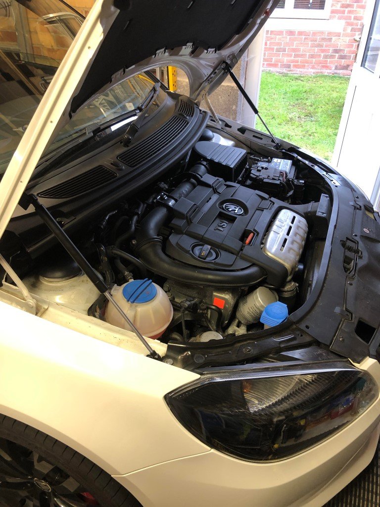

Got mine today from Sokie, 2 day delivery from Taiwan, most impressed.....they even went via Japan and paris :o
Look great though and so much better, car really should of had them from new :)
Packaged well, look well made and fitted in 10 mins.......highly recommended :thumbup:

Looks good Urban, how easy was the installation? Might be something I consider putting on my car. Have you also got the link to the ones you got in Taiwan?
Installation - 10 mins max.....

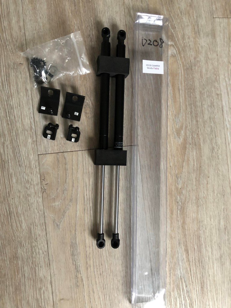

My tool arrived Saturday and I had the time to fit them today. They were slightly more work then Mr Panzer's "Sokie" Variant but at around £20, worth the saving!
The main difference is the connection bracket, where it has a sliding fit and utilises both front and rear bolt, on the bonnet hinge.
This gives some degree of adjustability but I think it is pointless really. It also means you need to be a little cautious about removing the bolts to fit the bracket as there is a potential to mis-alight the bonnet.
The easiest way is to remove the front, uppermost bolt first, lovely fit the bracket on, with just enough movement to slide a little, then remove the lower, rearmost bonnet hinge bolt, slide the bracket to align the hole, then tighten. Fit both sides first, check the bonnet lines up nicely and then proceed to fitting the dampers. It will be easier this way, as the dampers will just add resistance, making the alignment check and adjustment harder.
You then bolt the dampers on to the brackets, with the ball jointed bolts that are on the struts already, bolt the other ball jointed bolts, along with washers on to the cars front panel. (You will need to remove the pre-fitted bolts to do this). Then just "Click" the struts to the ball joints.
If you look at where UrbanPanzer fitted his lower fixings, mine fit to the bolt just in front, the silver ones with the large-ish washer.

So, to the front lifters, I am happy with the price and the looks. Similar to the "Sokie" apart from the bracket. Mine looks a little more "Finished" but the Sokie ones looked better packaged. Mine were jiffy bagged and bubble wrapped, rather then nicely boxed but then, the box goes in the bin at the end!
They work nicely, not too much force they surprise you but a slow, steady raise to fully opened. I notice that fully opened is a few cm less then standard but this can most likely be dialled out, with a little adjustment on the bracket, which has around 100mm of adjustment, although in practice, this will most likely come down to half of that.
I may also have had the extra few cm, had I fitted the lower bracket the where UrbanPanzer did but when fitting, the other bolt hole looked "Right" and the thread was correct so I went with that! Not sure I can be bothered to play around more with it, to try gaining such a small difference.
