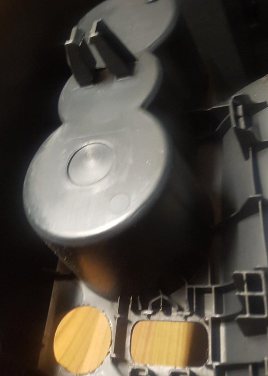

If you have the same layout as my 06 Vrs, the wiring does go backwards to a connector held by plastic clips which are part of the console itself (approx 4" back from the socket itself). If you pull the side carpet back (strong velcro) It should give you some more room - not much but maybe just enough - to get your hand in and unclip the connector, only one bit is held in by the clips so the socket connector should be the bit that comes free!
To get the socket out there are 2 small detentes inside that need to be pressed outwards whilst the socket is turned it should then come up and out, then the green surrond will also come out.
Hope that helps.
See the clips under the cup holders that holds one side of the connector from the socket. You can just make out the small flat in the socket hole which lines up the grren surround IIRC

Impossible to reach the other part so whole centre console and storage box has to come out, manual no use except perhaps for base vehicle, finally after a lot of swearing I got it to lift up and away to replace the plug, problem was rear ash tray would not come out and I didnt want to force it but did in the end.
