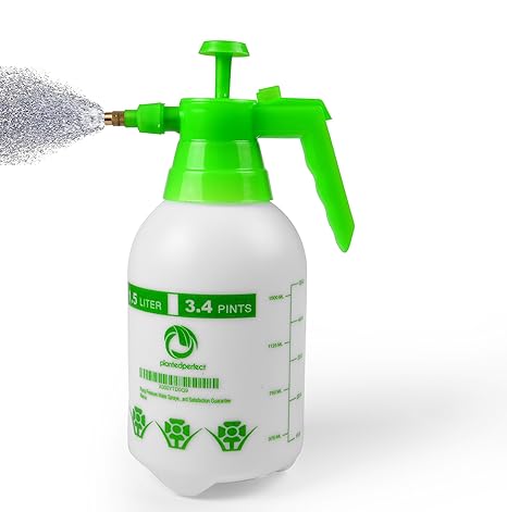

1. Get a bottle of 99%+ methylated spirit (alcohol).
2 put it in a pump spray bottle.
Image result for pump spray
3. Run the air-con system on max cooling for a wile so its wet inside (5 min). Then with the highest fan setting and with the doors open ...
4. Open the glove box and remove the air filter.
5. With your head outside the car :) mist the alcohol (go for the finest spray setting) through the inlet in the glovebox where the filter was. This should now be sucking in air from the slot (strongly). Run about 250 - 300 ml. While you are doing this keep an eye out for any dribbles etc on vents and wipe it up.
6. Stop the fans as soon as you stop spraying and let it sit overnight. You want the internal pipework, radiators and drainage channels to be wet with alcohol. So don't run the fans after you stop spraying.
This should kill the bacteria / mold causing the smell.
7. Next day, reassemble the filter, open all the windows and run around the block with the fan running.
