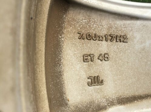

On the inside surface of your wheel you will find stamped numbers showing the Width e.g. 7” and the Offset e.g. ET45 (mm)

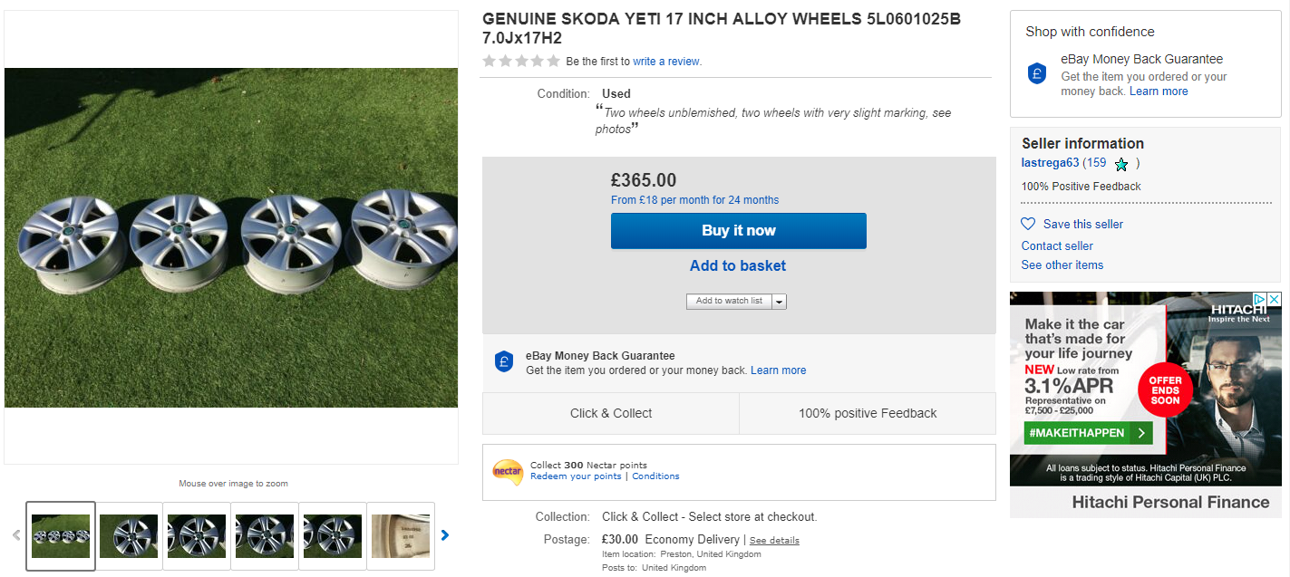

Here is a set of very clean genuine Skoda 17" Dolomite alloys with an ET of 45 from off the Yeti. A nice simple design, so they won't collect the winter road grime, with the added advantage of them being very easy to wipe around with a sponge.
Two are unmarked, two have a few small scratches.
Delivered to your door for less than £400...
https://www.ebay.co.uk/itm/GENUINE-SKODA-YETI-17-INCH-ALLOY-WHEELS-5L0601025B-7-0Jx17H2/283481552222?epid=1337329396&hash=item4200d1355e:g:iUgAAOSwZGBc1wCN
There are lots more on eBay too.

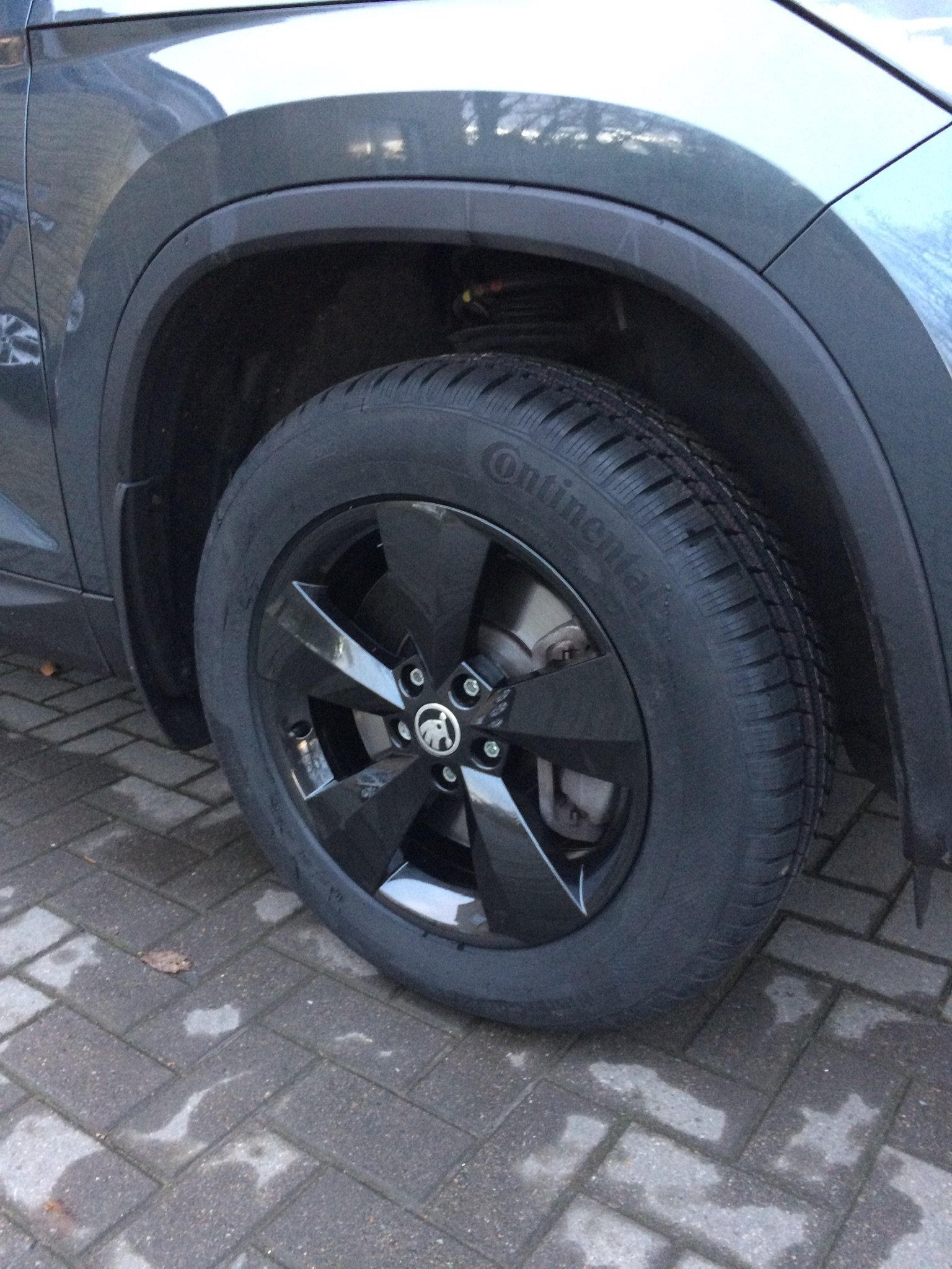

I chose 17”  Nanuqs for my Bear.
