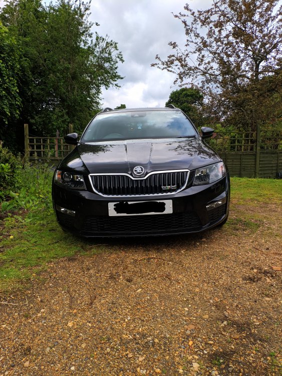

The Chrome grill surround is no more
So today i swapped the chrome grill surround for a Black one and it looks so much better,
Took around 30 minutes to do
The surround cost me £35 from eBay

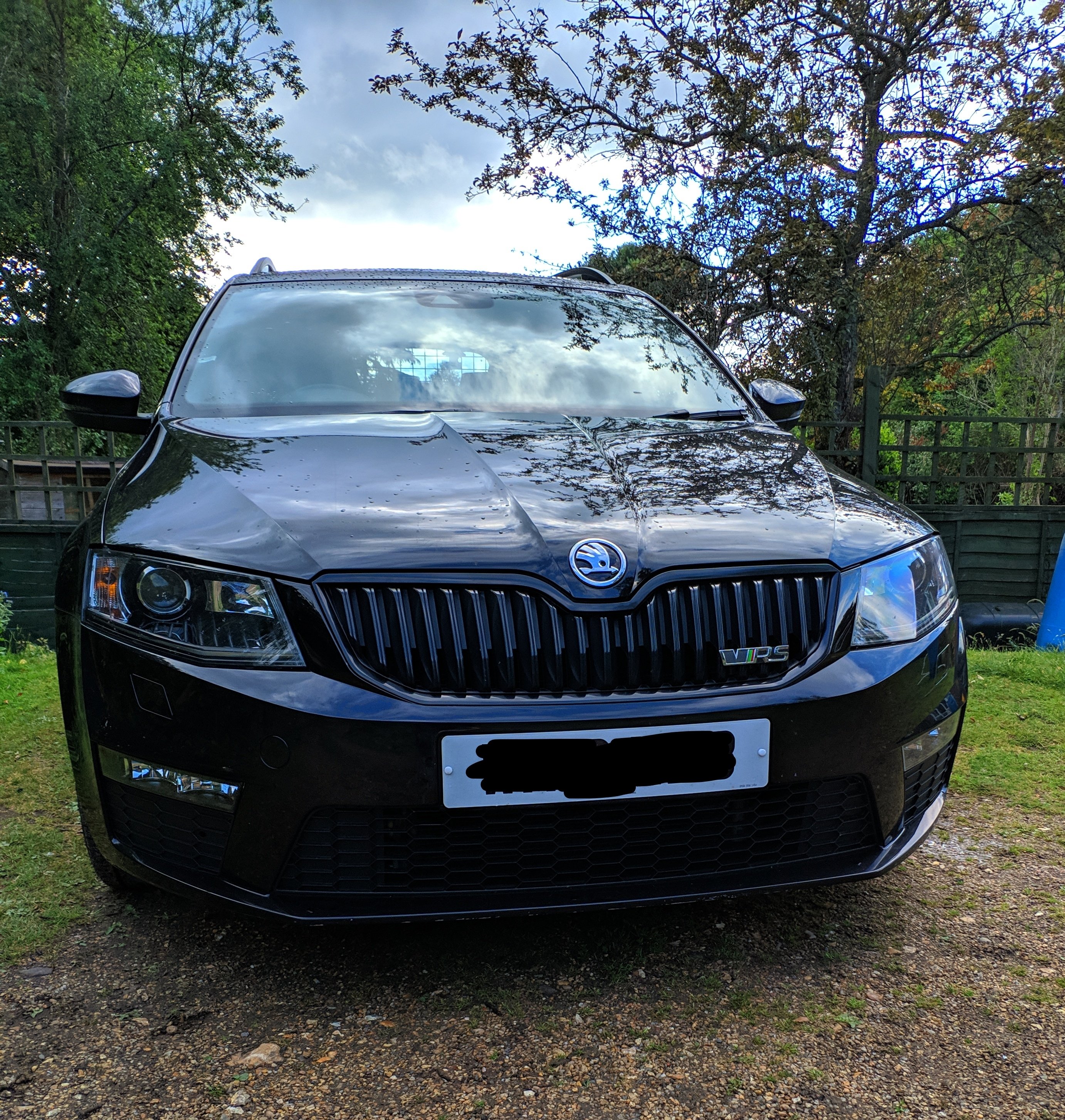

Finally got round to changing mine....
Edited by Marshy33
Looks so much better doesn't it?
100%, the chrome just looked out of place. So much happier with it now!
