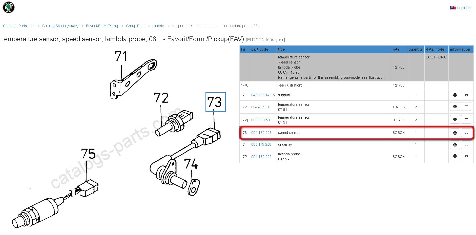

You don't see the part number because your part number is wrong.
Correct part number is 004165008.004165008.thumb.jpg.cec7ac69dc141806e35889a368820615.jpg
Hmmm that is very strange. When I go in to the system and select 1994 Favorit I get the same diagram but part number 73 is the part number I showed in previous post and not the one you have shown.    I dont know how to show the picture in the post as you have done, but I went Favorit/Forum/Pickup , 1994 Fav,  electrics,  ignition transformer, temperature sensor, speed sensor, lamda probe     and this was the number it gave me,  How strange
