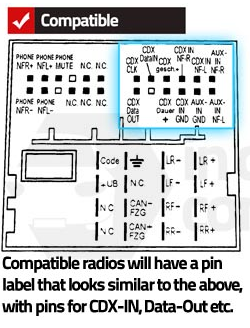

This might have been covered in the past but I had a browse and are unable to find anything related.
I have bought the following bluetooth unit: https://www.incarconnections.co.uk/skoda-bluetooth-adapter-streaming-and-calls/skoda-bluetooth-adapter-for-streaming-and-hands-free-calls-ctaskbt003-quadlock.html
It doesn't appear to work but the website shows that I have the correct connections on the back of the bolero headunit.
AUX and SDHC are greyed out on the headunit as well. How can I get the headunit to recognise the bluetooth unit?
Do you have an external CD changer in the boot?
If not, then at a guess, you'll need the headunit coding to say there is an external CD changer before that aftermarket BT module will work.
No there is no changer in the boot.
How do I get the headunit coding to say there is an external CD changer?
