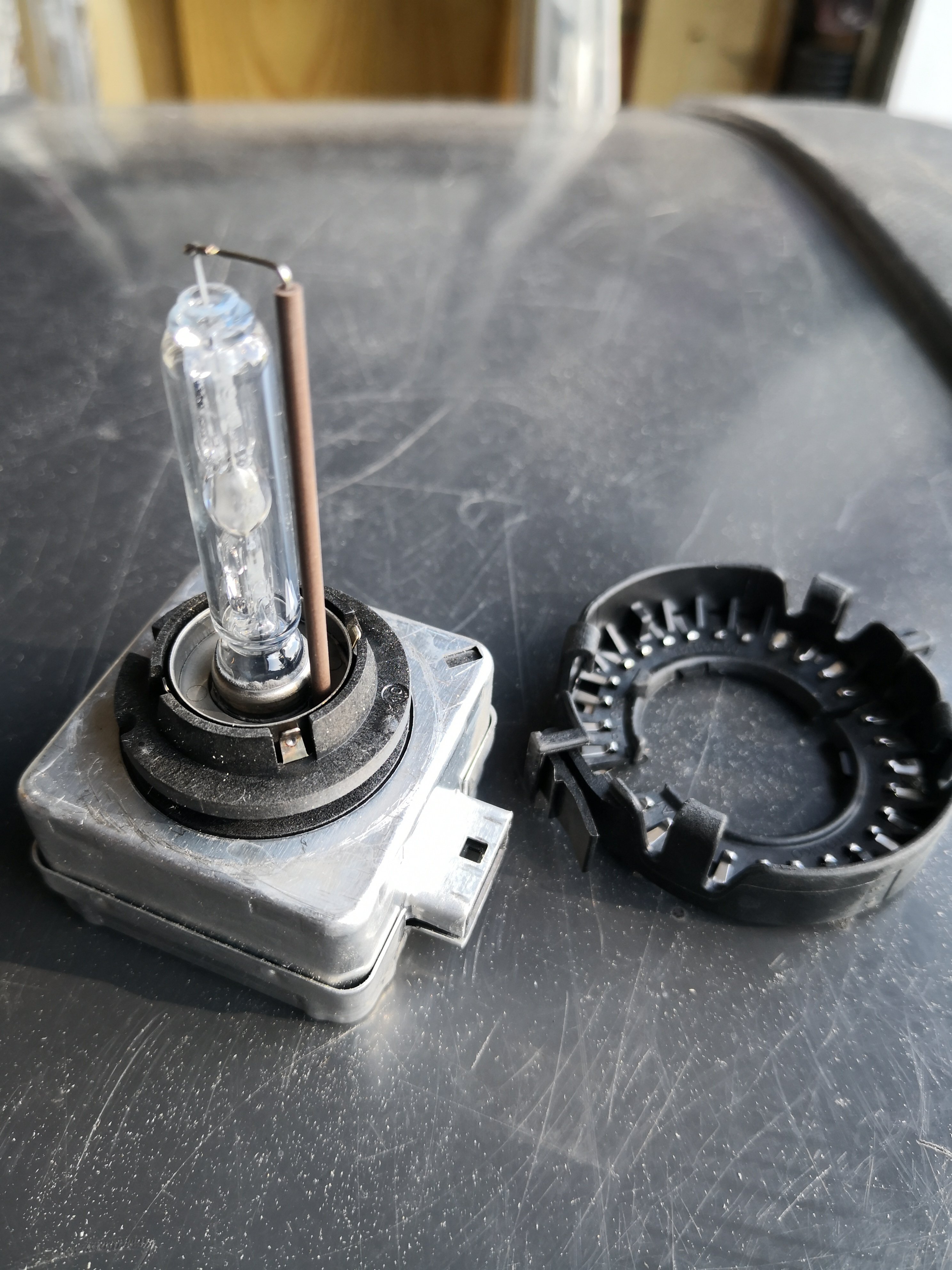

Dipped bulbs
Pretty sure you need a D1s rather than a D3s. Is this for a MK2 Superb (as per this section) or a MK2 Octavia (as per your profile)?
I'd also suggest you spend a little more and get bulbs from a reputable brand and supplier as there are plenty of fake xenon bulbs around.

Hi, it is for an Octavia!
Then the MK2 Octavia definitely wants D1s not D3s bulbs :)
As for the K rating, that's down to you... I think the best performance is probably in the 4-5k range.
Thank you!
The new bulbs are not working, I've tested them on the other side just to ensure not faulty and they are both fine.
Next step new ballast?
Edited by mark674500
Sounds likely :)
You can also swap the ballast from side to side to check it's not wiring related. It's the silver module rather than the black one.
