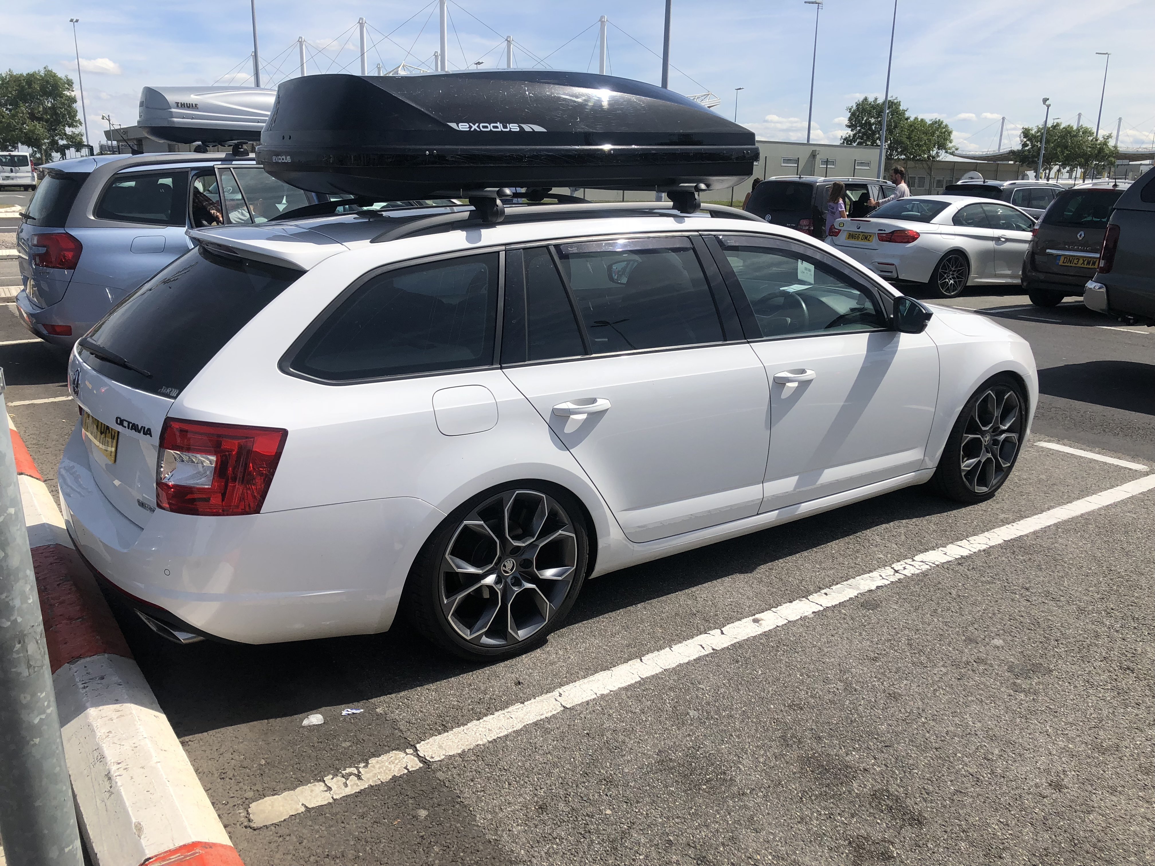

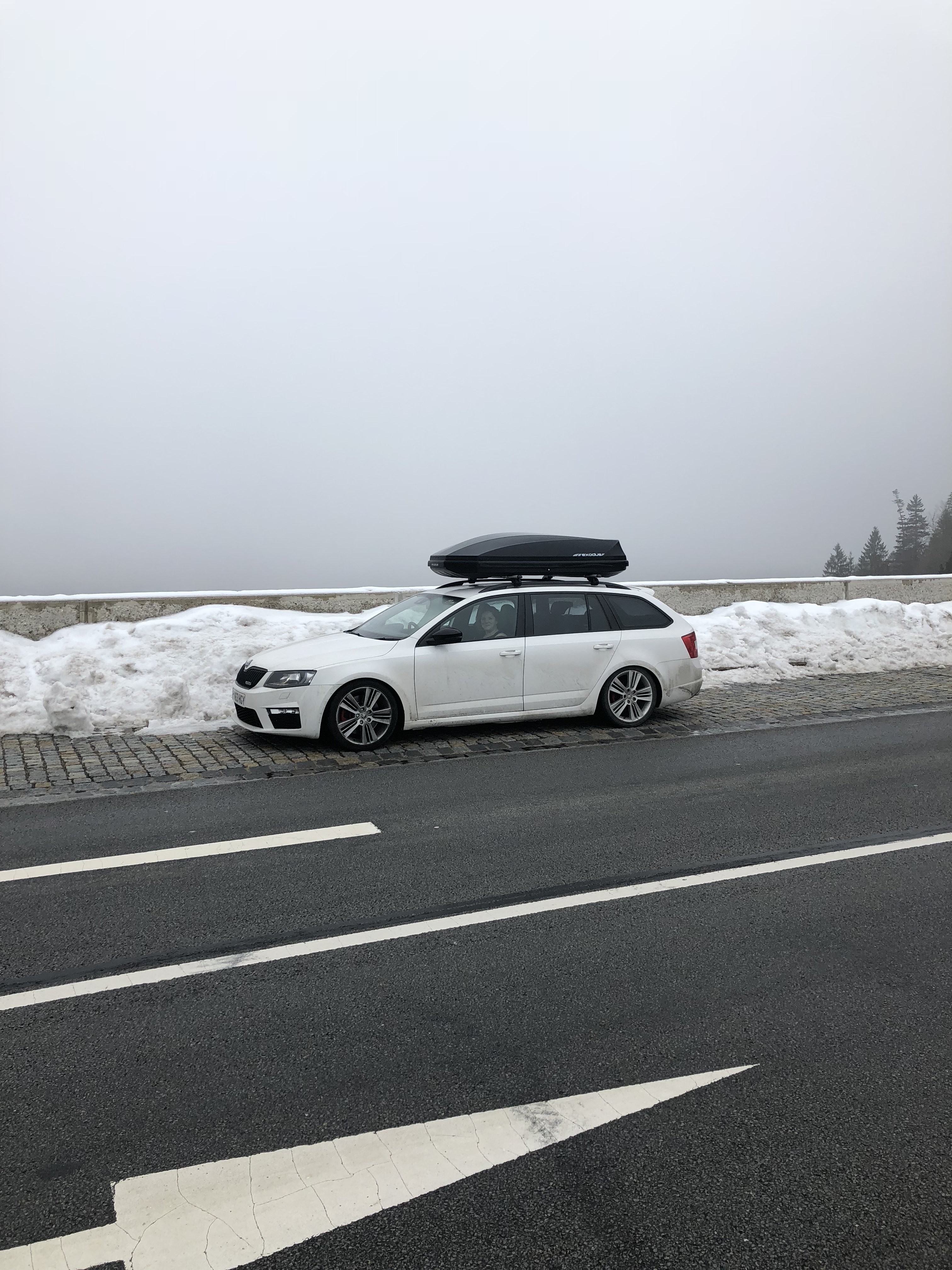

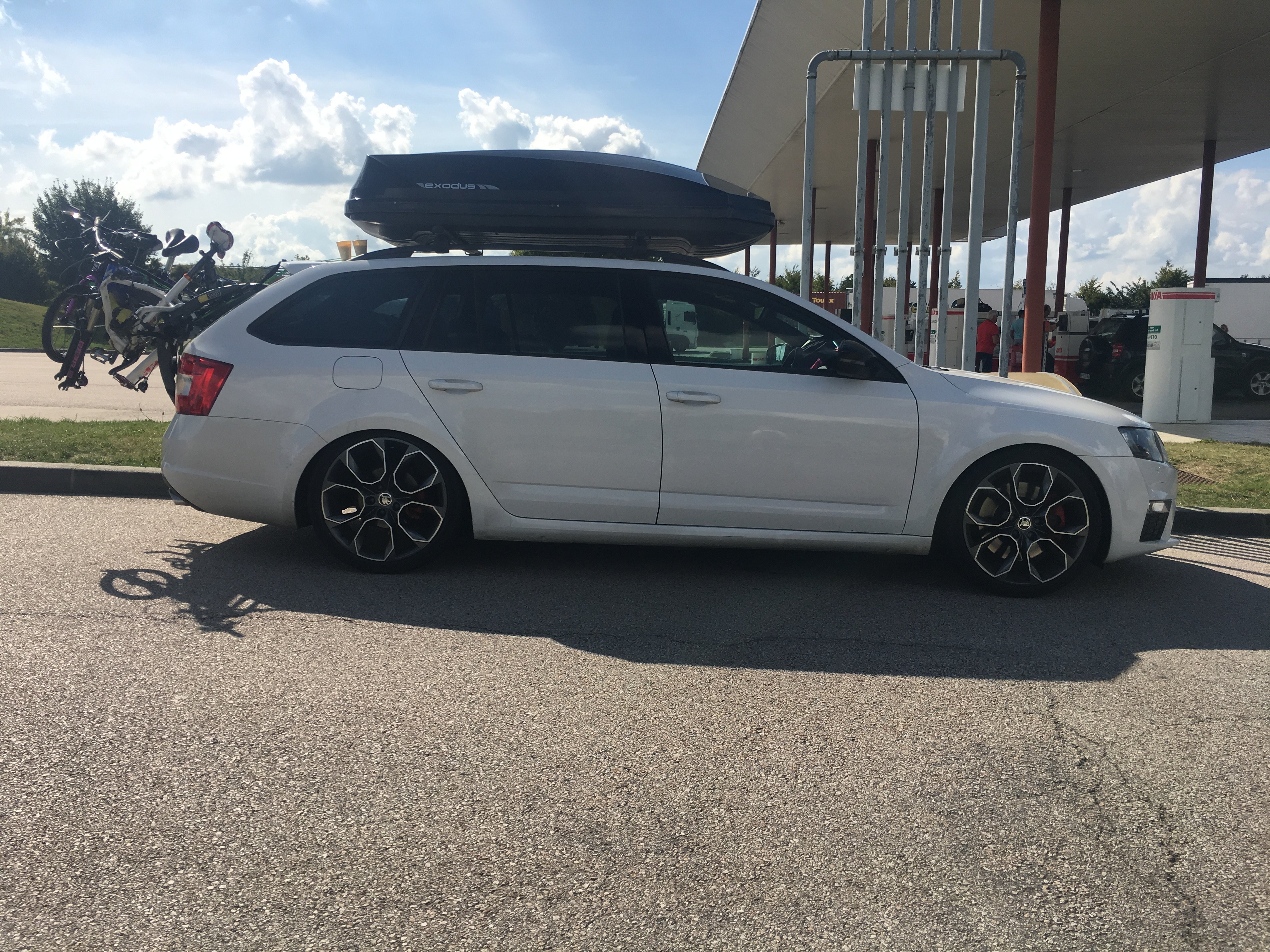

This is my full car on H&R 40mm springs. 2 kids. Snowboarding gear and the other 2 is all the camping gear.

Was spot on mate. Never had any rubbing issues and was on 12mm spacers too. Ride was still pretty good and I think the one with the bikes on I hit the bump stops on the back once over a big speed hump. Did about 80k miles with the H&R on and never needed bushes shocks or drop links either.
The new superb has the H&R on now too.

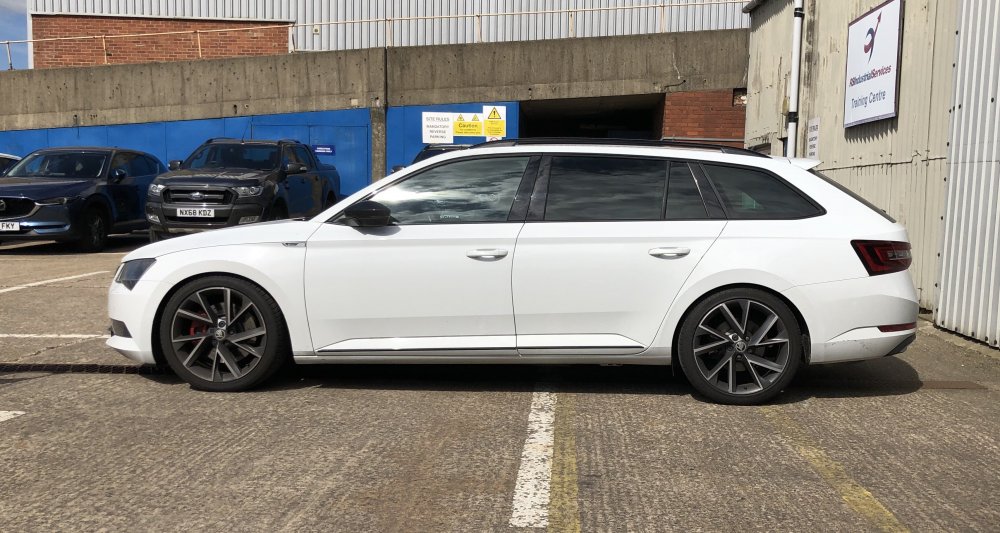

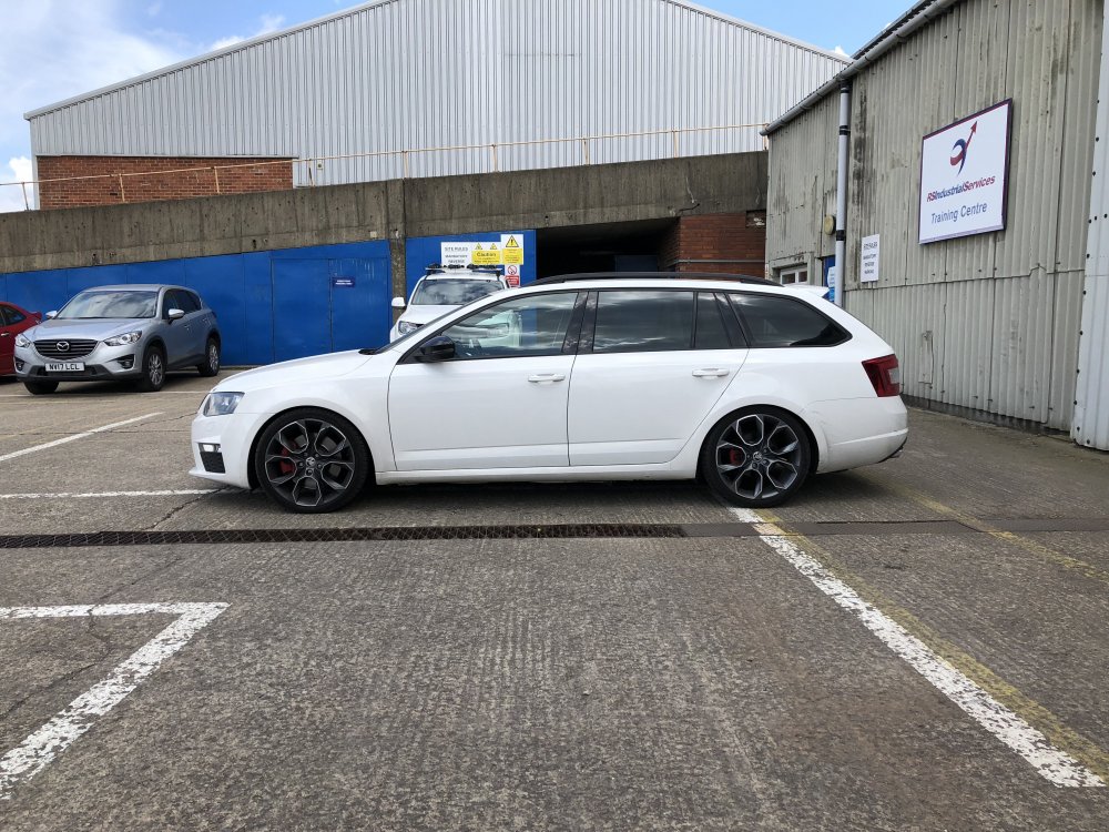

Pics below are the vrs not loaded and then the new superb on the H&R too

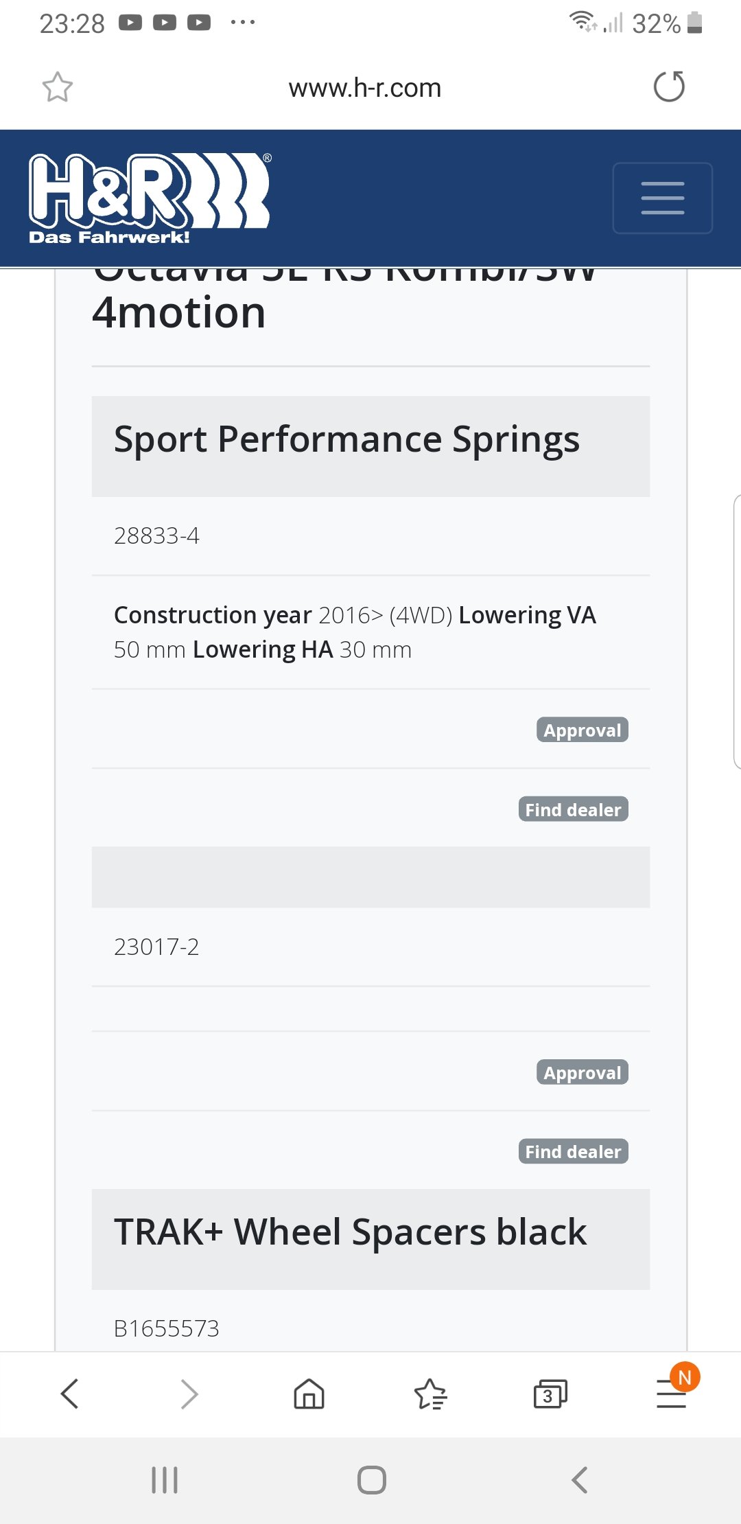

Think the H&R part number is 28833-4. Just check and make sure that the front and rear axle weights match the specs of the springs 😉

That's the only springs I can find but its 50mm front dont want to be doing that much

Yea I thought I remembered something like that what you need is the spec for all the springs and then order them separate by part number and not as a kit. I’ll have a look see if I have still got it
