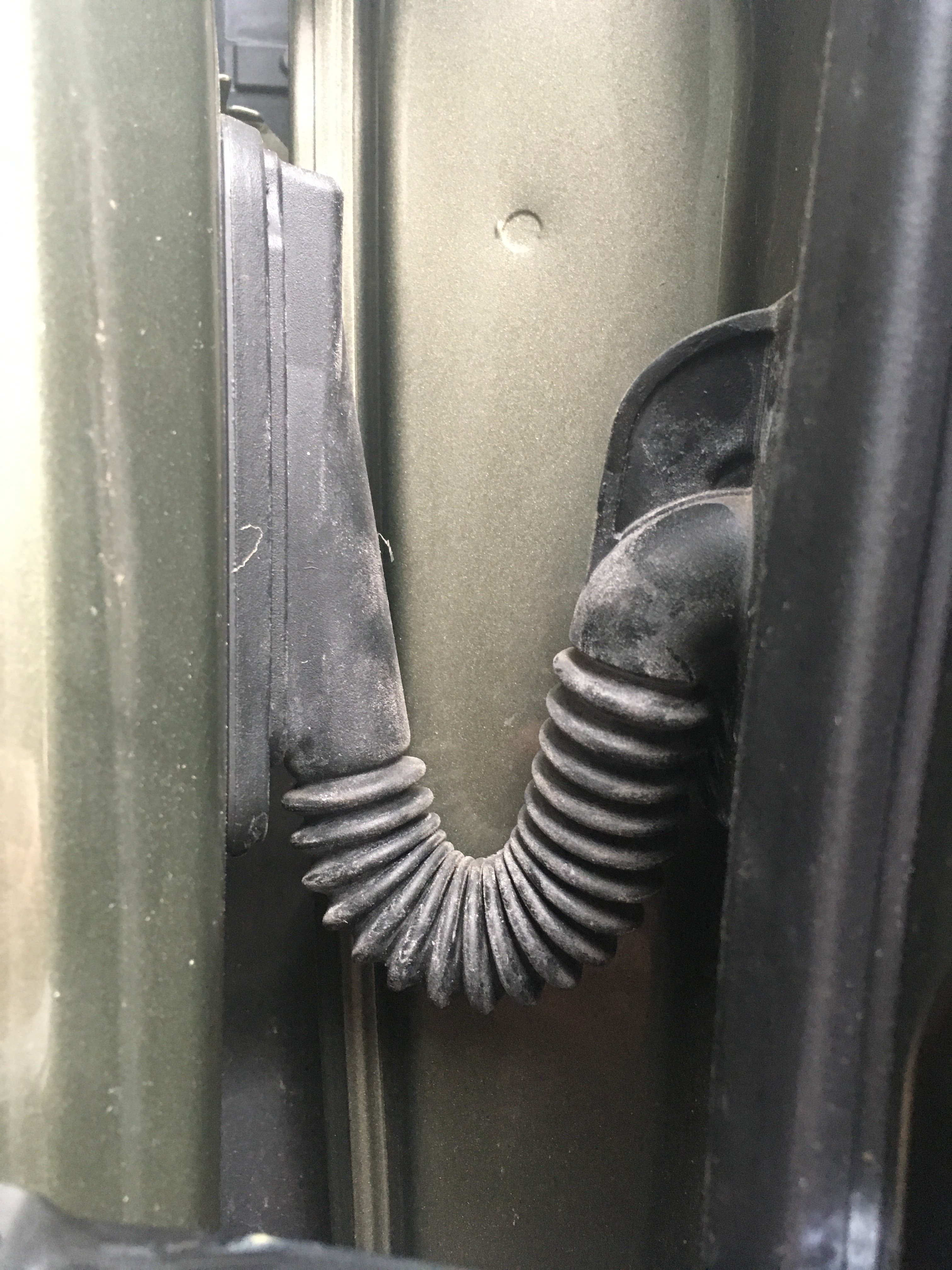

Just a quick update. Disconnecting battery has not helped and we have swapped fobs but that hasn't helped either. We have also superficially looked at the wiring in each door to see if there is an issue there (broken wires etc) but that also seems ok, although a closer look there might reveal something.  We're still seeing menus appear and disappear and currently the locks unlock repeatedly at worst every few seconds or so but at best maybe once a minute.  Thanks again for suggestions. Will post back here when we finally resolve this whether by ourselves or by taking car to a skoda garage.
The wires break in the loop between the door and frame and is a known issue in early cars. It would be difficult to access and check this part of the harness as inside a protective cover. Hopefully yours has the improved loom with a longer loop to prevent this issue?
Thanks Ken, This is how ours looks. Can you tell whether it's older one or not?
That's the newer upgraded version.
