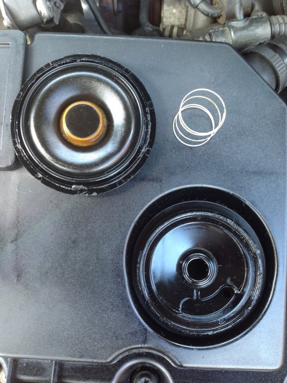

Hi All, This was leaking oil on the engine cover is it some kind of pressure regulator ? and can you glue it back on ? Cheers Stuart
It looks like the PCV, clean thoroughly with brake cleaner or similar and super glue back together, any subsequent leaks can be addressed externally with a bit of silicone RTV.
Thanks for that Micmac, I have glued it back on and left it overnight to give it time to set and then start running it. Cheers Stuart
