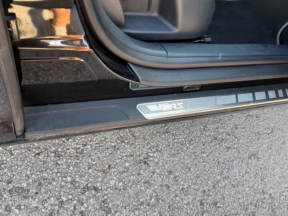

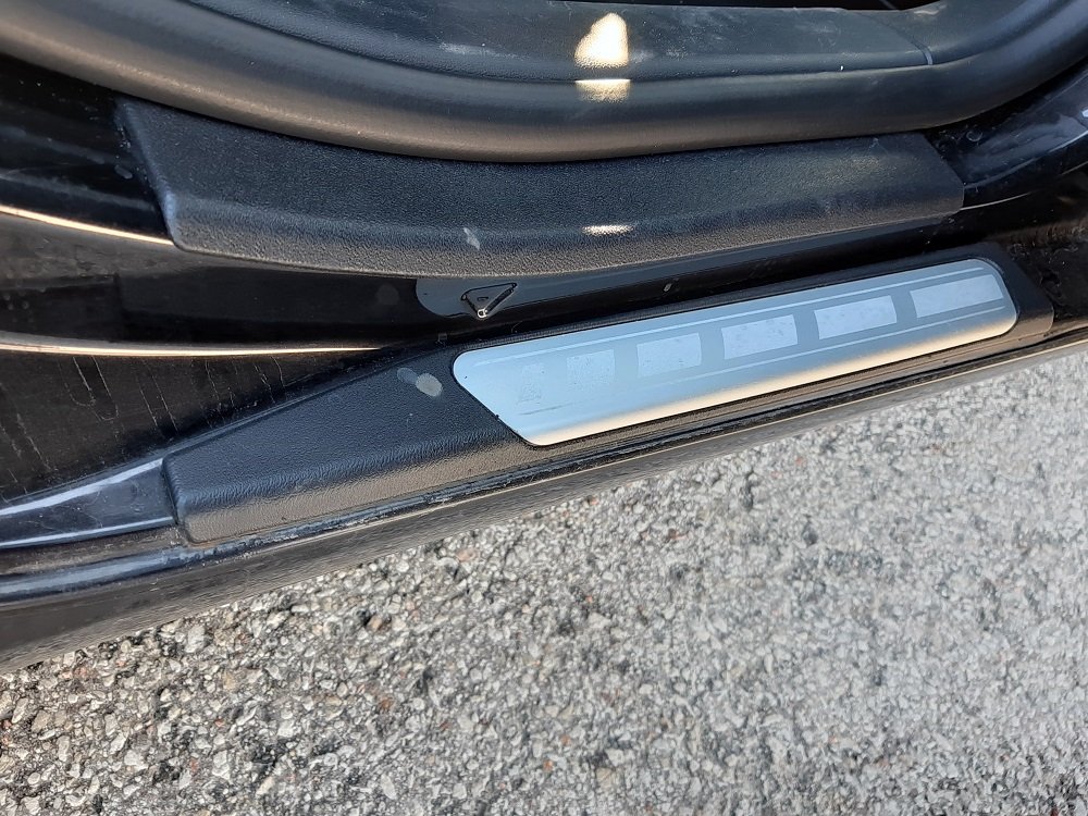

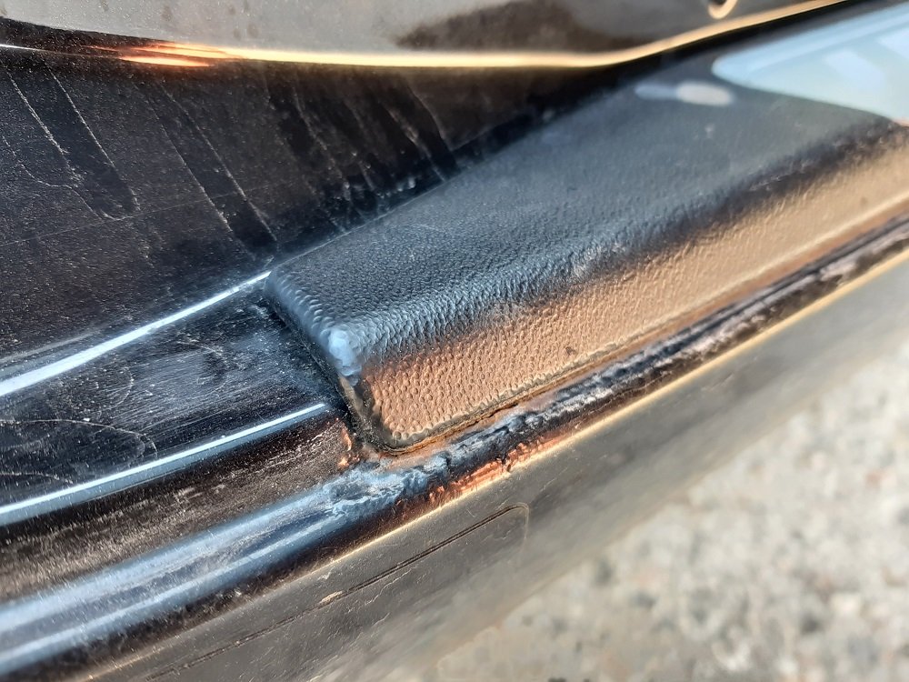

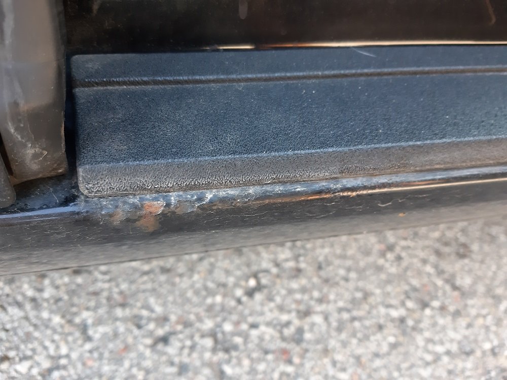

I have owned 2006 year vRS estate for about two months now, and I have noticed few rust spots. The ones that concern me are below(pictures).
The question is how to remove these decorative plastics? How are they connected to the sill(double sided tape?). For some reason I couldn't find anything on google. Maybe I was searching with wrong words.. 😓

They look like after market sill guards i bought some for my Octavia they are held on with double sided tape
and they will be a sod to get off, if you intend keeping them try warming them up with a hair drier  that might
help save them.
