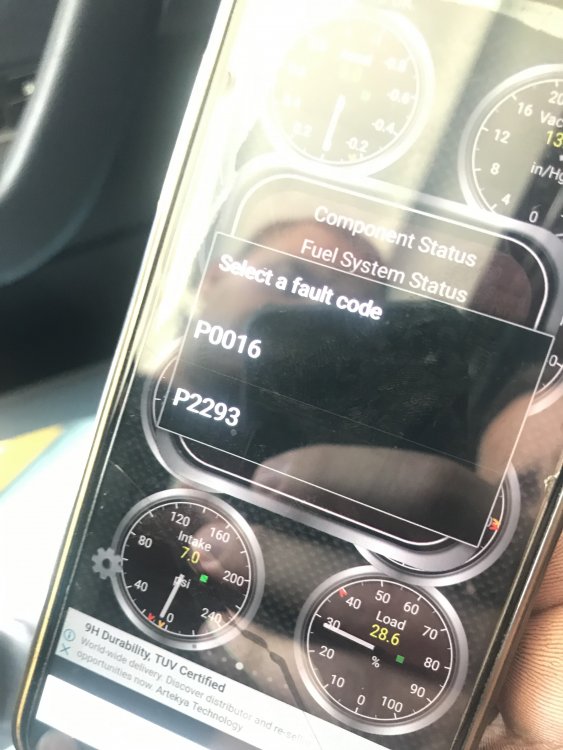

P0016 and P2293
I have these two errors and engine light on.
Google both codes. But these are basic error codes, from a generic scanner.
I would get the codes read with proper diagnostic equipment, which will provide you with more information.
P0016 is a camshaft/crankshaft correlation issue
P2293 relates to the fuel pressure regulator valve
