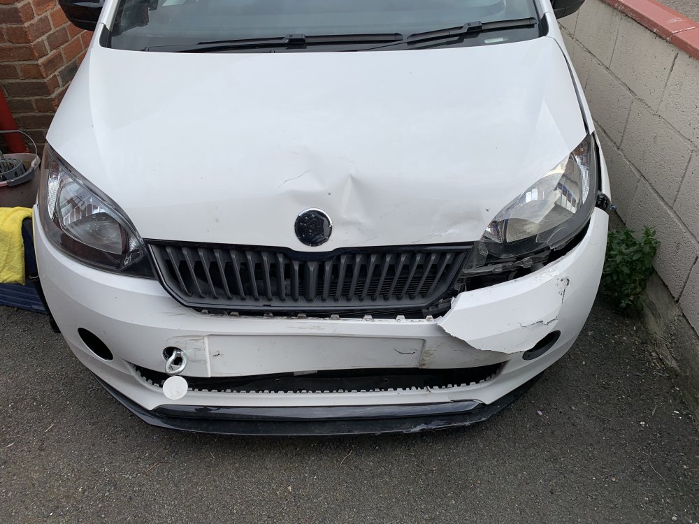

Got the Citigo roadworthy and MOT passed yesterday.
Car is now pulling the P2279 fault code for a Vac leak.
Any idea anyone of any common issues ?
Car was in a front crash (see pic) but I can’t see any damage to the inlet manifold area....
help....
All pipes on the airbox?
From what I can see they’re all connected OK.
Made sure the PCV valve pipes were OK and struggling to find any obvious issues.
MIL light popped up, a friend checked the codes and cleared them down and car driven around for about 5-10 miles more and no dash lights on yet.
