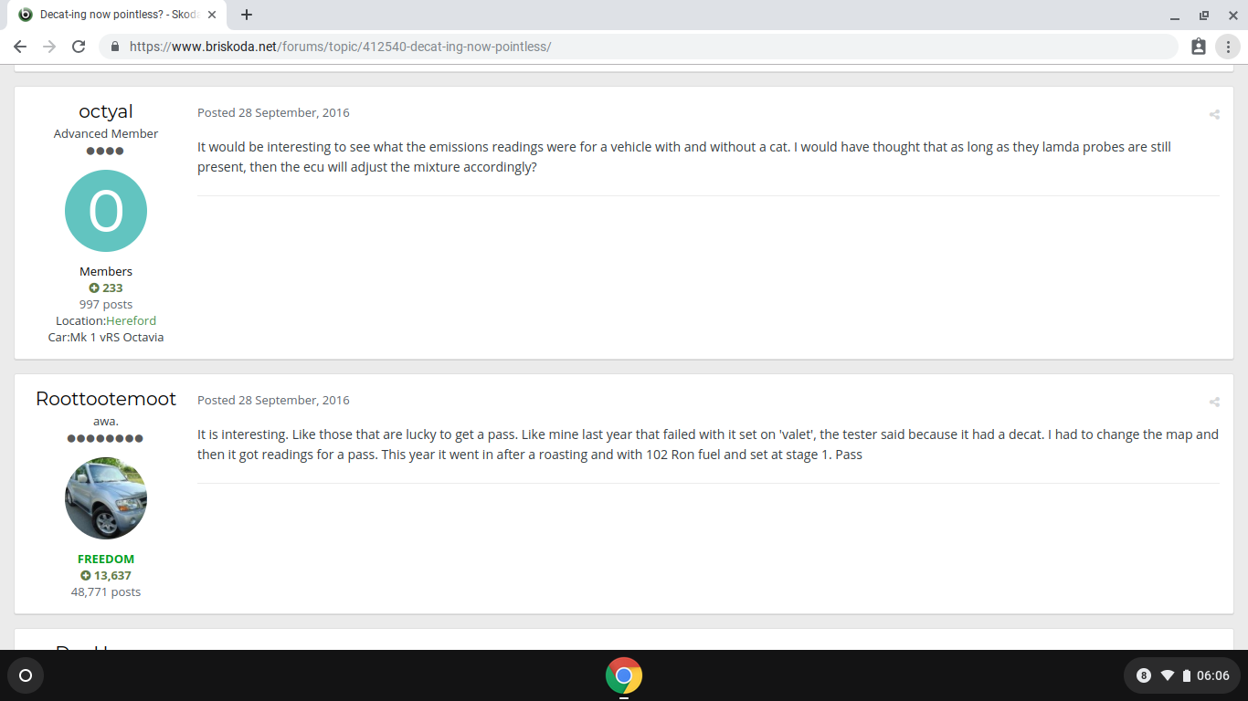

http://briskoda.net/forums/topic/268168-vrs-mot-issue

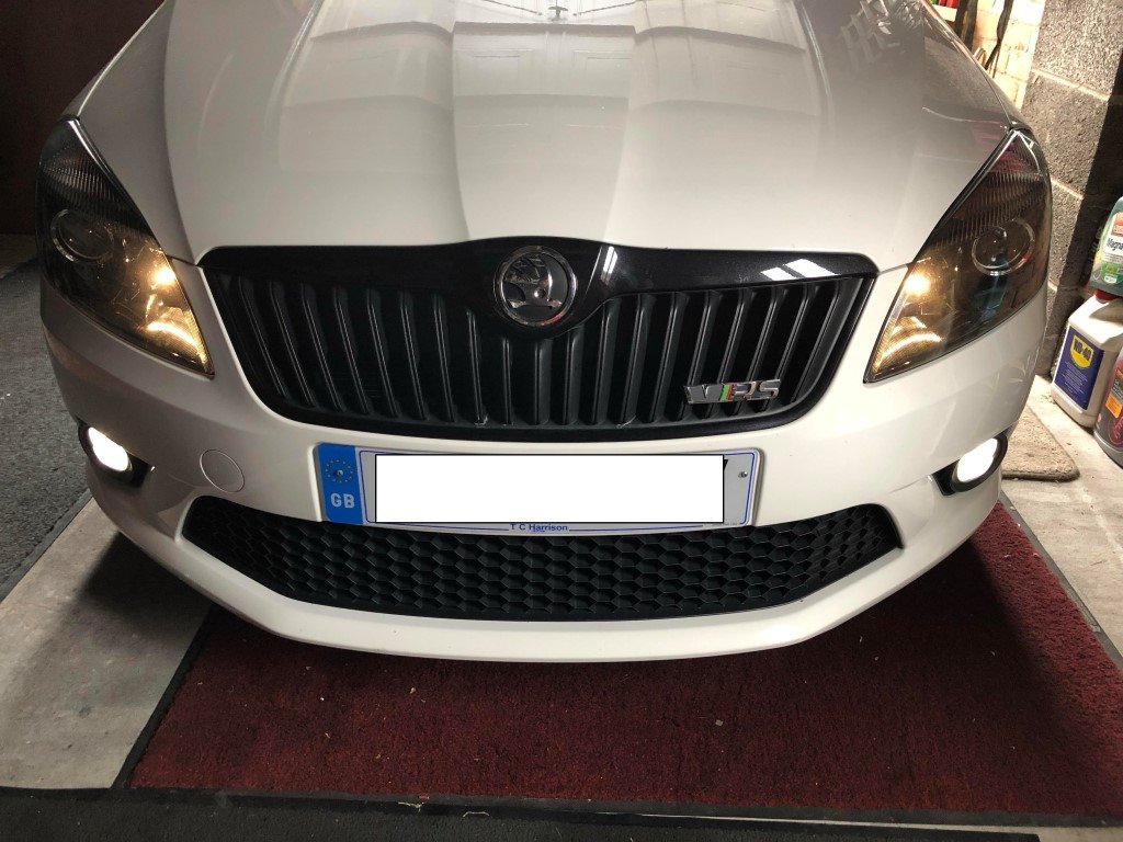

Did get asked about the sidelights to, although I knew the guy testing and explained.............but still wired up the sidelights anyway, much better using the bulbs that were sitting there doing nothing, looks better to !!
Do you still have the DRL units on dimmer as a sidelight then just to annoy some drivers that think they are fogs?
(and used singularly as parking lights.)
It's exactly as it was before, just when you flick to sidelights, the DRL's dim and the top ones come on as they should have done from new.
All pinned and wired into existing headlight looms for a factory install
