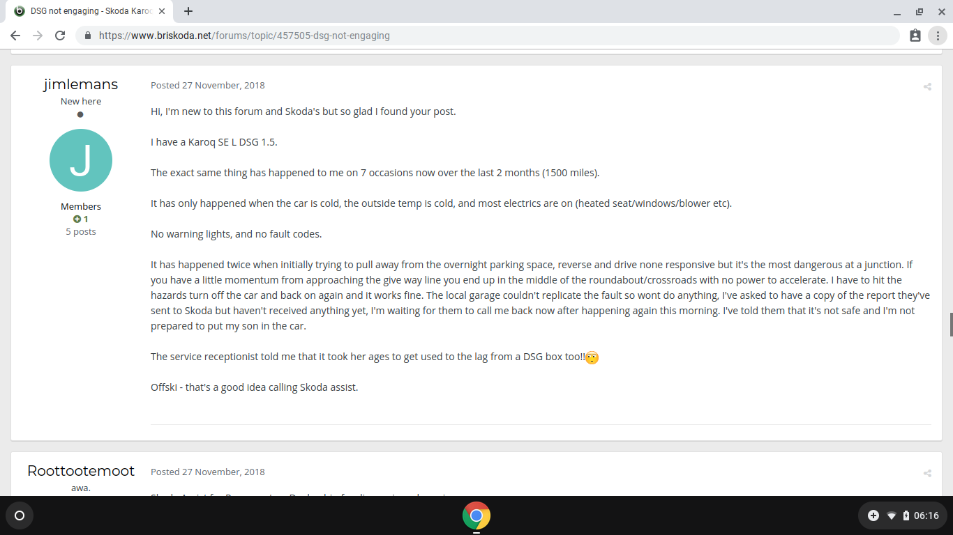

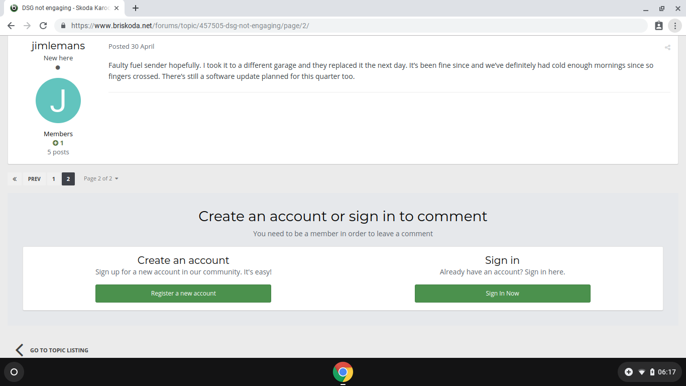

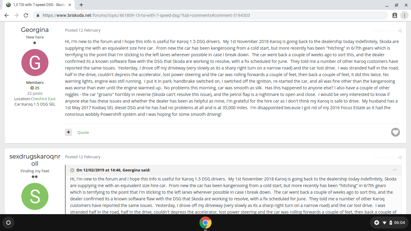

It has happened to others with a Karoq before and there are posts in this section on their experience.
The Dealership Master Tech needs to talk to Skoda because this is safety critical and could kill someone.
Leave the car with them and get a courtesy car or call Skoda Assist.   You should not drive the car.

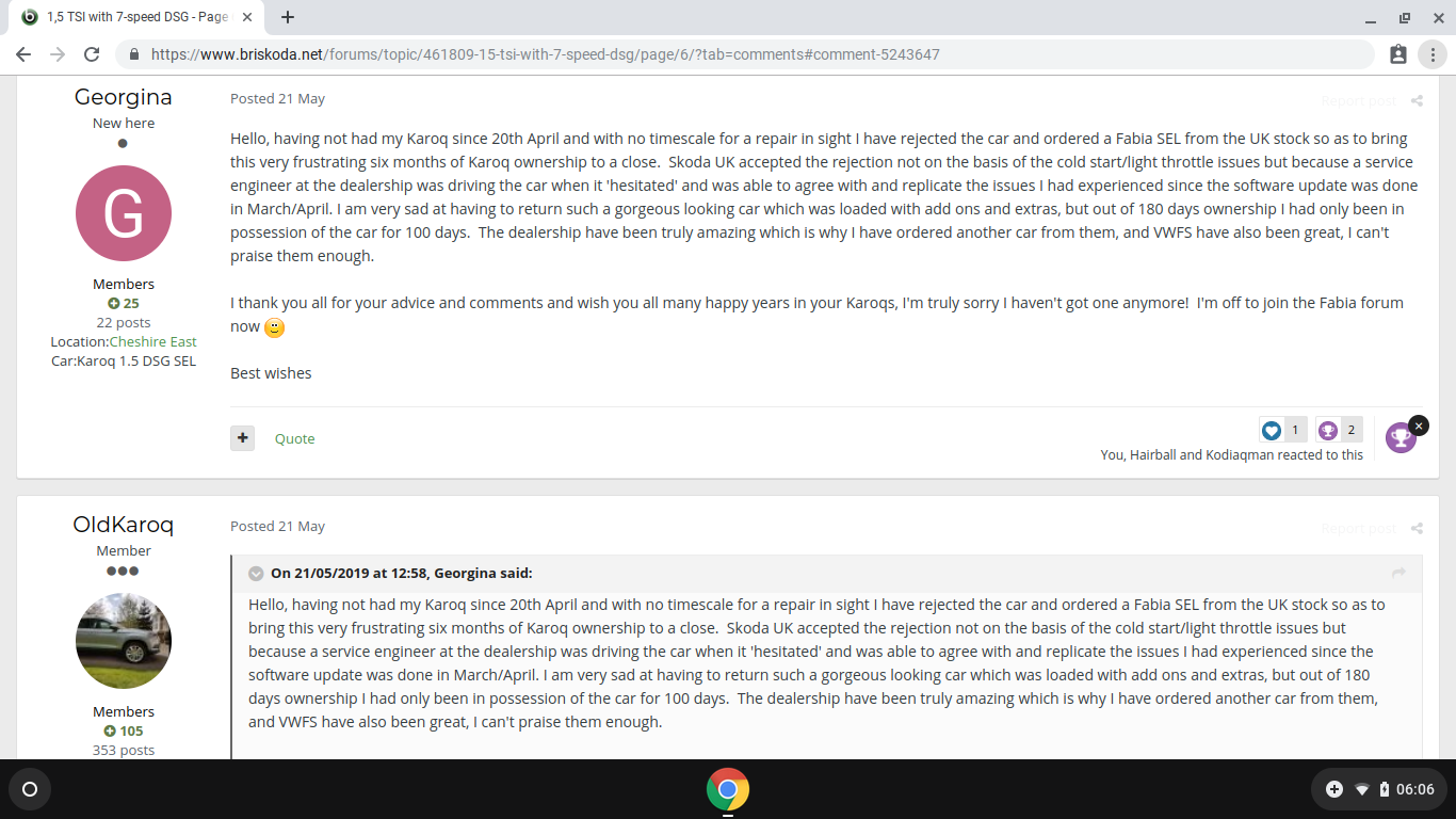

http://briskoda.net/forums/topic/457505-dsg-not-engaging
