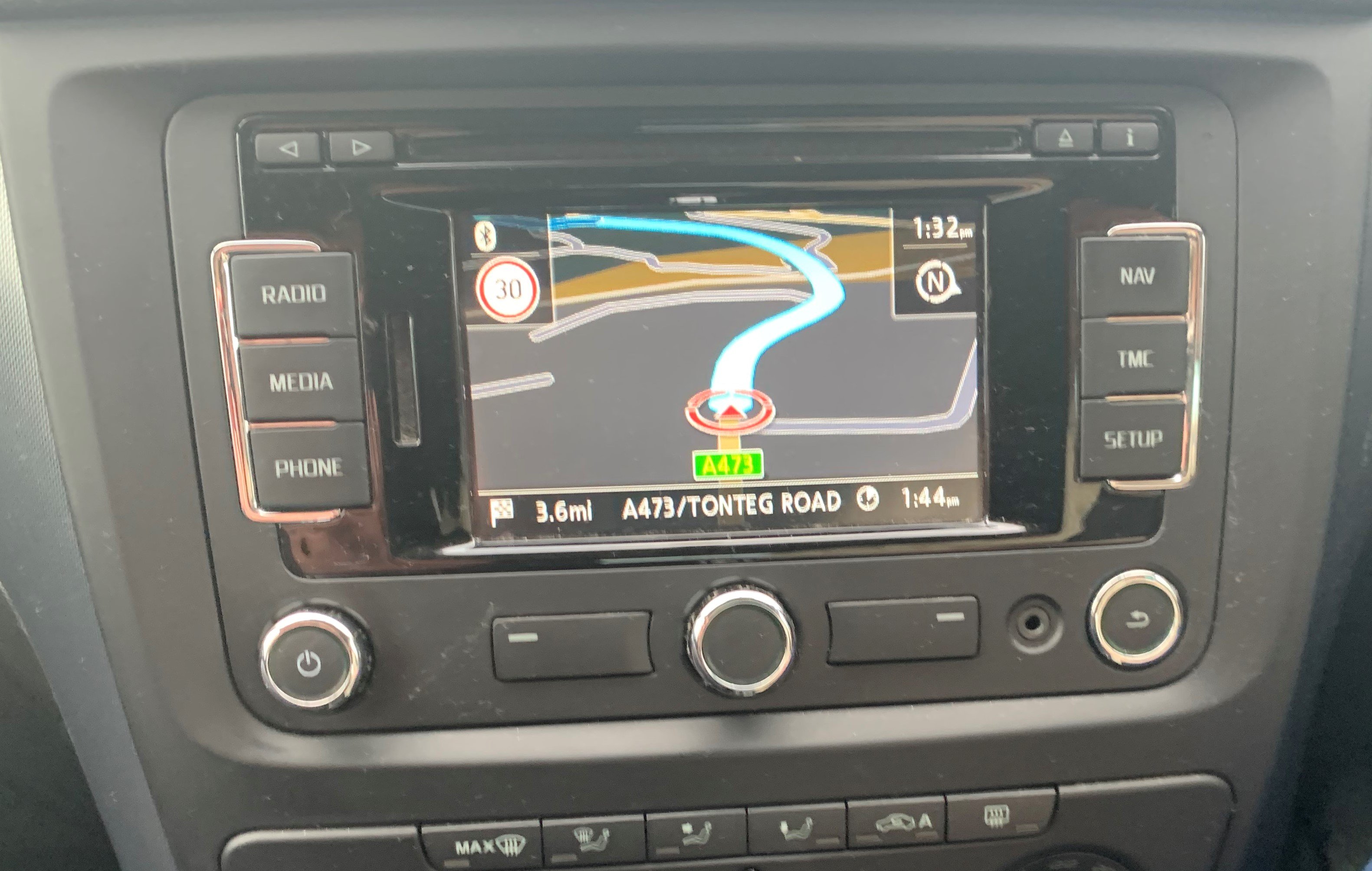

I've recently bought this little puppy from a vw tiguan it works like a charm,the sound is great and all BUT, there's no maps for Chile even though that tiguan was a model for the Chilean market.
Is there any chance to just copy the map onto a regular sd card?
Thanks in advance

You either have an RNS310 or an RNS315. They're very different despite looking the same. If that's your actual unit in the pic then it's an RNS315.  Maps for an RNS310 will not work.
I had a quick google, I can't see any South American maps for the RNS-310.
However, for the RNS-315 it looks like there are a few versions:
- V3    3AA-051-866-E
- V4    3AA-051-866-K
- V6    3AA-919-866-AD
- V7    3AA-051-866-AK
The latest looks to be 2016/17.
As always, please check the part number yourself before buying...
