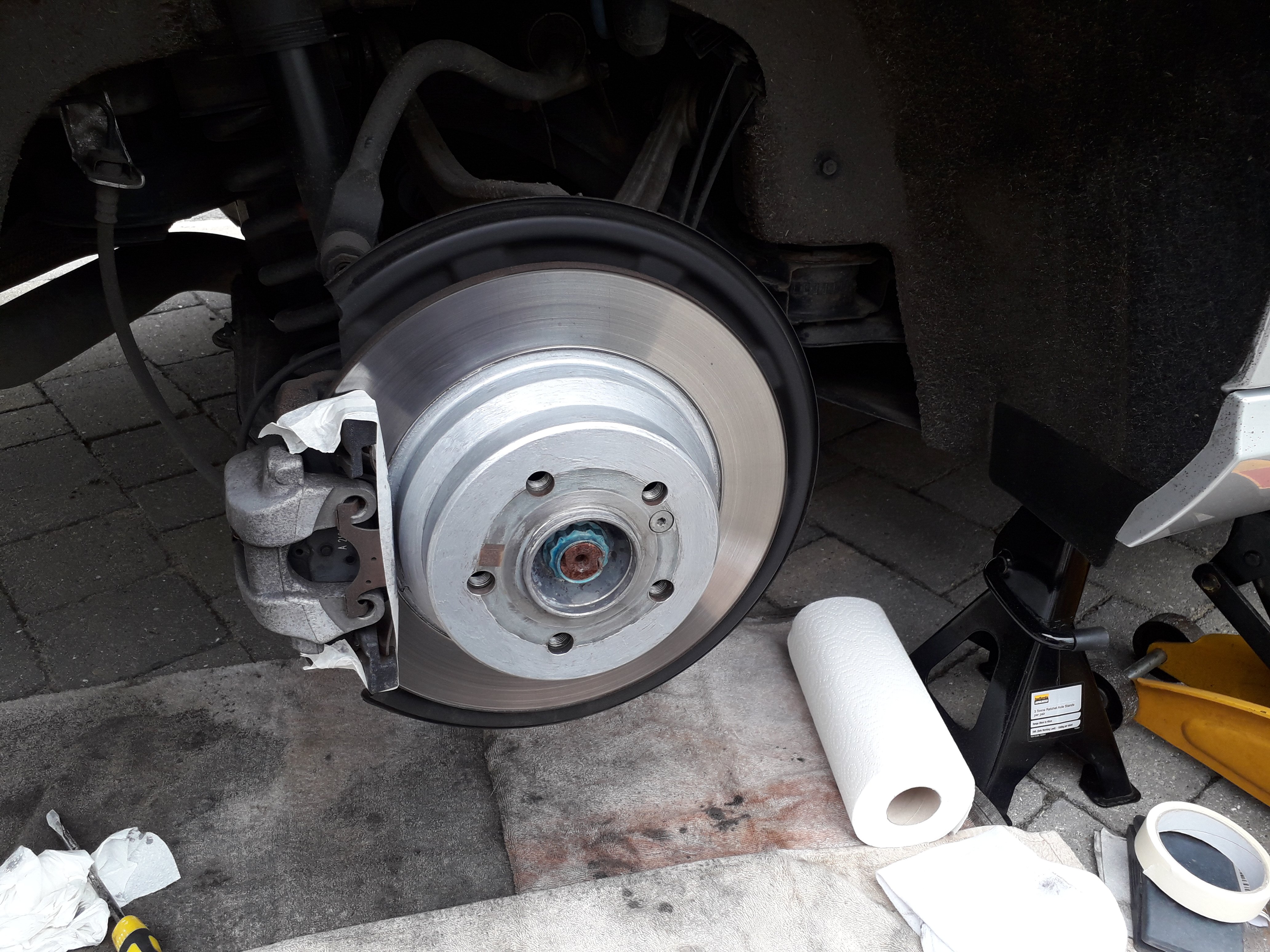

I’m planning on painting my wheel hubs and brake callipers soon and wish to use my axle stands. Anybody know where to stick them? Polite answers only please. 😜

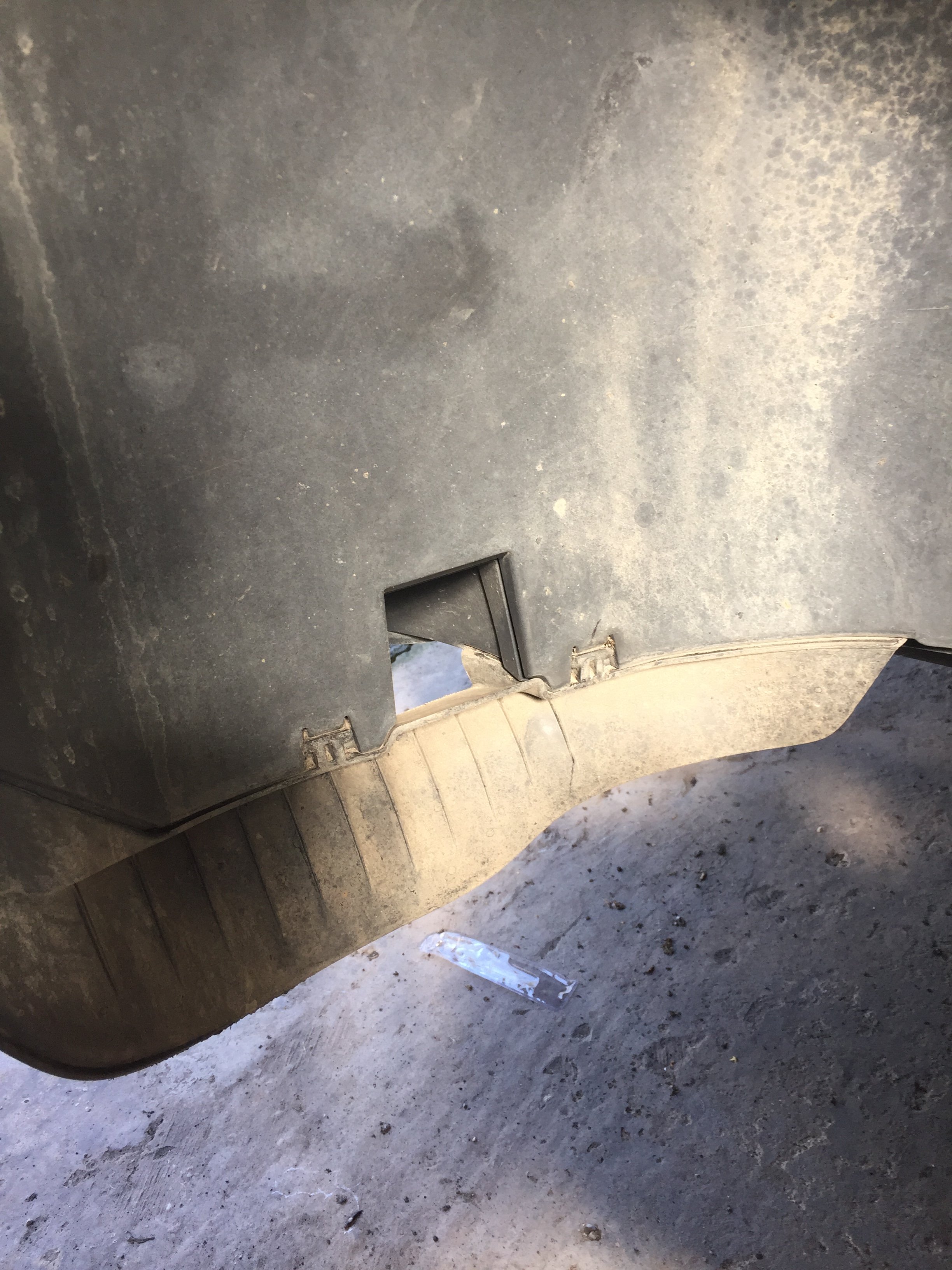

I made a start with the painting after finding the axel stand covers near the rear jacking position.
Looking good!

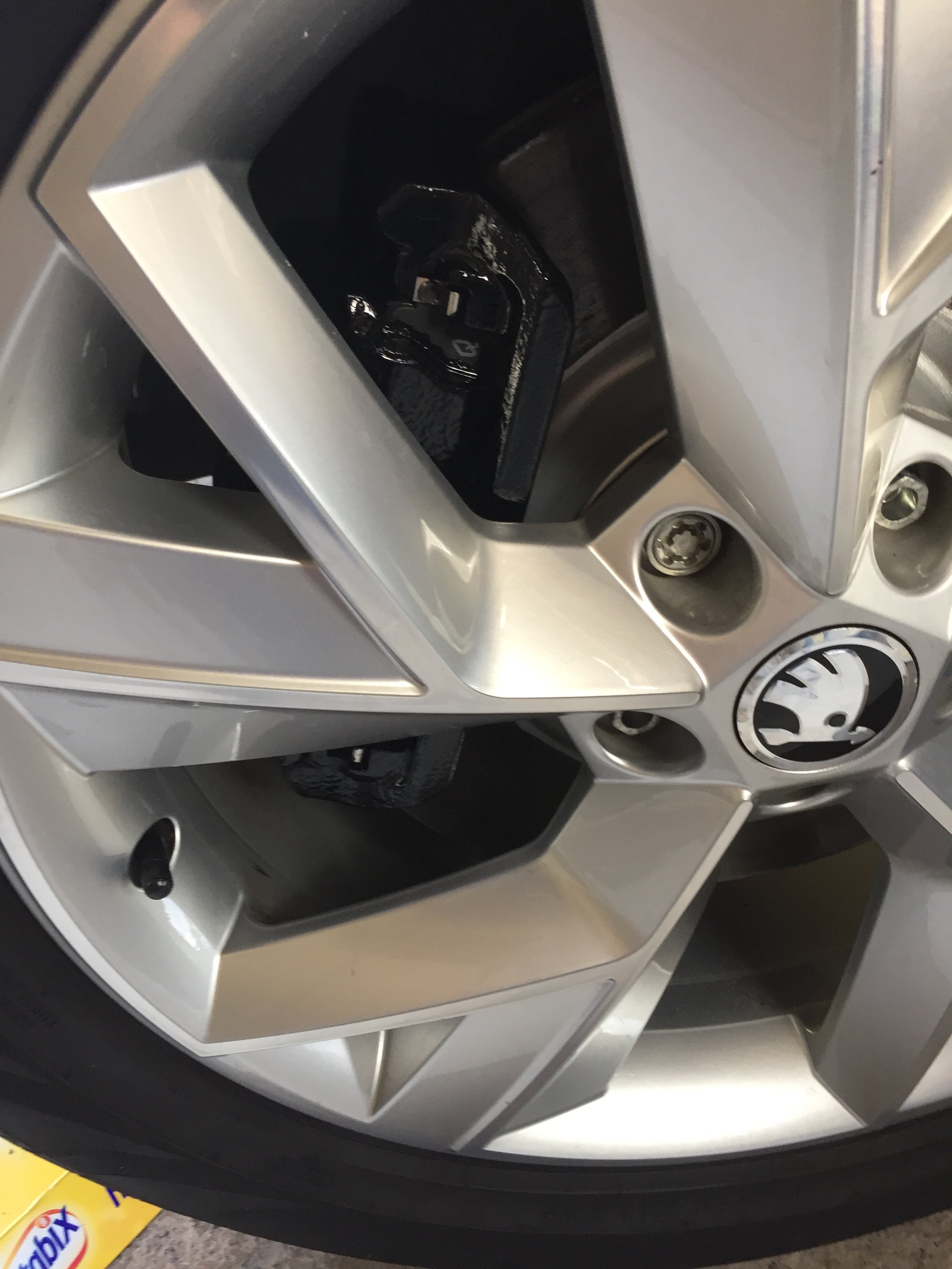

What made you go for black for the calipers instead of the factory silver?

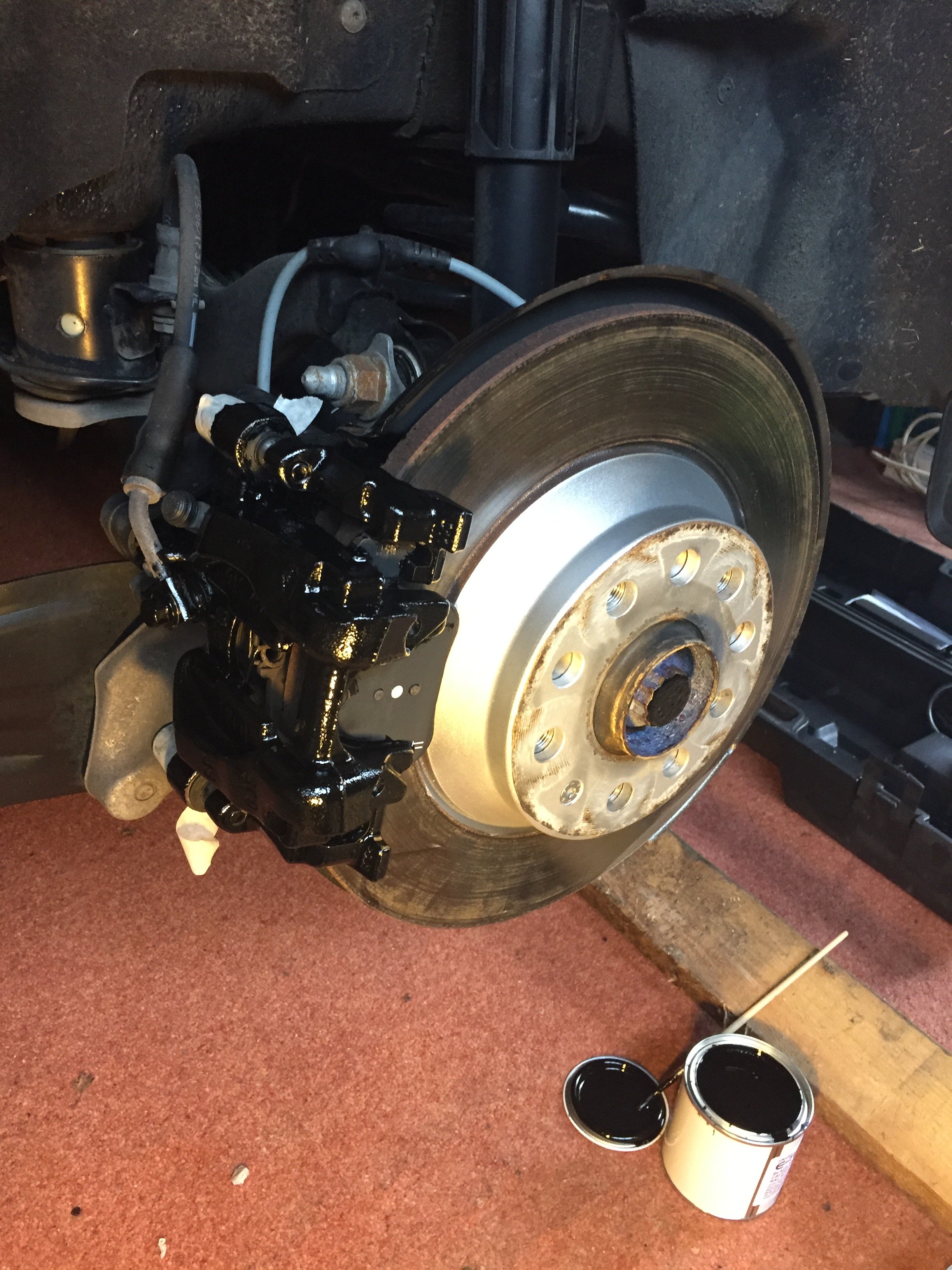

Thanks.
I really chose black just for a change, I painted my last car’s callipers silver and it was always going either black or silver.
I used galvanic silver in a rattle can for the hubs ,but a brush for the callipers.
One down, three to go! 😀

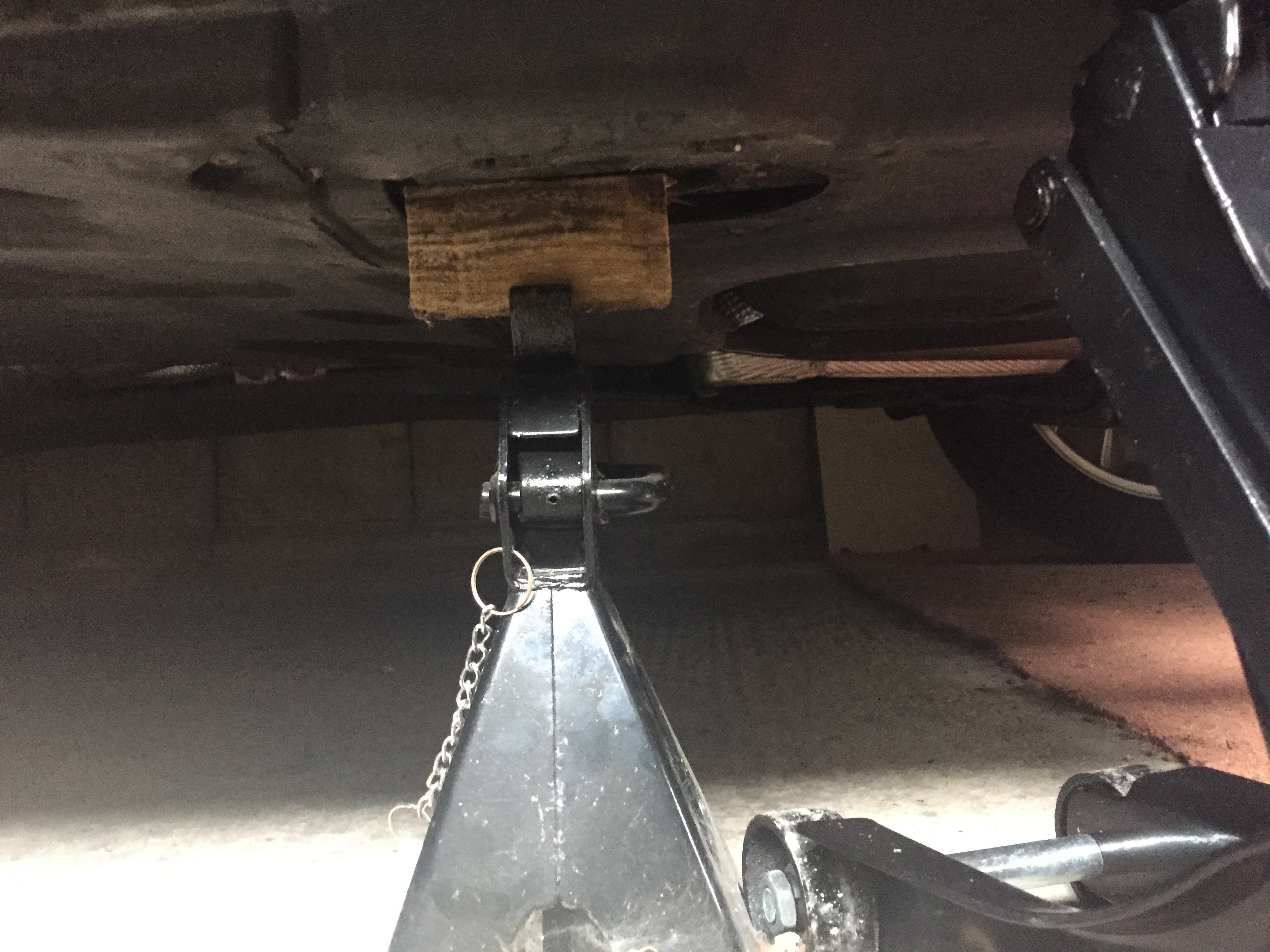

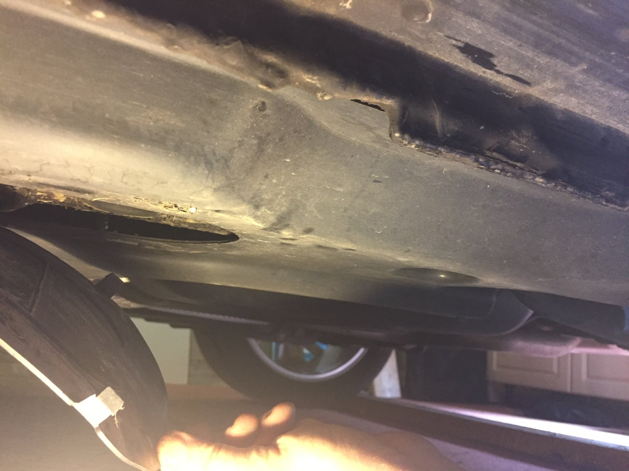

Also good to know about rear points for axel stands I’ve been using sills with a rubber cup and axel stands on suspension cups.
I still don’t feel comfortable with using the actual jacking sill points

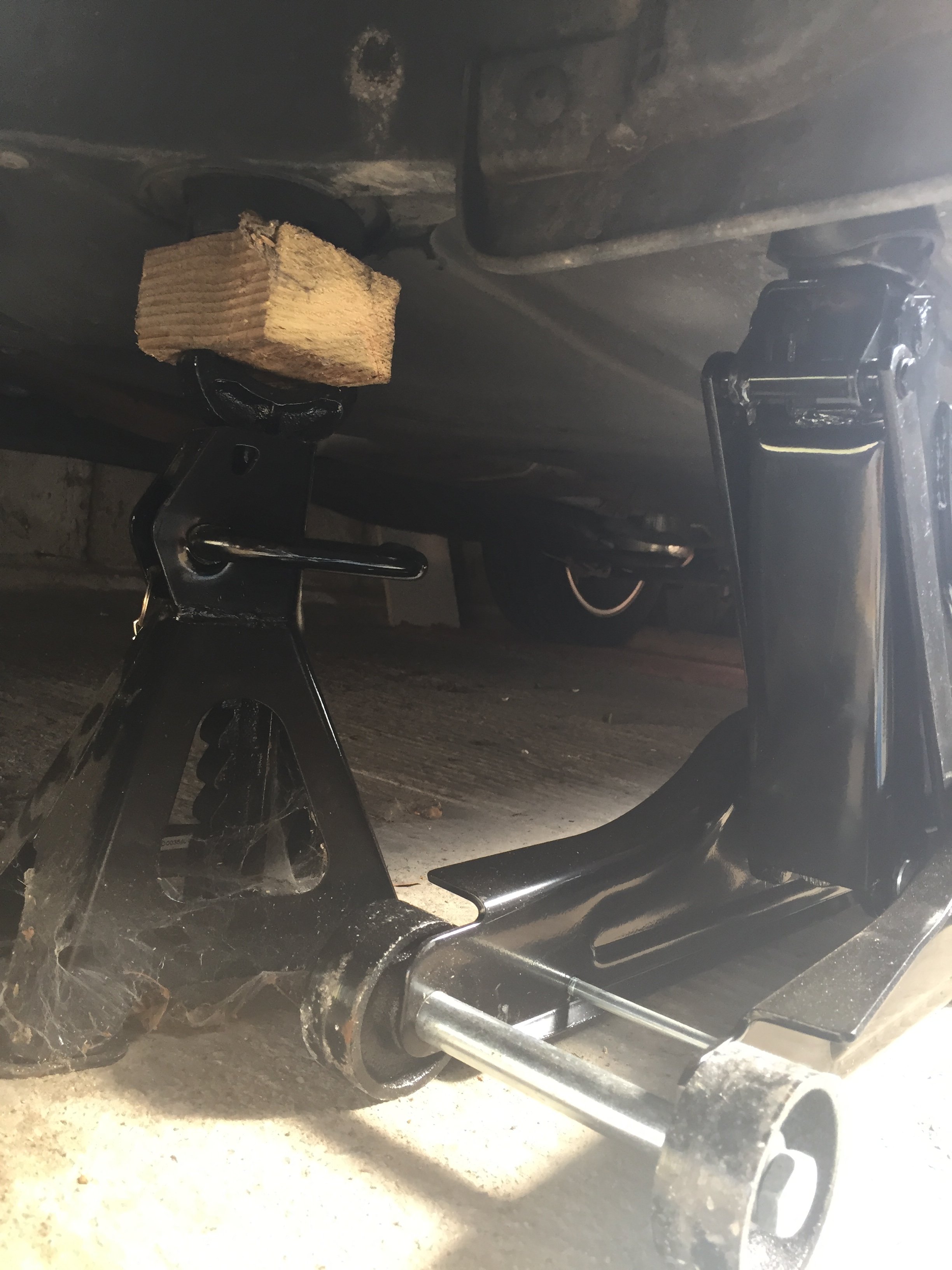

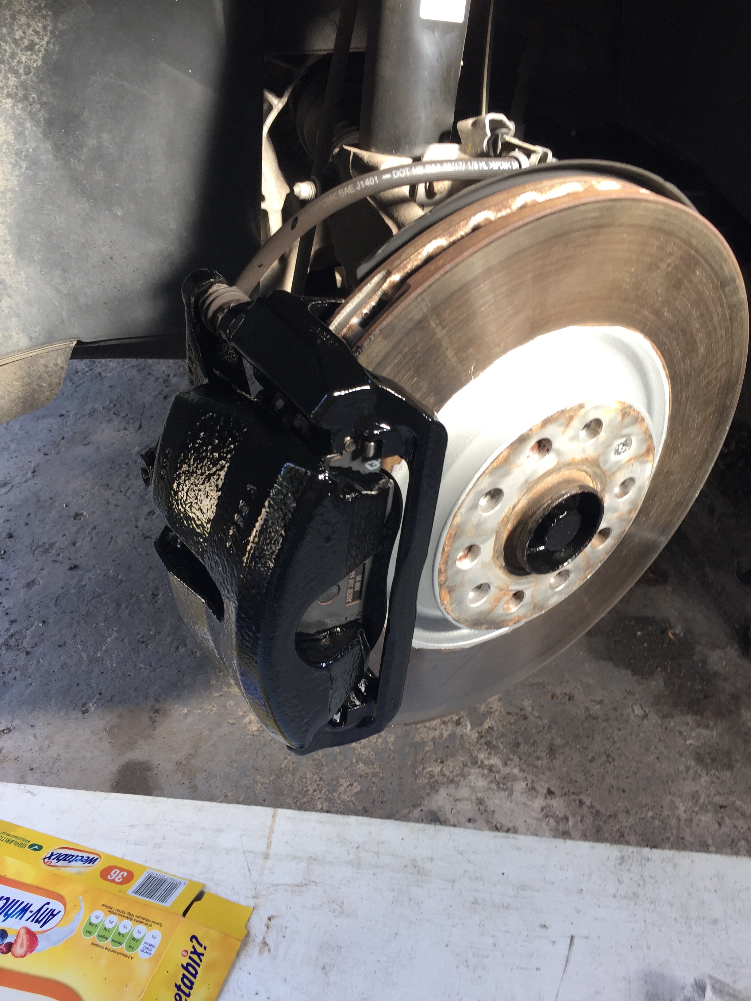

Front end axel stand located and orange bits painted. 😎

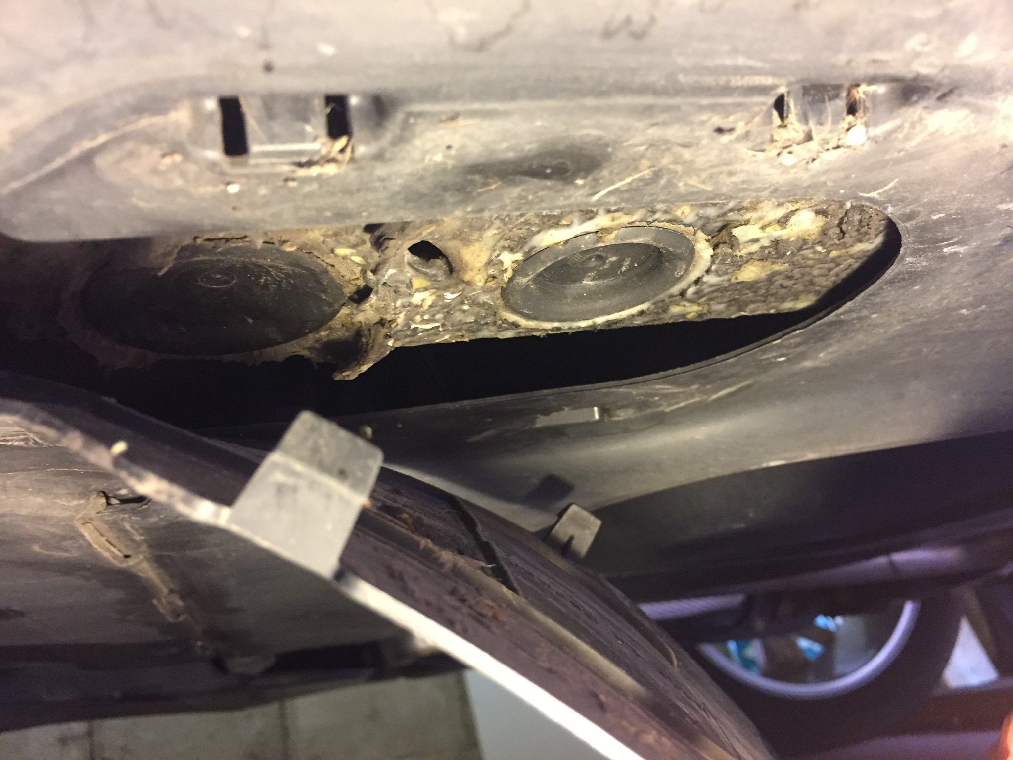

Front brake vent duct!      Who knew? 😜

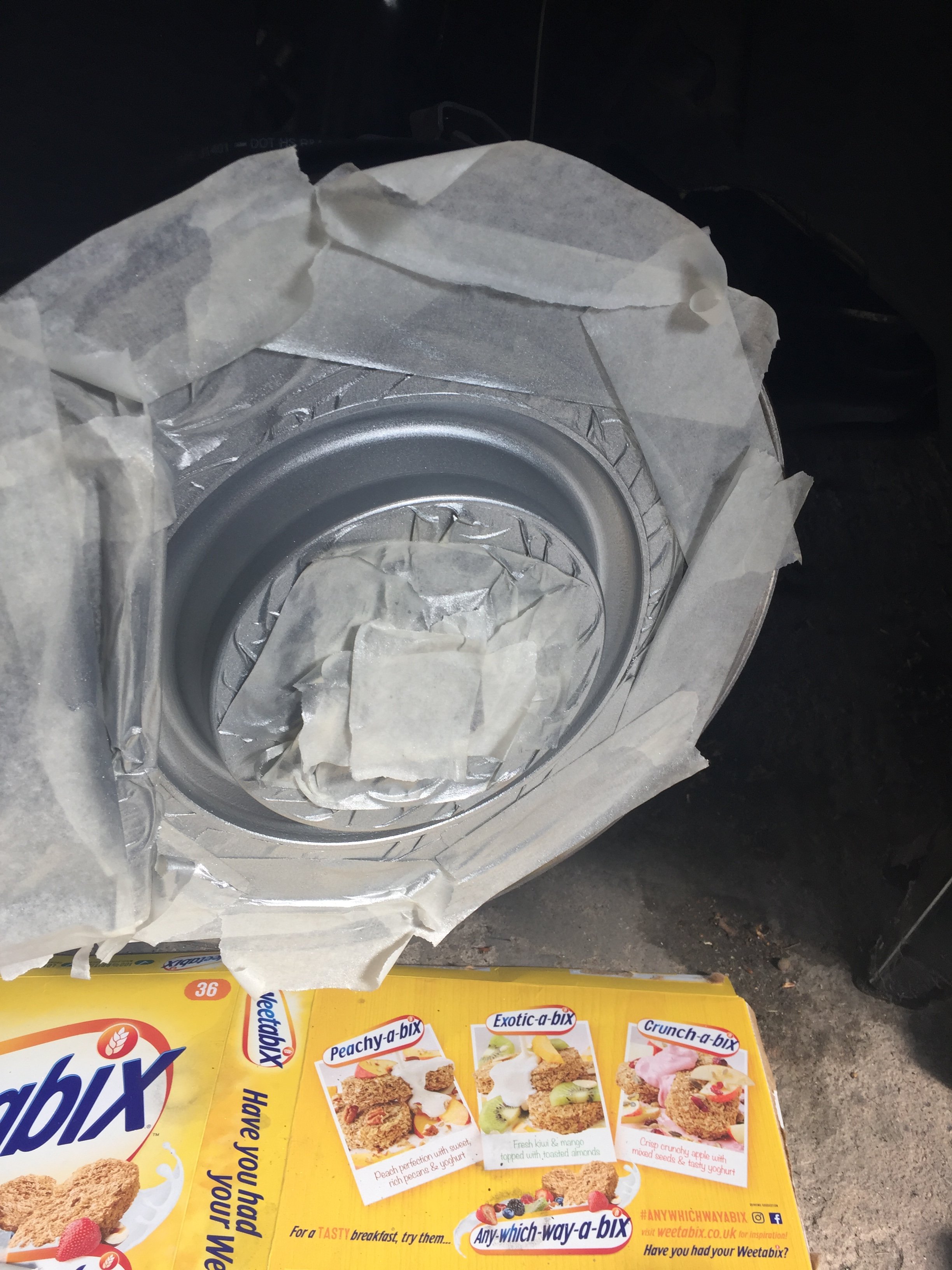

Finding all sorts you , how much to paint them tiny Little callipers on the back really can’t be bothered . I see your masking off properly I would normally just stretch a plastic bag over 😂 too hot in manc today just drank instead
always used subframe cups on front of Vag cars
