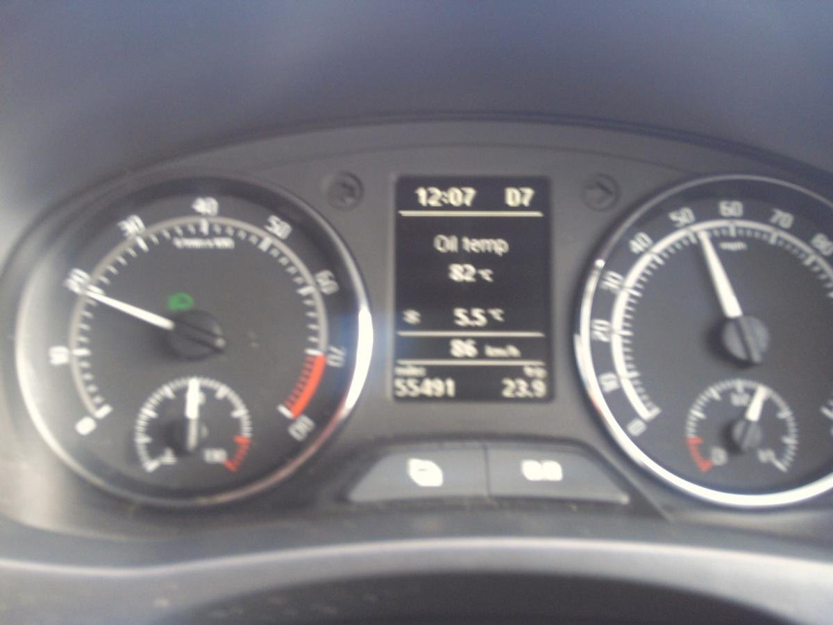

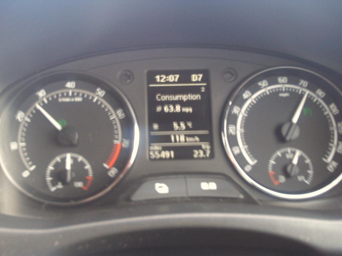

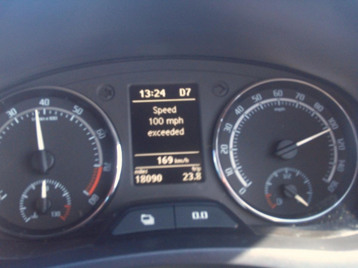

1st and 2nd photos show 2600rpm @ 120 and 118 k/h, 3rd photo shows 86k/h, 2600 x 86/120 = 1841rpm which is shown so exactly same gear. Need a photo of 120k/h @ 2400rpm as when I remapped my TDI the revs were the same @ 70mph whichever map I was running.
