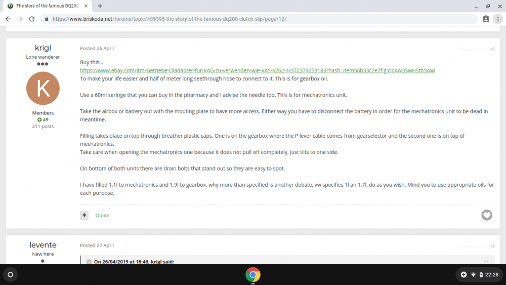

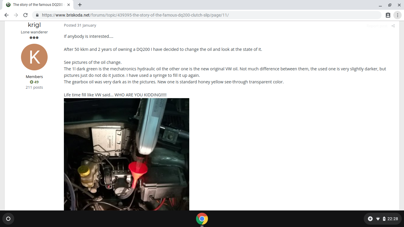

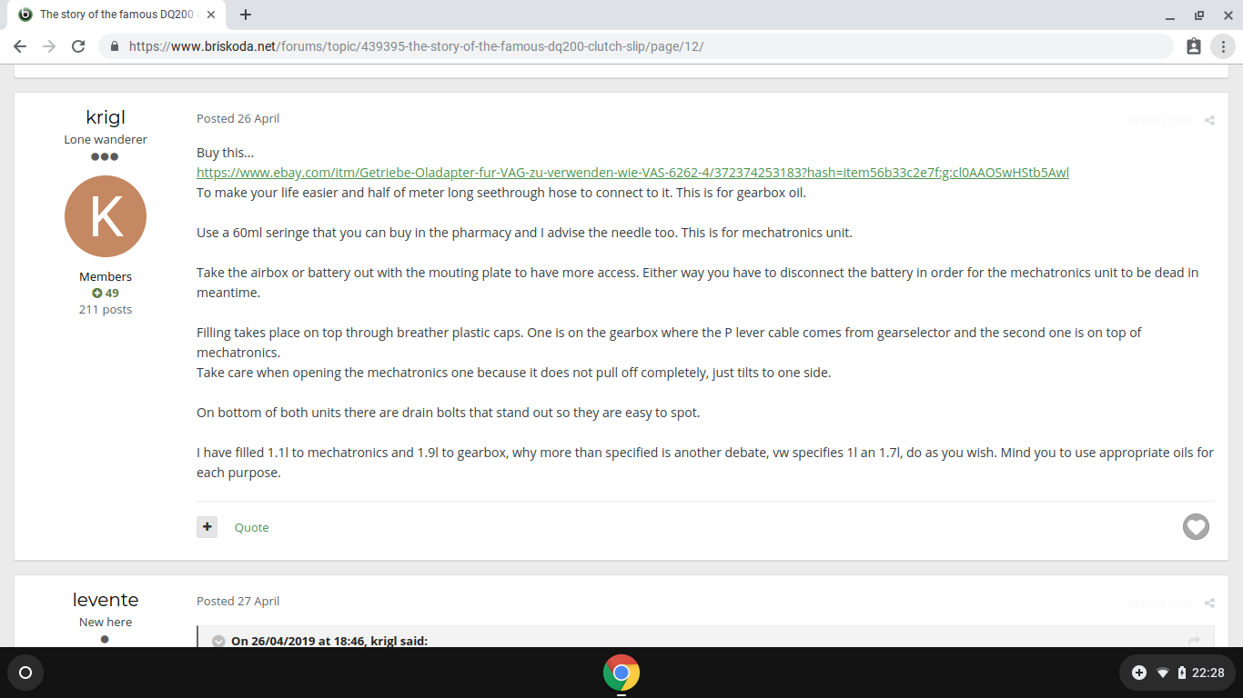

The gear oil and the mechatronic oil are separate on the 7 speed dry box.
So which oil was changed by skoda from sinthetic to mineral,
The oil in the pressurised mechatronic unit.
Got ya, thanks never to old to learn, think I'll check level in gearbox and leave that bit alone
From the 'Famous DQ200 Clutch Slip thread' in the Mk3 fabia section.
