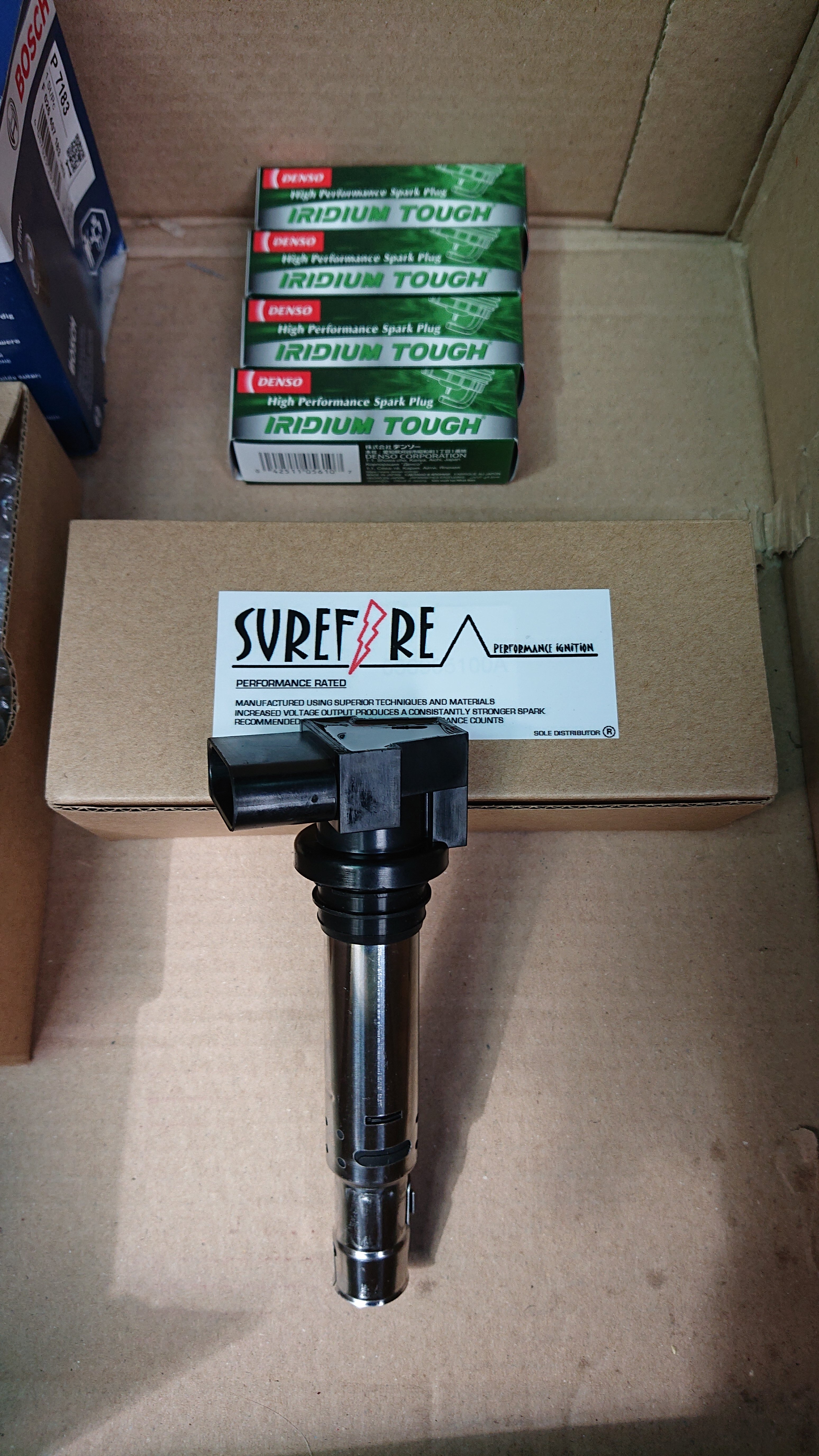

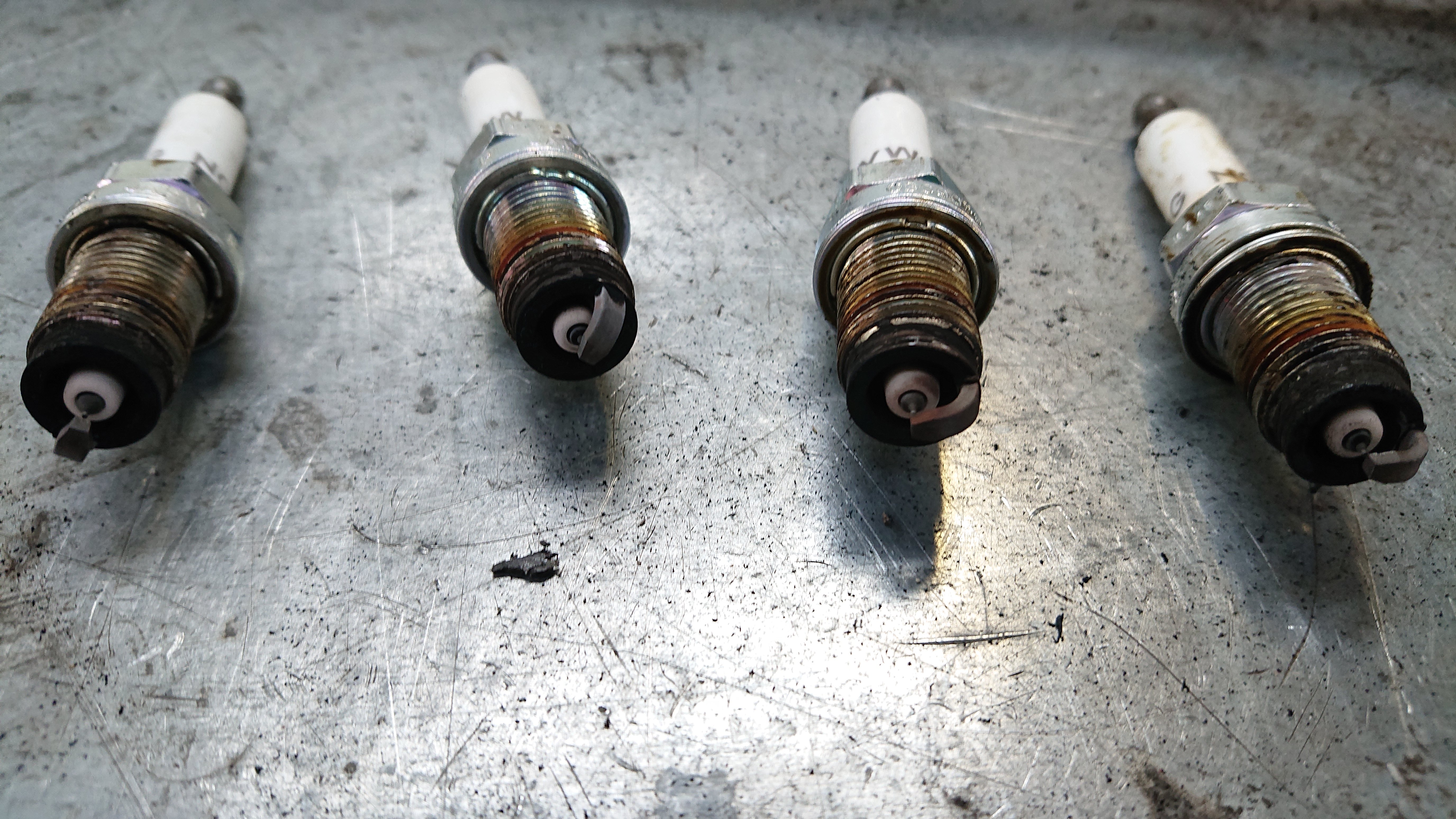

Changing out coils and plugs as I've no idea what was put in by previous owner last few days she's not starting as sharp on about 3 occasions, used no oil done nearly 1000 miles, will take pics of plugs that come out as if done on last service they have covered 7000 miles. And see if these coil pack have extra oomph they say they have, will check the vag ones that come out toomoo
What plugs you planning on putting in it?
Ones in the picture, denso

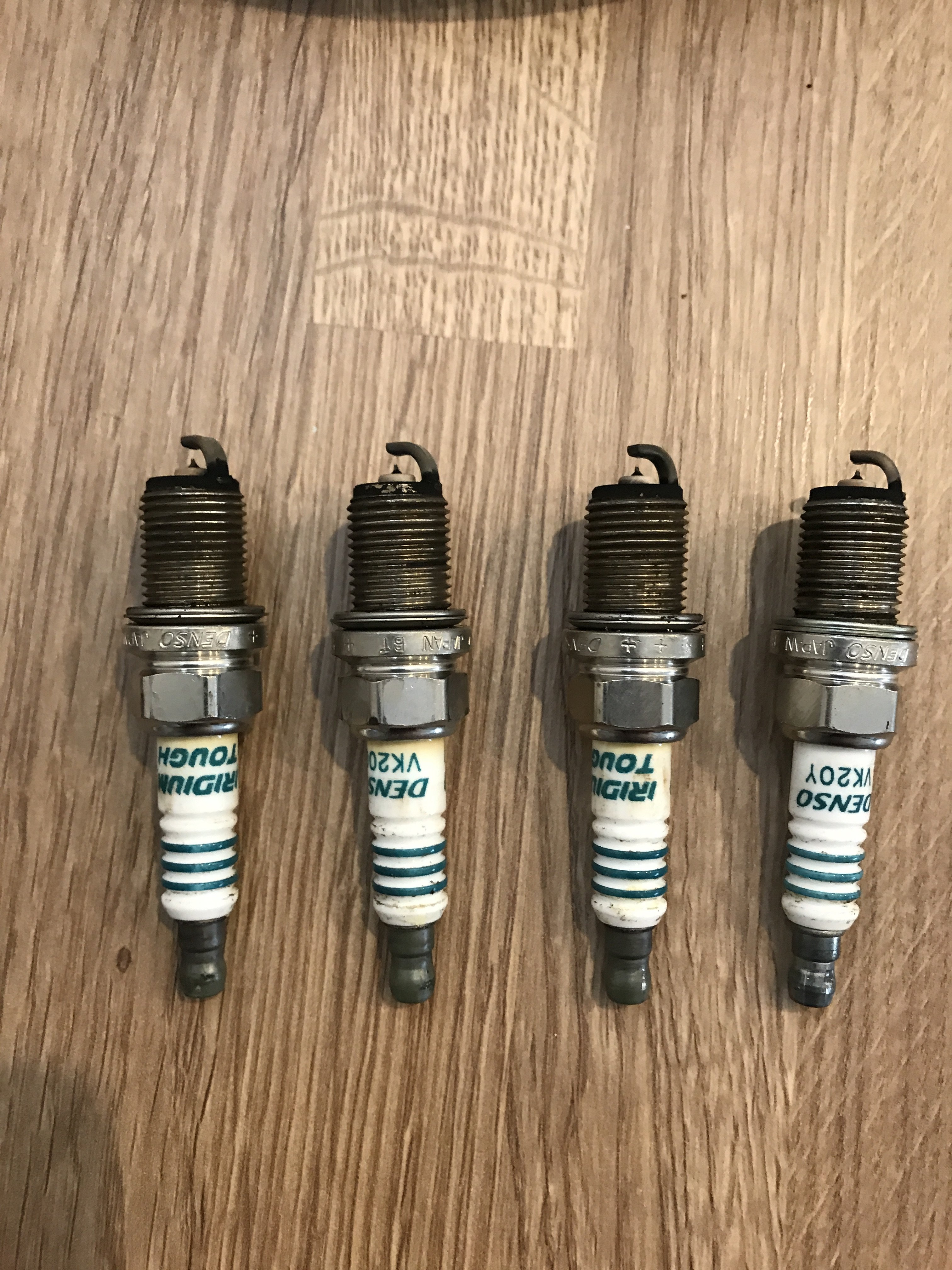

Seen far too many issue's with plugs in my short 2 years owning my Vrs, Would only ever put NGK BR7'S or Denso Vk20's in mine. Ran my denso's for 9k there with only a tiny bit of misfire recorded on idle, Changed the BR7's 2 weeks ago and they've been faultless.

Smooth tickover, and sweet so far see how she is tommorow, plugs were abit **** I took out

My denso’s after 8-9k
