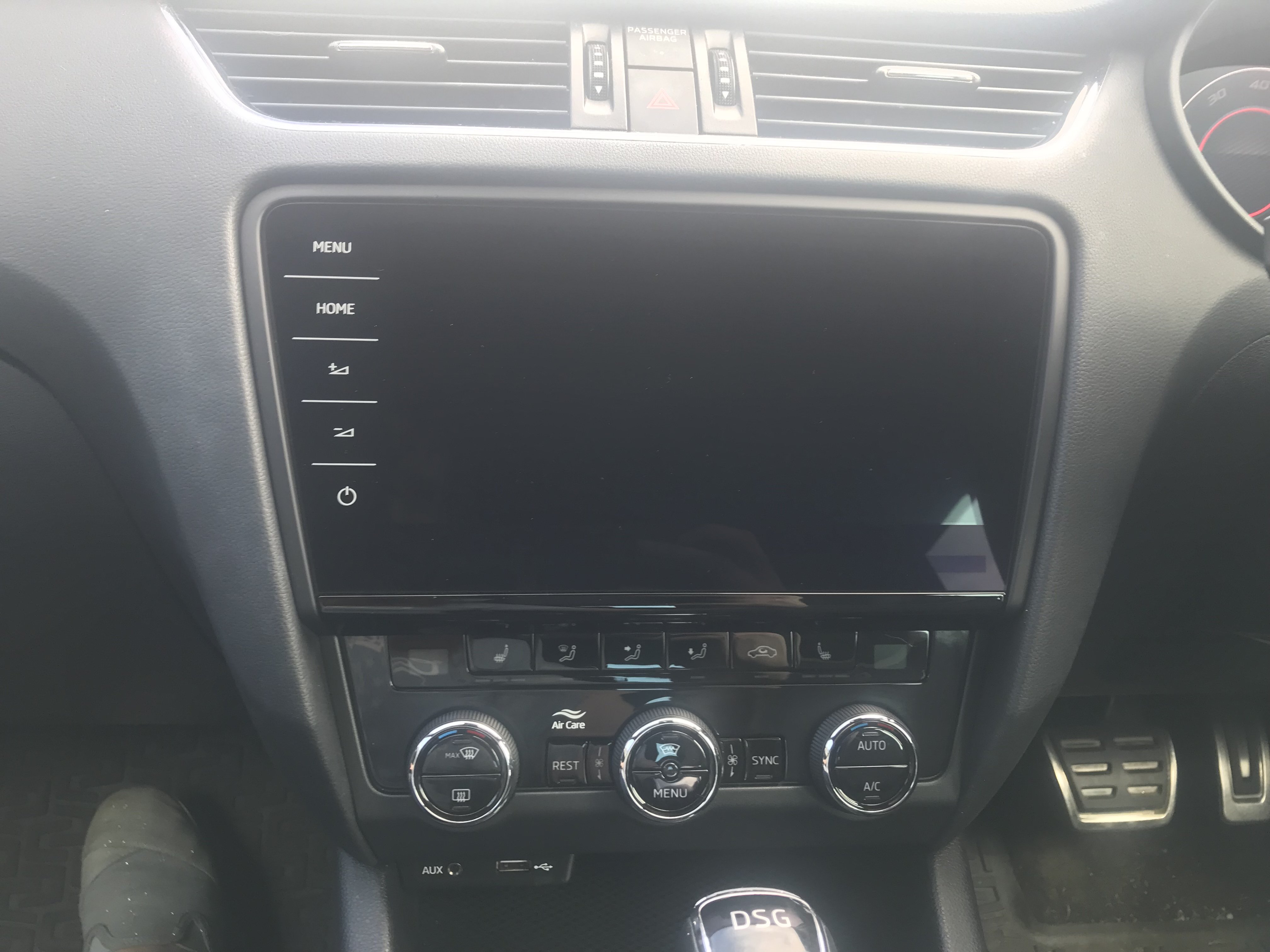

If you check out Sasha Grace 2014 Vrs estate you will see she has installed not only Virtual Fleapit on her dash plus the MiB2 Columbus 9.2" screen. Anything is possible given a large enough budget.:nod:

Even the highest spec MIB2.5 Columbus is doable for under €2000. In a nutshell you will need a radio unit, a screen and a USB. The radio you pick will depend on which size screen you want. You will need to have Component Protection removed from the radio unit and then coding done outside the dealer network to patch the radio and activate the features. Pab567 from this forum is the man I have used for all my VAG radio work and I recommend him to everyone.

Thank you for your reply. The thing I am most worried about is: How smooth is the integration with the rest of the car? The control buttons on the steering wheel, the small display beside the spedometer (whatever it is called).,
It’s perfect, exactly as per factory. It is a factory radio and behaves as such.
