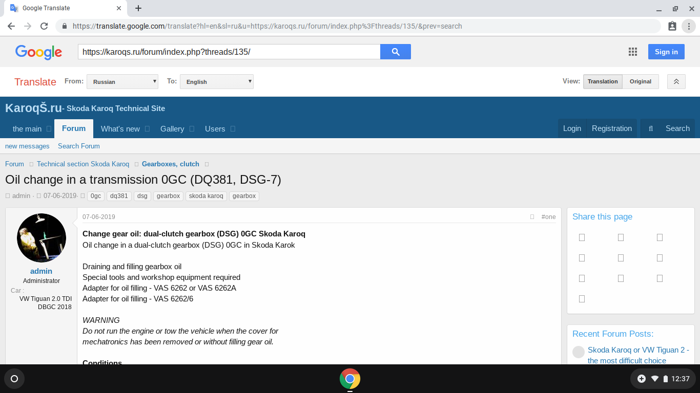

What does the adapter look like?
26 minutes ago, UrbanPanzer said:
Thats for the six speed gearbox that’s filled through the drain bung.
As is the VW page.

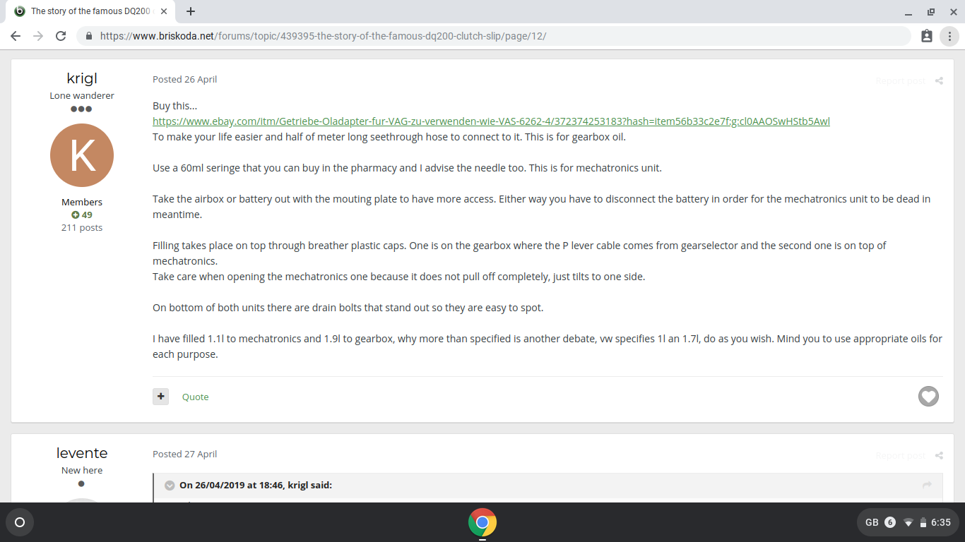

Ok, that clears that up, so need the top fill adapter 6262/4 then to fill the box itself. not thought about the mechatronics unit "yet"...
