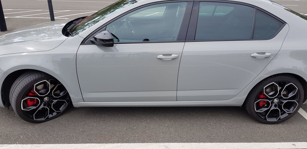

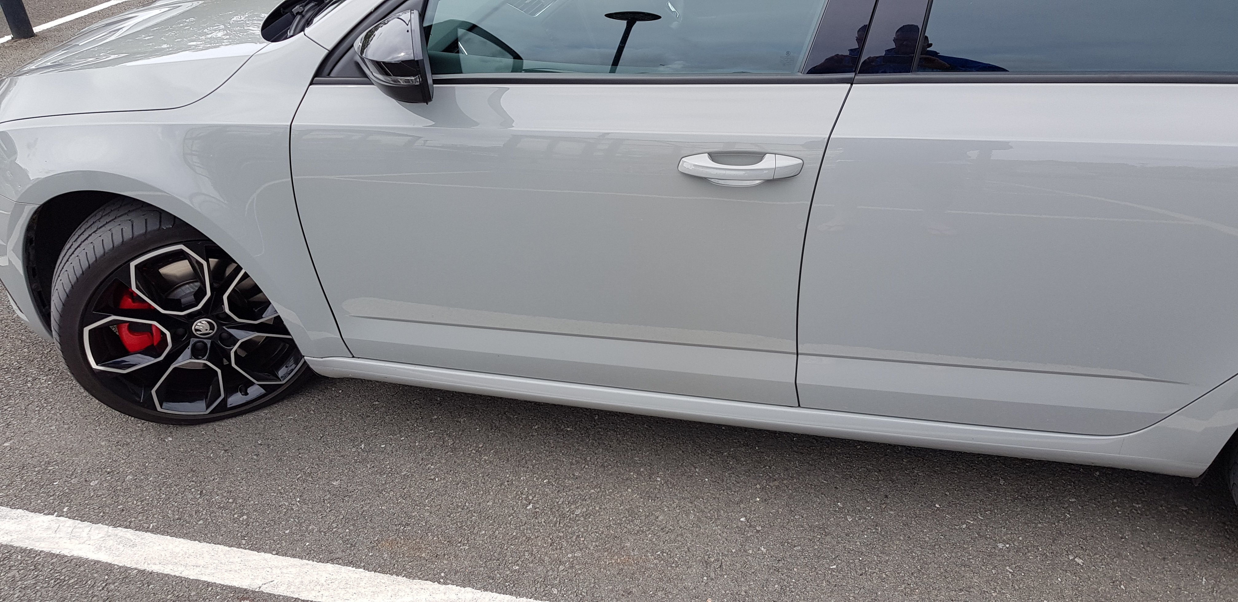

I have a 2017 Octavia VRS in Meteor Gray which I bought a year ago.
Ive recently noticed that part of the paint on the front passenger door looks a shade or too darker than the rest of the car. Im 99.9% sure this wasn't the case when I bought it as surely would have noticed it. Since Ive had the car it hasn't had any work done on it i.e panel repairs.
Any ideas what has caused this or is it likely that it was like this when ilI bought it but didnt notice?
Appreciate any input
Photos attached

Are you referring to the part directly under the door handle?
Yes.

Do you use snowfoam or a degreaser/all-purpose-cleaner as a prewash or for removing stubborn grime?
I ask because I've noticed that on my MG Superb, the area of the doors under the front handles (normally it's my drivers side) seem to be susceptible to a little bit of discolouration from what I think is where snowfoam has been driven into the hinge on the handle and caused some grease or similar to leach out over the coming days, causing some darker looking staining on the door.
Just a thought...
Edited by penguin17
If it is the above that's causing it,  you could try something like this;
AG Fall Out Remover
AG Fall Out Remover
It usually comes straight off on mine, during the next wash. It’s like a discoloured tide mark, rather than a full on stain.
Thanks both. I have used snow foam in the past but not regularly so don't think its that.
Took it back to Lookers Guildford and they have agreed there is discolouration and that there are no signs of damage/repair. Warranty officer is going to look at it tomorrow, take paint depth readings and then discuss with Volkswagen. Fingers crossed!
