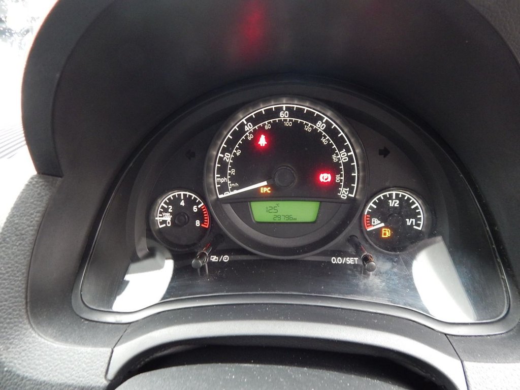

Hi,
I have a Skoda Citigo 2013. The instrument cluster looks like this: https://f7432d8eadcf865aa9d9-9c672a3a4ecaaacdf2fee3b3e6fd2716.ssl.cf3.rackcdn.com/C1845/U50040/IMG_5952-large.jpg

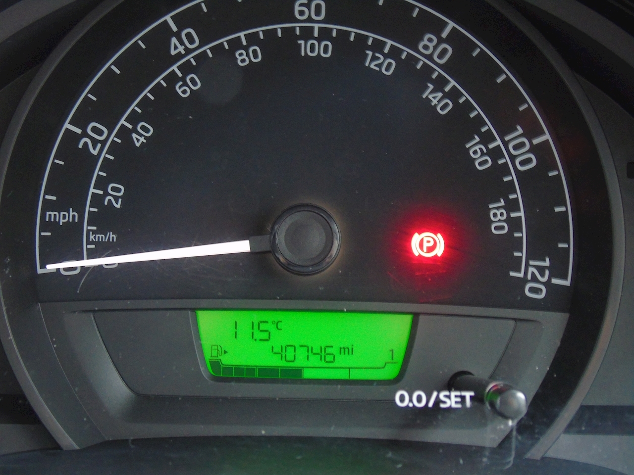

I have just a speedometer, odometer, trip counter, temperature monitor and fuel gauge. Do you think I could replace the instrument cluster with something like this: https://images.clickdealer.co.uk/vehicles/2122/2122794/large1/36304244.jpg ?
I would look on eBay for a 2013 Skoda Citigo Manual Transmission instrument cluster. Could I buy it and then replace the current one with the cluster I just bought?
Nick
You could be would need to get the immobiliser programmed to the keys and the engine ECU and the mileage corrected.
