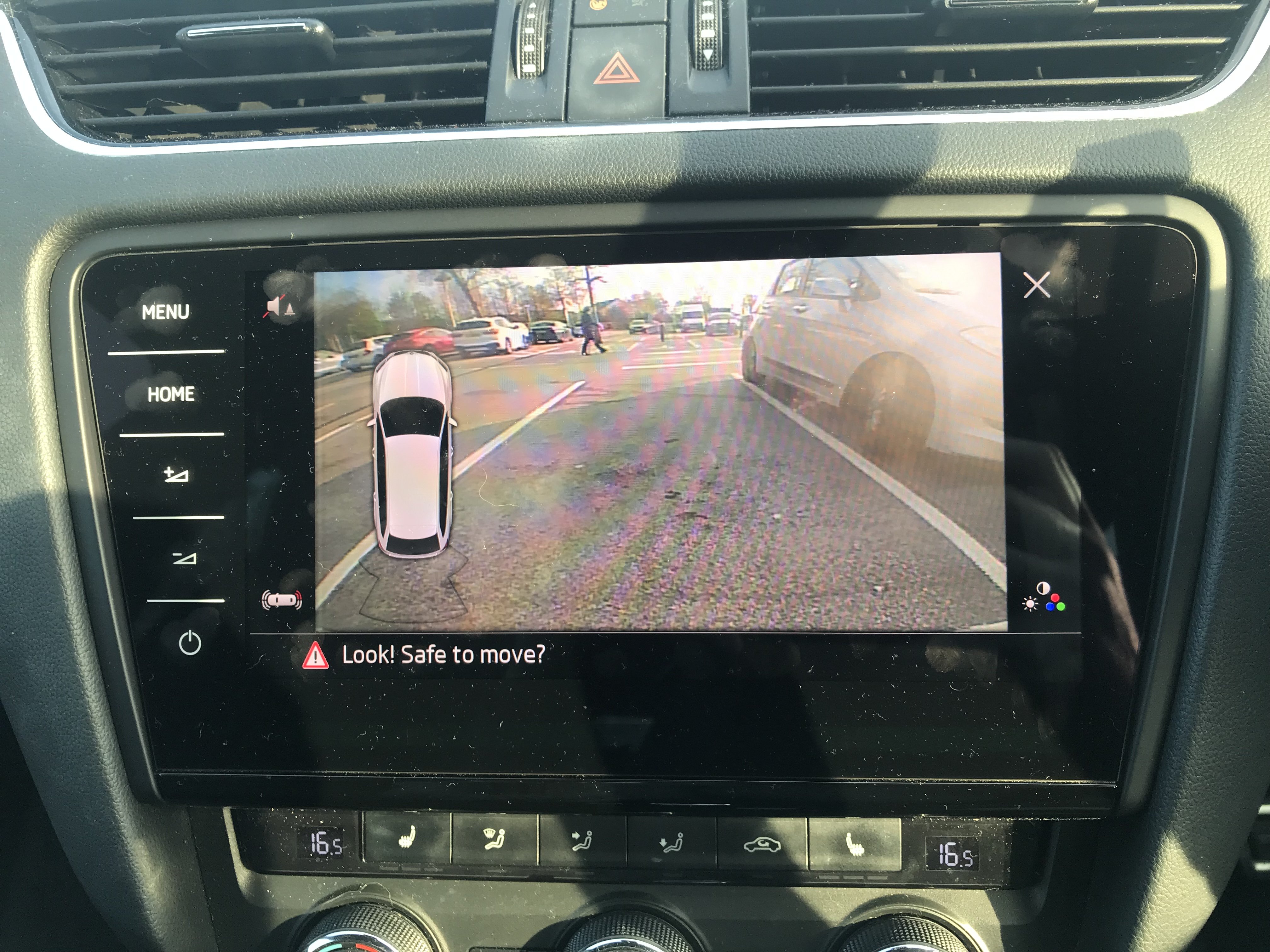

The car’s radio will deal with that display when you put it in the reverse it’ll have this screen.
You can toggle between that and the park sensor screen. You will need to run the coding change 5F Infotainment Byte 19 Bit 4 Enable reverse_camera_low
