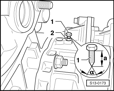

Just out of interest and probably not relevant to this engine, but on the 1.4 mpi 8 valve there is a threaded hole normally used to hold the engine speed sensor that you can insert a bolt that has been ground to a point to lock the flywheel.

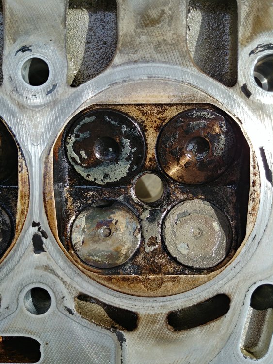

Thank you all very much for all your suggestions, they are very much appreciated. We managed to remove the bolt by locking the pulley with a special tool and gargantuan force to undo the bolt. We continued to dismantle the engine and remove the head. The head gasket appeared to be OK, however, one exhaust valve was burned and the other exhaust valves were more or less in bad condition. The inlet valves appeared OK.
What could be the cause for the damaged valve? See attachment.20190824_125313_HDR.thumb.jpg.45f5f800959e87bc854f2e4c06e5f244.jpg
Localised overheating causes the initial damage, you've lost a lump of exhaust valve, no wonder you had compression problems.
Looking at your picture, the burnt valve was coked. That caused the localised heating, and hence the dropped valve as pictured.
I'd suggest a full decoke, replace any burnt valves, and rebuild.
I’d check the play in value guides too.
