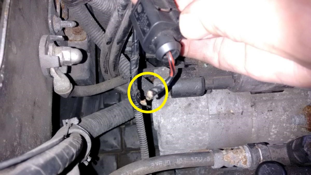

Just wanting some help understanding a recent problem with my vrs, got in it one day and turned the key, all lights come on, wait a while, turn key... nothing any ideas??

If the starter motor doesn't turn check the small wire on the starter motor solenoid. They can snap off.

The only time my 2007 Fabia vRS has ever failed to start was early this year when that wire broke where it enters the connector.  All the electrics were fine but the starter was dead.  An RAC patrol man did a temporary fix in the cold, dark and rain - a difficult job without removing the battery.  I have since had a replacement loom fitted.
