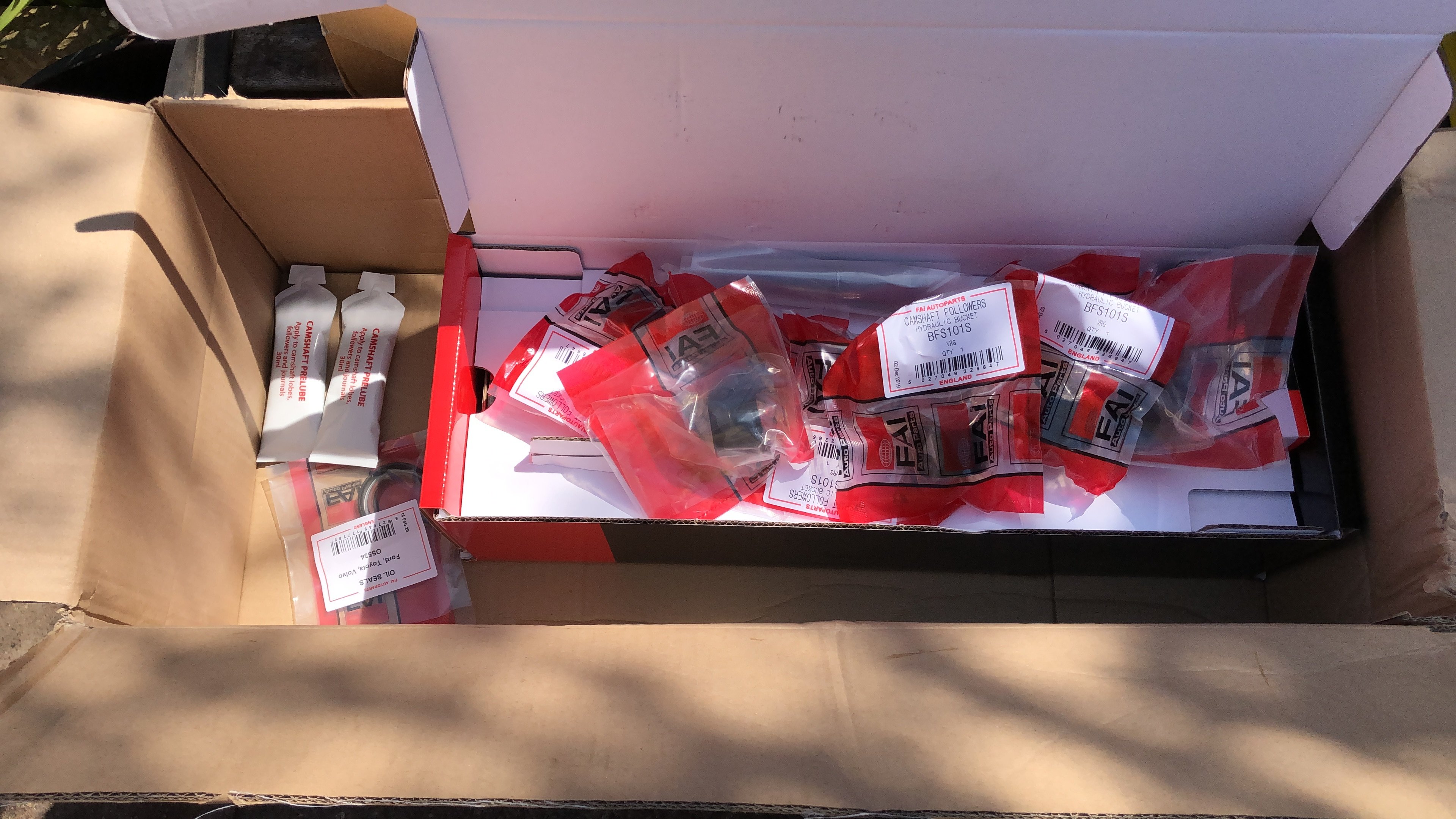

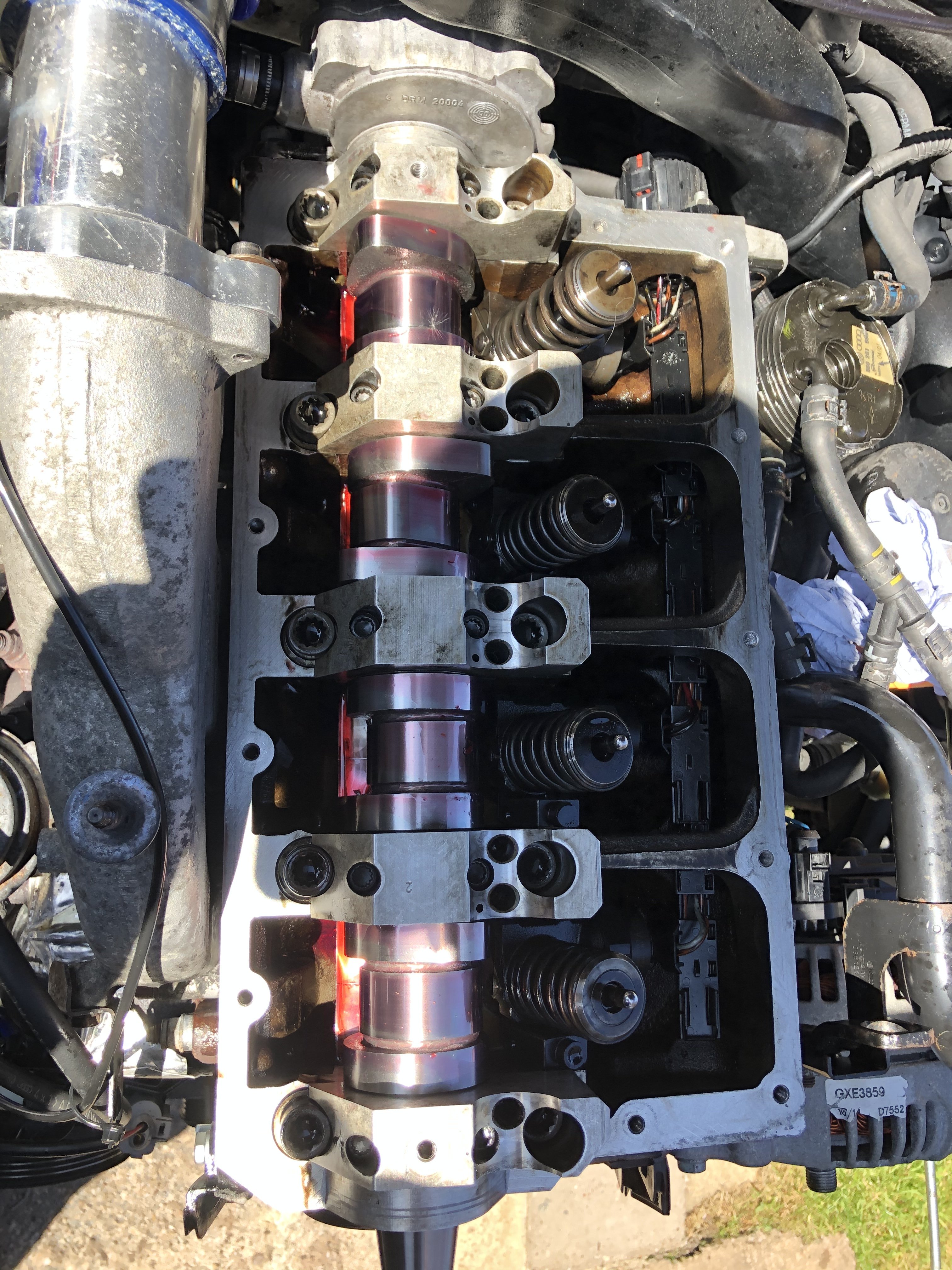

I’ve recently done a camshaft on a 1.9tdi, I guess if your going to keep the car for a very long time then find the best you can with INA lifters and billet cam as the list above.
I however fitted a FIA kit for £150 off eBay, the car wasn’t in for the camshaft but I found it upon trying to remove the camshaft seal, so it was an unexpected cost to the owner.
the kit came with everything needed and it’s now running much better, no need to change injector rocker bolts, they have been measured to not stretch much from the oem torque specs, if they have been off a few times then maybe consider it, but the cam cap bolts will need replacing and are in the kit.
I can’t comment on longevity because it’s the first kit I’ve fitted and only a couple of weeks ago, it does come with a 12 month warranty though so I’m hoping that it should at least last 50k with standard servicing.
