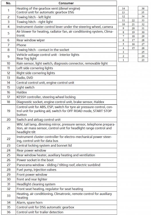

Hi, Just realised that when I lock the doors both driver side doors remain open? Checked the fuses and fuse no 23 which according to the manual is central locking is missing?? Is there an obvious reason why this has been removed?
further to my original post, wife is adamant that everything was working (despite no fuse?!). Button centre console doesnt work, not sure if it ever did. I can lock the drivers door with the key but rear passenger door remains open. Should the red light on the drivers door flash when the car is locked? It's a 2012 Yeti Elegance.
The LED will flash, but only when the car has correctly locked.
Replace the missing fuse and try it.

Any chance the fuseholder is mirrored or rotated relative to the diagram in the manual? They are often lazy about supplying appropriate info for RHD cars where the same parts are sometimes in different orientations.
I thought of that but there are missing fuses no matter the orientation.

15A I think, should be the in position 23.

Doesn't really matter just to see if it works, fit a 20 amp in there and see what happens.

TO me that suggests that it keeps blowing because no-one has fixed the actual fault. Beyond that, they're only golden not crystal...
Fuses and fuse locations for right hand drive Yeti.
This is likely to be the notorious door loom issue. The wires break in the loop, due to repeated flexing, between the door and frame causing all sorts of issues with locking, windows etc. It is quite likely they could also give a short and blow the fuse?
The loop was extended in later cars to try and solve the issue, but I have seen mention of even the improved version failing. This has affected a large number of skoda and vw cars.
It costs about £110 for the loom plus fitting cost per door, if you can't do it yourself.
