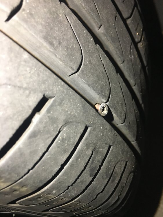

Hi, just noticed today that I have a screw seemingly lodged into the valley of my tyre tread.  It’s a Pirelli scorpion verde...do I ignore it, take it to a repair shop, or unscrew it hoping it will seal?
the vehicle is a kodiaq...
The longer you leave it, the bigger it will make the hole until it comes out. It's repairable so just get it done but don't try to remove it yourself as it will deflate.

Yeah needs plugged. Take it to a tyre place.
nice and easy fix
I can plug that quicker than the air would leak out including reaming out the hole with a battery drill & rotary rasp bit.

Plug is inserted from inside (so have to take tyre off rim) and had a flattish head so it cannot push out through the hole (roughly shape of a mushroom, but much smaller)
But on a self seal tyre there is a layer of goo inside so don't have a dry flat surface to bond it onto, unless a small area can be cleaned up
take it to a tyre place they will remove tyre, remove screw and plug from the inside out. Similar idea to fixing a bicycle tyre as a child
will cost £5-10

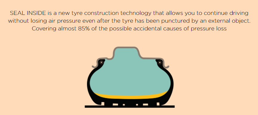

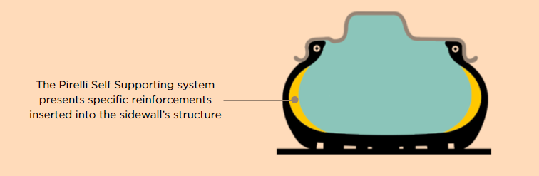

These are run flat tyres though. They haven't just had some gunk squirted in them. The design of a tyre incorporates a self sealing layer inside the tyre as part of its construction so I am not sure if a repair would be suitable.
The plugs I am speaking of are fitted from the outside, on a front axle or with enough wheelarch space on the rear the wheel can remain on the vehicle, no jacking up required.
They are a roadside repair kit, a small pouch with hand tools, the plugs and often some vulcanising compound, were banned for years in the UK but thanks to the EU no longer, the UK describe them as a temporary emergency repair, here in Europe within defined parameters they are and have always been a permanent repair, ideal for a puncture like the one shown.
It is not agood idea to go into a tyre fitting shop and tell them how to do the repair, they should know and should propose the relevant repair, I would feel more secure with an internal mushroom plug repair, with a plug I keep a close eye on it and the tyre pressure for a good while.

I've used those before when touring and the results have been mixed. Tyre off, inside prepared with plug patch repair will safely last the life of the tyre and is only around £15

Yes it’s a self sealing tyre
